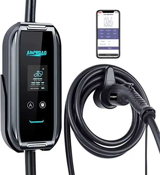

Closure on this problem - the EVSE plug was the culprit. I have to say - the customer support was fantastic and everything you'd hope for when having a problem with a year-old product.
The supplier -- AmpRoad (sold by 4AutoLife Canada ) responded with a human within minutes of my report and started the preocess of product return and replacement, A few days of shipping later I had a new EVSE. The plug now doesn't seem to change temprature at all (at least to the touch) while charging at 40 amps.
FWIW, I'll recommend here as I've done elsewhere - the Amproad P9 is a great replacement for failing Ford Mobile chargers. The charge rate is adjustable, has limited wifi capability, is CE attested (not UL certified though), has a substantial cord, comes with a cable and cord nozzle hanger. It is a great value at the price.

2 years later and another update on this product - in case anyone bought one on my recommendation:
The replacement one sent by customer service is now failing. The nozzle is overheating and stops the charge process even when dialed down to 32 amp charge in my 45 Deg F. garage.
This product is no longer for sale, and the company seems to be gone. But do check your nozzle for overheating. Mine was up to 120 degrees after 1 hour of charging.
