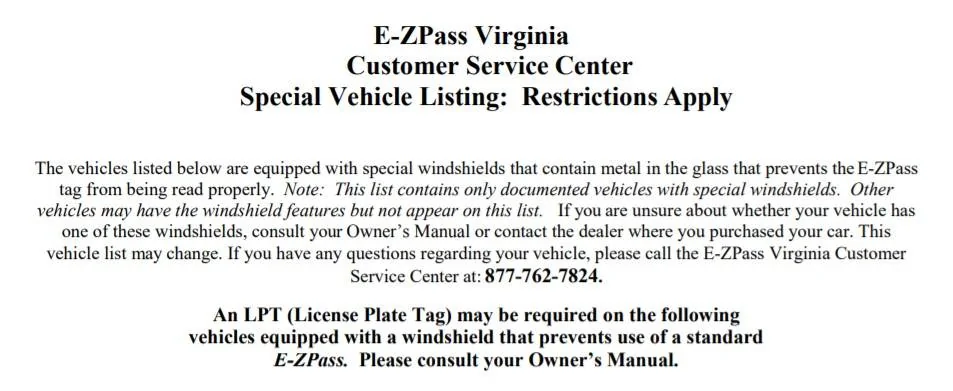

This is what the website says about cars with similar windshields.
Ford Mustang Mach-E EZ-Pass transponder interference? EZ Pass Info

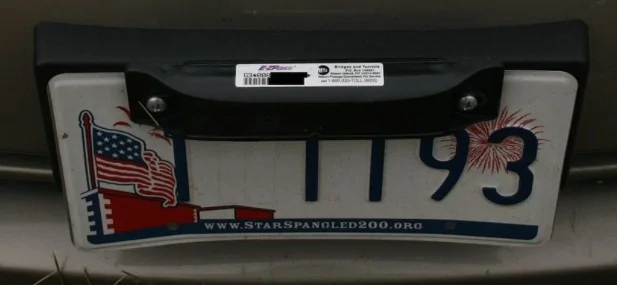

I called them. You just have to request this hideousness below and they'll mail it to you. ICK!
Ford Mustang Mach-E EZ-Pass transponder interference? EZ Transponder

Can this device go on the back of the car for cars without front license plates?
That big, bulky thing is definitely going to affect my range! ?

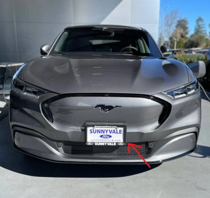

What about mounting it where some of us were thinking about placing the other tag mount? Attaching it using the double sided tape behind where it says "sunnyvale" in the picture to keep it out of site.
Ford Mustang Mach-E EZ-Pass transponder interference? EZ Pass Placement
