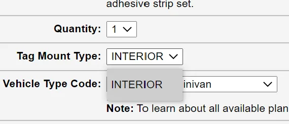

no such luck on the NY site - only type in the drop-down is "INTERIOR" :(

Just looked at NJ as well. You need to request exterior tags through customer service. The page says they may request additional information. Given that Ford is silent on the issue, you may be stuck in limbo if they need Manufacturer info to prove you need it.
