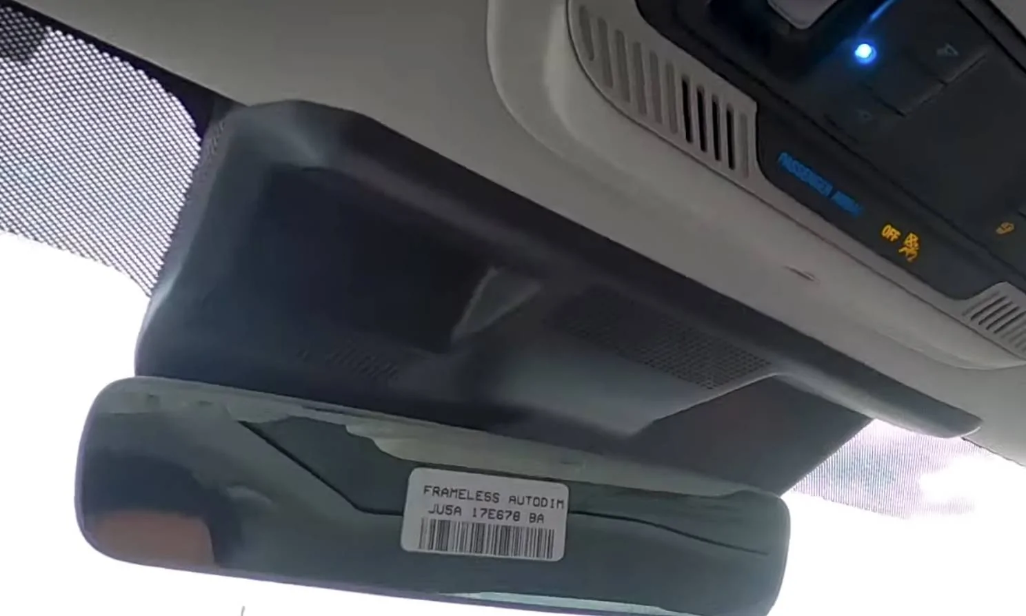

I tested my SunPass this morning, in the above pictured location , and it worked. In the center behind the rear view mirror, it did not work. Hope this helps. By the way, for our storm plagued friends the blue is a clear view of the sky in Florida.

Have your tolls shown up yet? Mine just did. So, I can confirm that the new series (smaller style) EZ Pass transponder (non-Flex) worked when mounted directly behind the mirror, right below the dotted area.

@Pbaran Thanks! I'm going to give that location a try. I know that on my BMW I was instructed to *not* use that area. But, if it worked for a large SunPass I'm hoping it will work for a smaller EZ-Pass Flex.

Issue resolved!!
Thanks to @Pbaran for posting the solution. After moving my EZ-Pass to the area with black dots that is at the top of the windshield, I went for a drive on the Dulles Tollroad. It read the EZ-Pass. I got a signal at the toll both that the "toll paid" and I confirmed by signing on to my account where the transaction posted with the pass (and not the plate).
@ChasingCoral you may want to consider moving your small EZ-Pass up into this area since it makes the pass much less visible from the outside.
