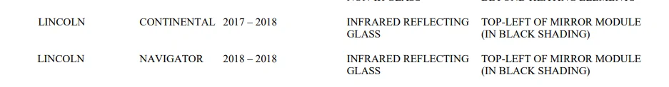

Our toll system has a list of "problem windshields" it hasn't been updated since 2018, but I did see this, and matches what others have said. Sounds like that's a Ford thing. This is a list of vehicles and special placements for the sticker if you have the listed feature.
