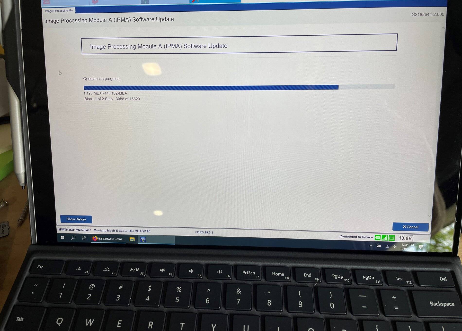

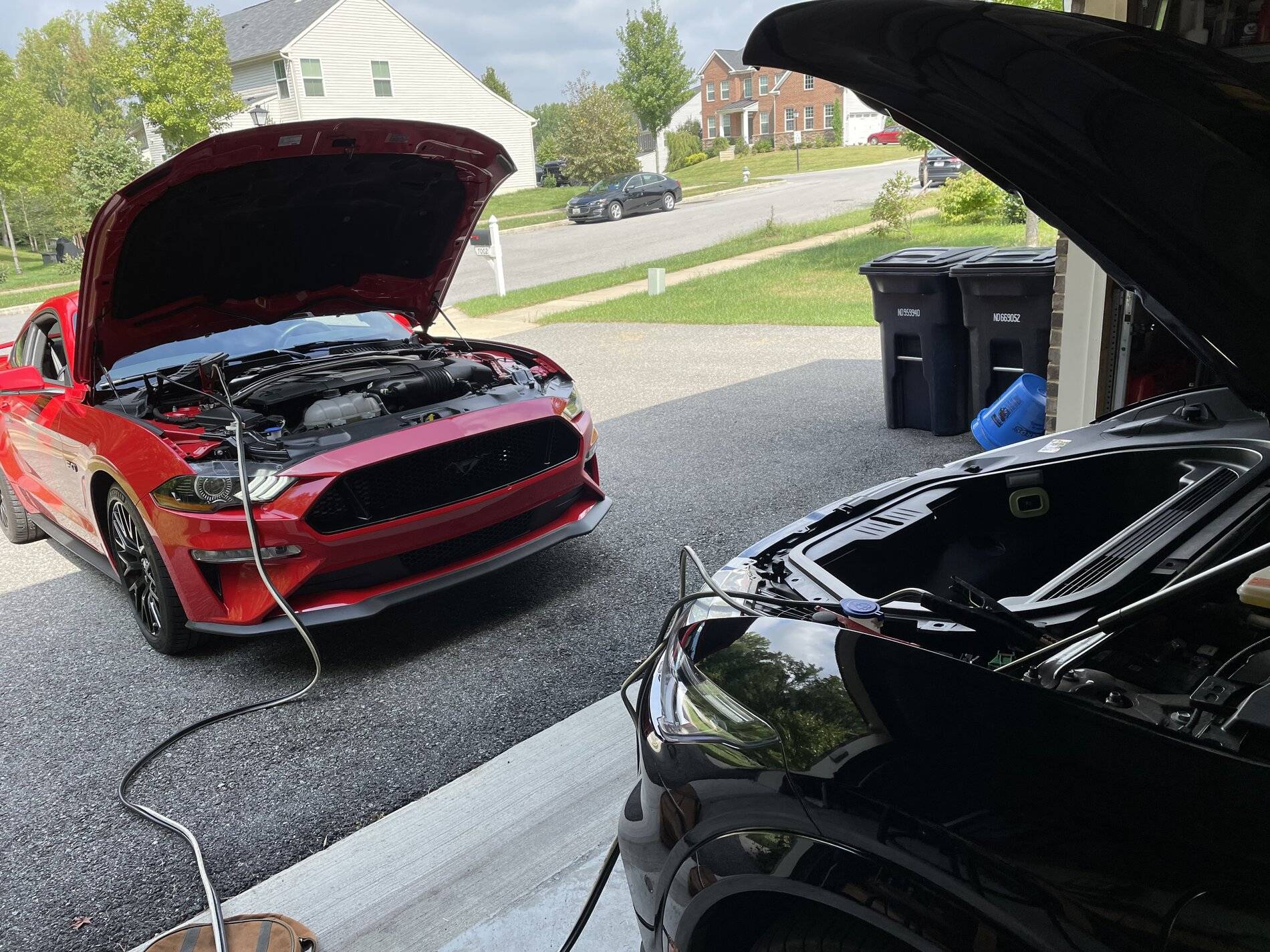

I got busy yesterday and did the IPMA update as well. Took about 90 minutes. Same results as you, no recalibration. Everything just worked immediately.

yesterday, I had periods of 12V 36A draw from the external power supply. Today, the highest current was 24A. 10A might work, or at least extend the time to low 12V LVB, but ideally, we probably want a 50A minimum charger/power supply to cover all bases, especially if FDRS sessions go for hours.
That said, my dealer was updating my MME for some hours before I noticed they had no charger connected, and everything was still okay. I bet many dealer updates are done with no power supply connected. Or, the dealer might connect L2, which some TSB/SSM say is not the same thing, and not recommended in lieu of a 12V charger/power supply (or, a Red Mustang!).
