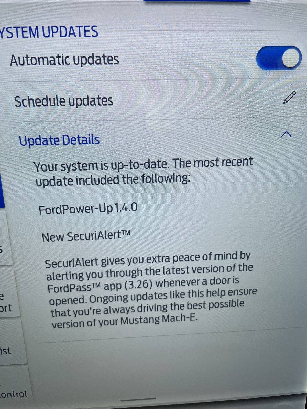

The GWM should have been updated with the PowerUp 1.6 update
So the latest update is 1.6?? I thought I had read that someplace else too.. I just received my car in July 23rd I believe and I'm only on 1.4.0... :-| Could explain why I'm having all these odd ball issues...
And yes I have auto updates on, although FordPass said is manual only... I have also verified my car is connected to my WiFi and manually did a update check.
