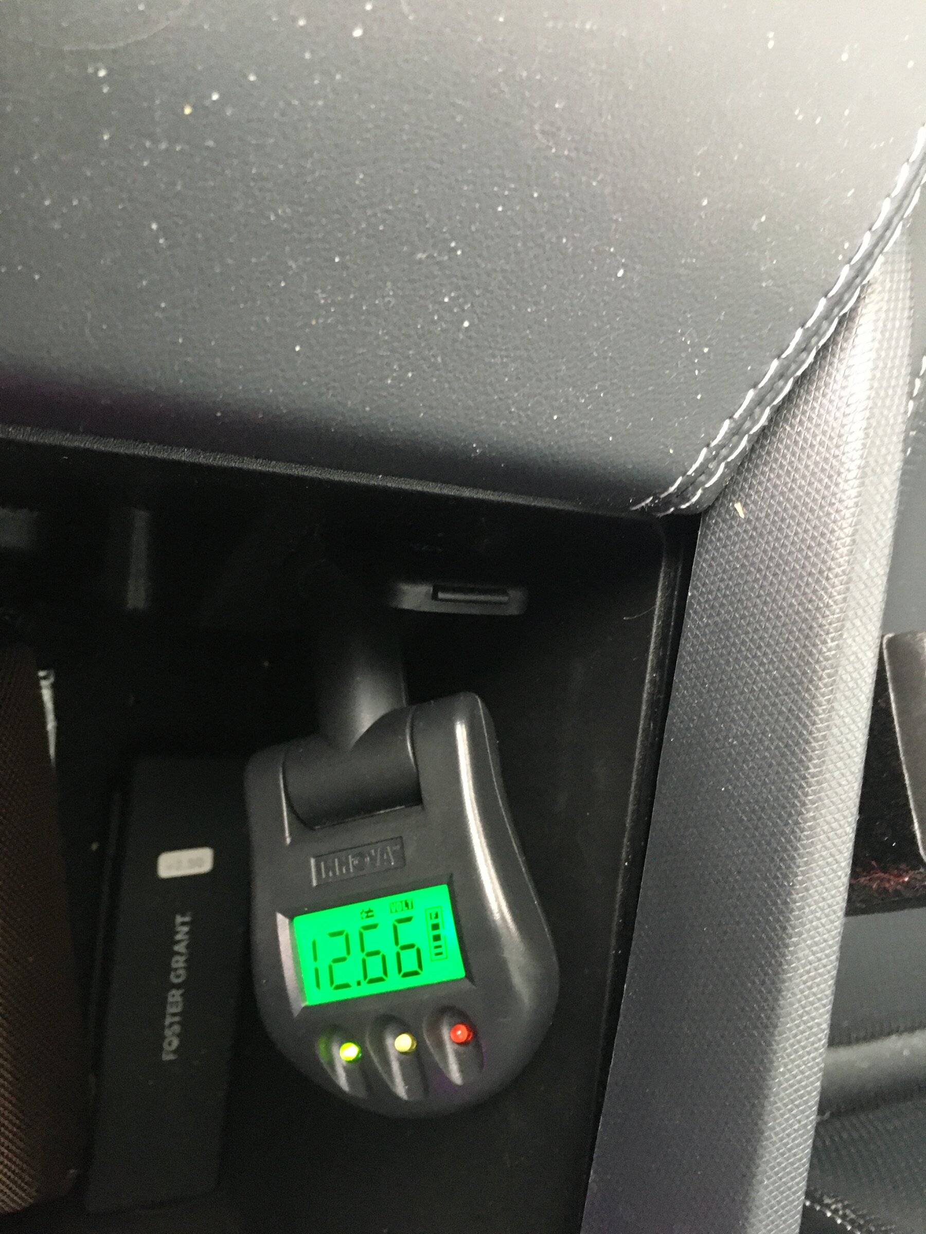

This is typical of what I see after shutting the car down. While running its usually around 14.4 when the LVB is being charged.
12.6 is no problem at all....
design is for HV to kick in and bump it if it drops to 11.9 while sleeping automatically, so don't 'sweat' it. ;)
anytime your MME is 'on', the acc system will be at 14.4-14.9 charging that baby up... and then checking that baby even when in deep sleep. problems seem to be happening when it is REALLY cold and HV state of charge is <30%.

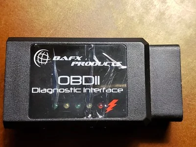

I wanted to give you a better response just in case you have not already ordered a OBDII scanner. The one I was using is from BAFX Products, picture inserted below. I also recently purchased a VeePeak BLE scanner for connecting to ABRP, and I just tested it and it works great with Car Scanner. So if you have not already ordered one, I recommend the VeePeak.
Here is the link to purchase the VeePeak:
https://www.walmart.com/ip/VeePeak-...d-Compatible-1996-Cars-Light-Trucks/954799575
To answer your second question, I would read through this post (https://www.macheforum.com/site/threads/how-to-recondition-service-your-12v-battery.11069/).
The answer is not clear, but if you have a SOC below 50%, that is pretty low. I think you will get errors below 40% (maybe) or 30% (almost certainly).
