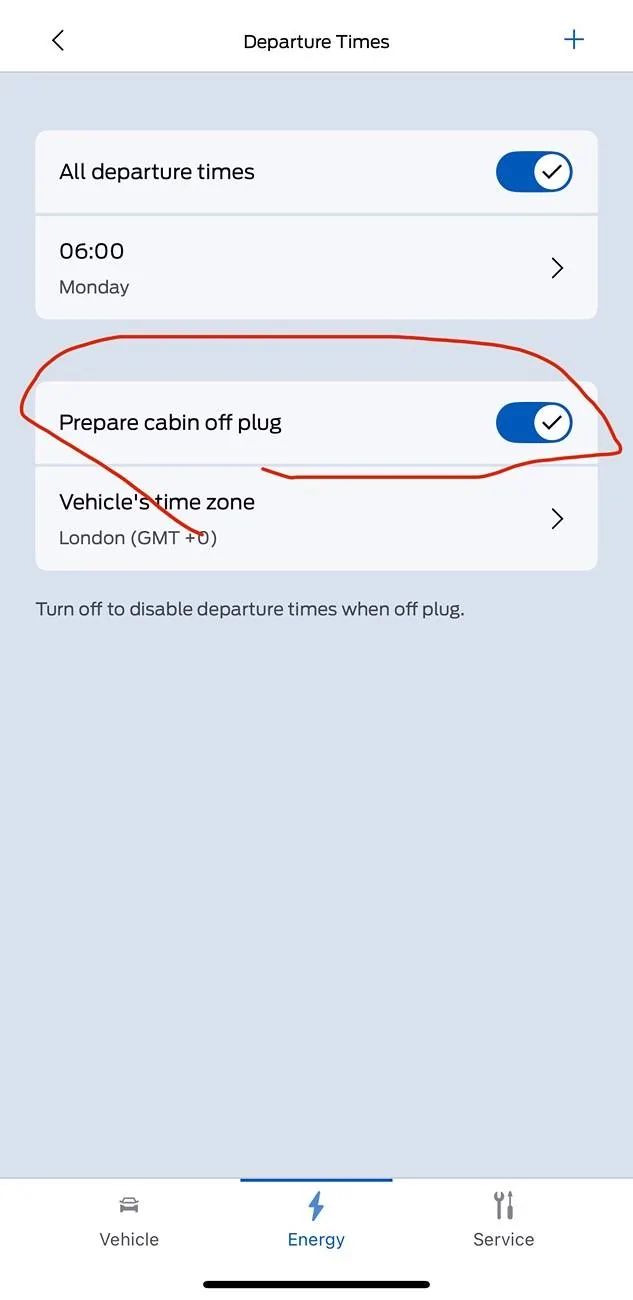

Teslaeata
Sep 28, 2022
3,470
4,210
Nottingham, England, UK
Following up on mine. Plugged in departure schedule worked. Unplugged still seems to not be working, more testing tomorrow.
In the app there’s an item to set preconditioning on whilst off plug
Does that assist?
Ford Mustang Mach-E I don't think my preconditioning is working IMG_7356
Does that assist?
Thank you but no. This will only heat (prepare) the cabin and not precondition the battery.
Does that assist?
Yes I have toggled that and tried it both on and off incase there was something odd about it.
Does that assist?
No I already know about that and it does not make my car heat the cabin if unplugged. Only way my car prepares for departure in any way is if it is plugged in.
