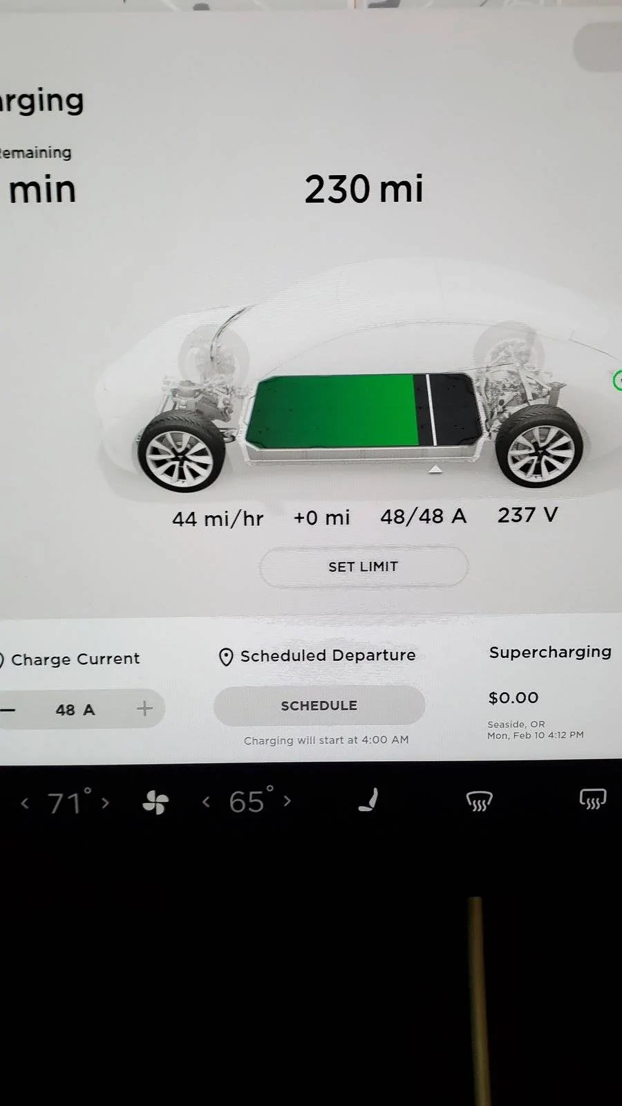

You can disagree all you want. You're wrong. I have no idea what you're talking about "if a software upgrade exists". It is well documented that the Model 3 accepts 250KW charging at a V3 Supercharger. As far as home charging, from the Ford Website: "Est. 32 miles of range per charging hour, using the optional Ford Connected Charge Station installed in a (240V) outlet* " https://www.ford.com/suvs/mach-e/2021/ Go to the webpage. Read what is actually there. 32 Mph at 240v and 48 amps. Duh. Or are you saying Ford has no idea what their car will do? And as far as charging the Model 3, here's a picture taken a couple of minutes ago, just in case you don't believe Tesla's numbers.
Yes efficiency matters in miles per hour charging rate. If car A can go 4 miles on 1 Kwh and Car B can go 3 miles on 1 Kwh, and they both charge at a rate 1 Kw, then in one hour car A will add 4 miles of range and car B will add 3 miles of range. The charging rate for Car A will be 4 Mph, and the charging rate for Car B will be 3 Mph. This is really grade school level math you know. Wishful thinking does not equal mathematical proof. You really don't seem to get that.

If you'll actually read my response, I stated that was very possible. I just don't get why you'd buy the Clipper Creek cable when the Ford wall mounted charger will do better yet for the same or possibly less money. (48 amps and 32 mph charging.) BTW, here's some more grade school math for you: if 32 amp charging = 22 mph, then 40 amp charging (50 amp circuit) = 27.5 mph.
