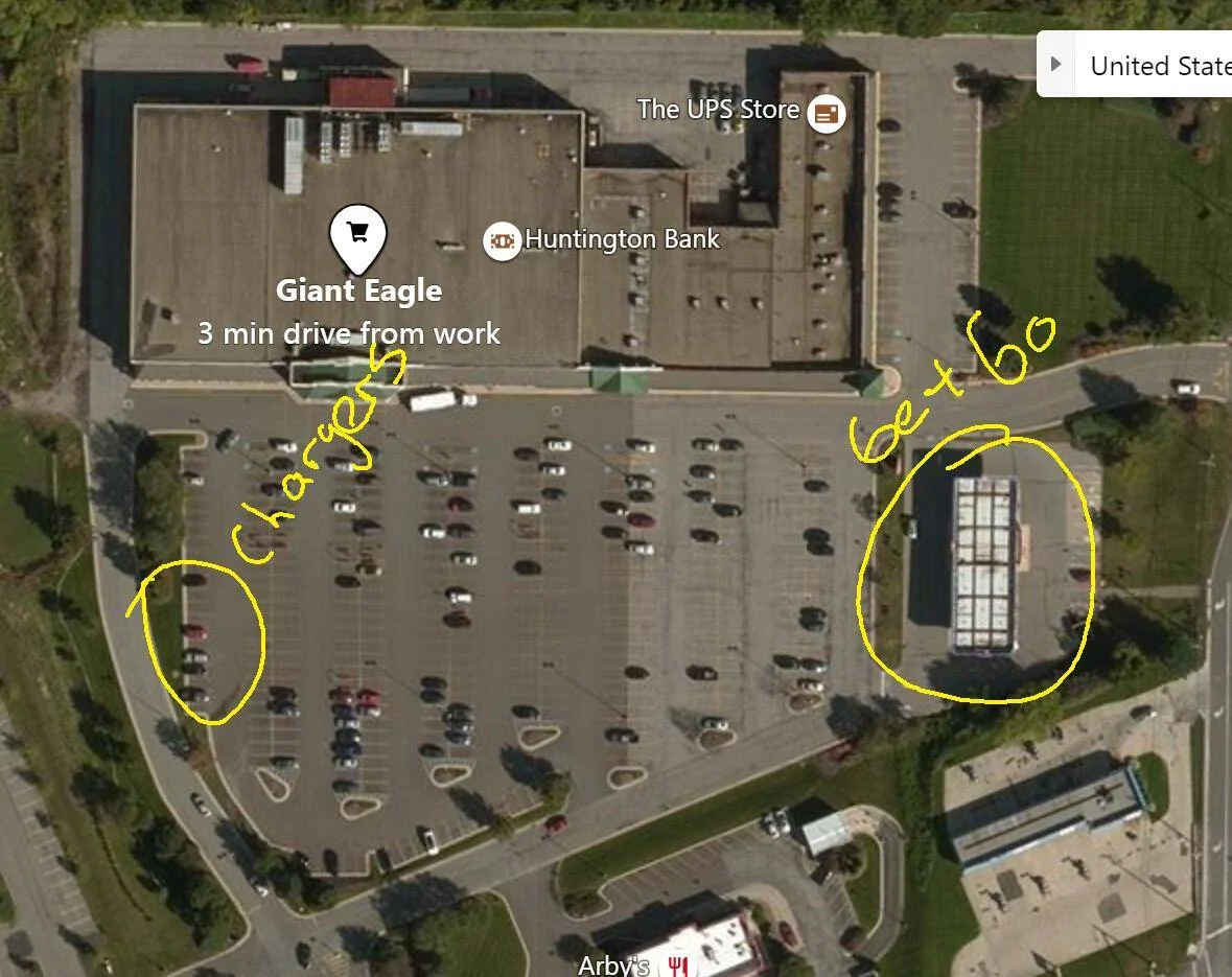

Which 4 Getgo stations have fast electrical charging? Giant Eagle received 660,000 from pa department of environmental and conservation for this.
for the ones I'm thinking of, they aren't at a GetGo (although there is one next to the Giant Eagle), they are in the Giant Eagle parking lot, in fact about as far from the GetGo as possible.
Monroville Giant Eagle or where exactly?
