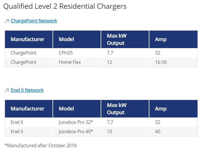

I thought the same thing. But with further research I found my local utility (Detroit Edison) has a $500 rebate for particular plug-in wall hanging units.
Since I have to have a 14-50 plug installed anyway to use the mobile EVSC Ford provides or a plug-in wall hanging unit. The aftermarket wall units that DTE will provide a rebate for are in the $600 range. That works out that I can get an aftermarket wall mounted unit for an approximate net cost of $100 (excluding the wiring and plug install). The Ford hardwired wall mounted unit is probably going to be in the $750+ range (and no rebate) so that is probably out of the running cost wise.
With this plan I could keep the provided portable EVSC in the vehicle.
Similar situation in NJ, except that the state gives the $500 rebate on the EVSE so it can be any charger. I'll definitely get an EVSE and leave the mobile one in the car, just waiting for prices and specs to decide between Chargepoint, Ford, or whomever.
My speculation is that the Ford hardwired version will be in the $750-$800 range. That’s why I’m shopping the Juicebox models that my utility will rebate. I’m thinking about spending the federal stimulus money for the electrical service work. Looking to work with a local company.
Is that all DTE is providing these days ($500, er quoted the wrong post LOL)? Back in 2013 they would give you $2500 toward the EVSE and installation.

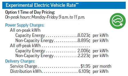

Yeah, that's it. But the off peak rate per kWh is around $0.08, so that's a bonus.
You could qualify for a $500 DTE rebate if you:
  • Purchase or lease an EV
  • Install a qualified Level 2 charger
  • Enroll in a year-round time-of-use (TOU) rate
