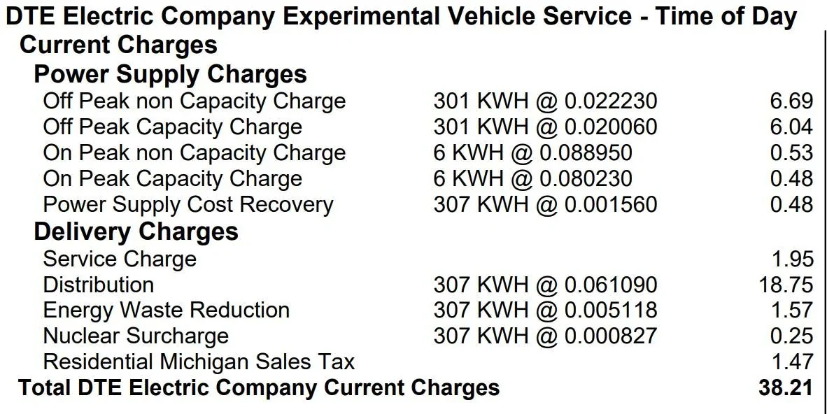

Actually, OFF peak is $0.02/kWh.
Here is my last EV bill (which ended 3/20--right about the start of this whole virus madness) so it includes about 900 miles of driving or so:
Ford Mustang Mach-E Ford Charger for Mach-E Annotation 2020-04-06 170313
This is for the Bolt in winter--I'd expect the Mach-E to be a little higher as it doesn't appear to be as efficient as the Bolt.
Note the distribution charges: they will get you ! LOL
I was adding the $0.02 + $0.06 ---- but it looks like it's closer to $0.12 per kWh total all in. Very interesting, thanks!!
