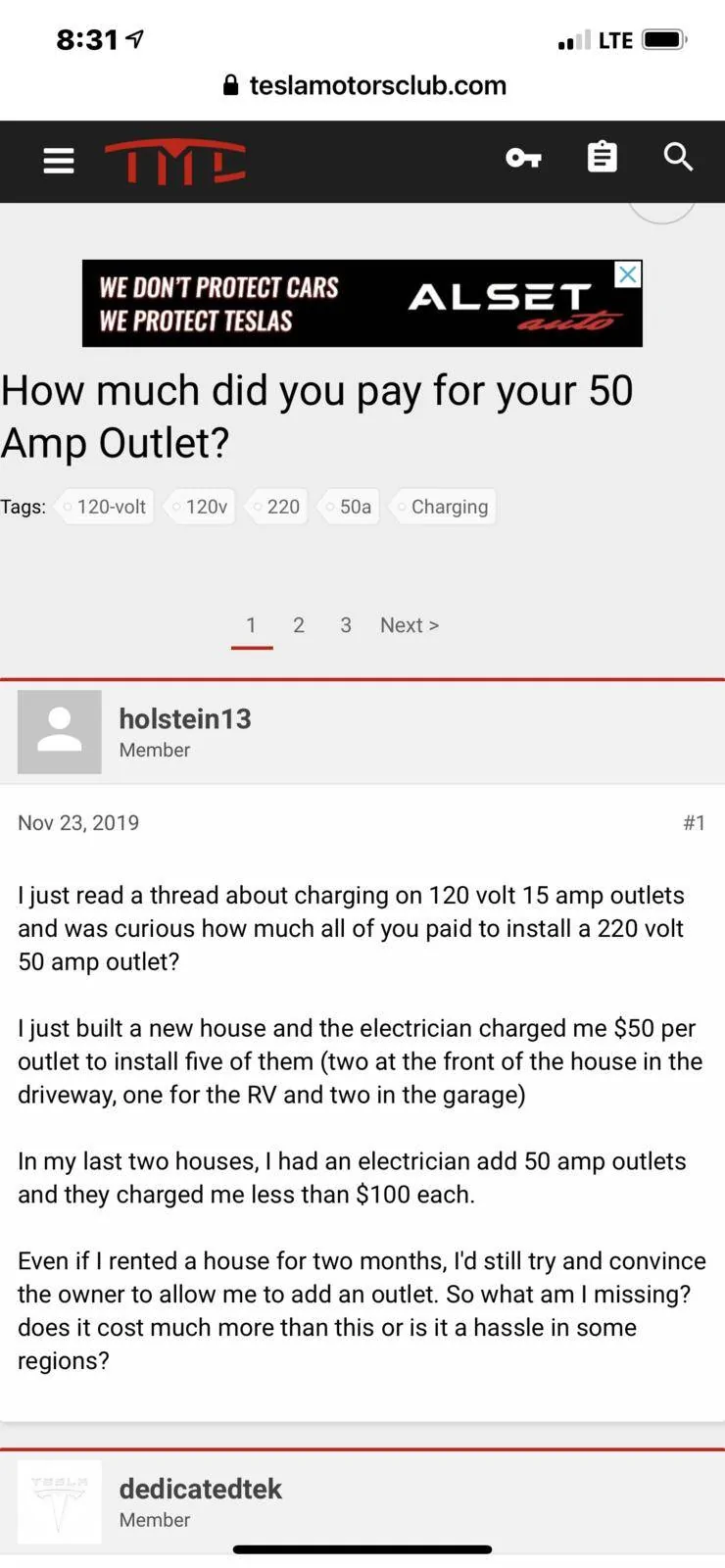

I had an electrician turn a 120 in my garage to a 220 with a 60 AMP breaker. The total was about $25 in parts and 1 hour of times. Under $100 for the whole thing. I did give him two diet Coke’s and 2 bottles of water. That might have helped the price a bit.
