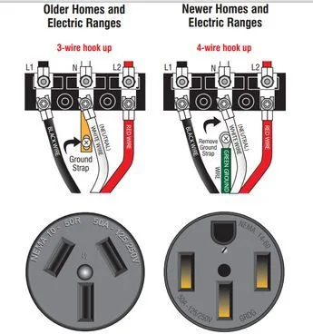

I think 10-30 is missing the ground wire. If this is true, you might want to have it rewired. I'm not an electrician.... But I'd recommend checking in with one.
As for this particular EVSE, it's probably fine, but just be aware that it isn't tested or registered by Intertek or UL, which are the bodies approved to rate electrical devices for fire safety in North America.
Some of the brands that are registered/tested include Clipper Creek and Siemens. They won't have products with the plug type that you're looking for (grounding is required). But they're probably also more expensive.
If you end up having an electrician help with this, and depending on your specific situation, it may end up cheaper and better to rerun the circuit to be 50A. Then with a 14-50R receptacle, you'll be good to go with the charger included with the vehicle.

I would not use that recp. The plug you show has 2 hots and 1 neutral / ground combo.
Years ago they ran 3 wire runs to dryers and ranges. The 3rd wire was the neutral
and ground. That is no longer allowed. Do it right and run a 4 wire circuit.

For a bit of elaboration, here's Clipper Creek's explanation...
https://clippercreek.com/does-clippercreek-offer-an-evse-that-can-plug-into-a-nema-10-30-receptacle/
Does ClipperCreek Have an EVSE that Plugs into a NEMA 10-30 Outlet?
ClipperCreek does not manufacture any electric vehicle charging stations with the NEMA 10-30 plug as the corresponding receptacle (outlet) for this plug type is typically wired with a neutral wire as opposed to an earth ground and all of our models require an earth ground connection in order to operate properly. Additionally, when charging an electric vehicle the ground is passed through to the vehicle from the station for safety earth grounding during charging. If a neutral is used instead of a ground the neutral could generate a charge on the vehicle chassis, creating a potential safety hazard upon contact with the vehicle during or after charging. For these safety reasons we do not offer an EVSE with the NEMA 10-30 plug and it would not be advised to utilize any of our EVSEs with a NEMA 10-30 adapter.
If you have a NEMA 10-30 receptacle you would like to use for a ClipperCreek EVSE it would be recommended to have an electrician re-purpose the NEMA 10-30 receptacle into a NEMA 14-30 receptacle.

Before you get worried about installing a new circuit check first :
Can you see the wire going to it ?
Is it flat or round ?
If round it is most likely 10/3.
Shut OFF the breaker and remove recp cover.
You might find the ground in that box tied to neutral or metal box.
If so buy a 4 wire recp and install it.
This was very common to do for 30 amp dryer circuits.
You most likely will luck out and have what you need.

I will certainly check it out. Exactly the info I was looking for. Thank you!
