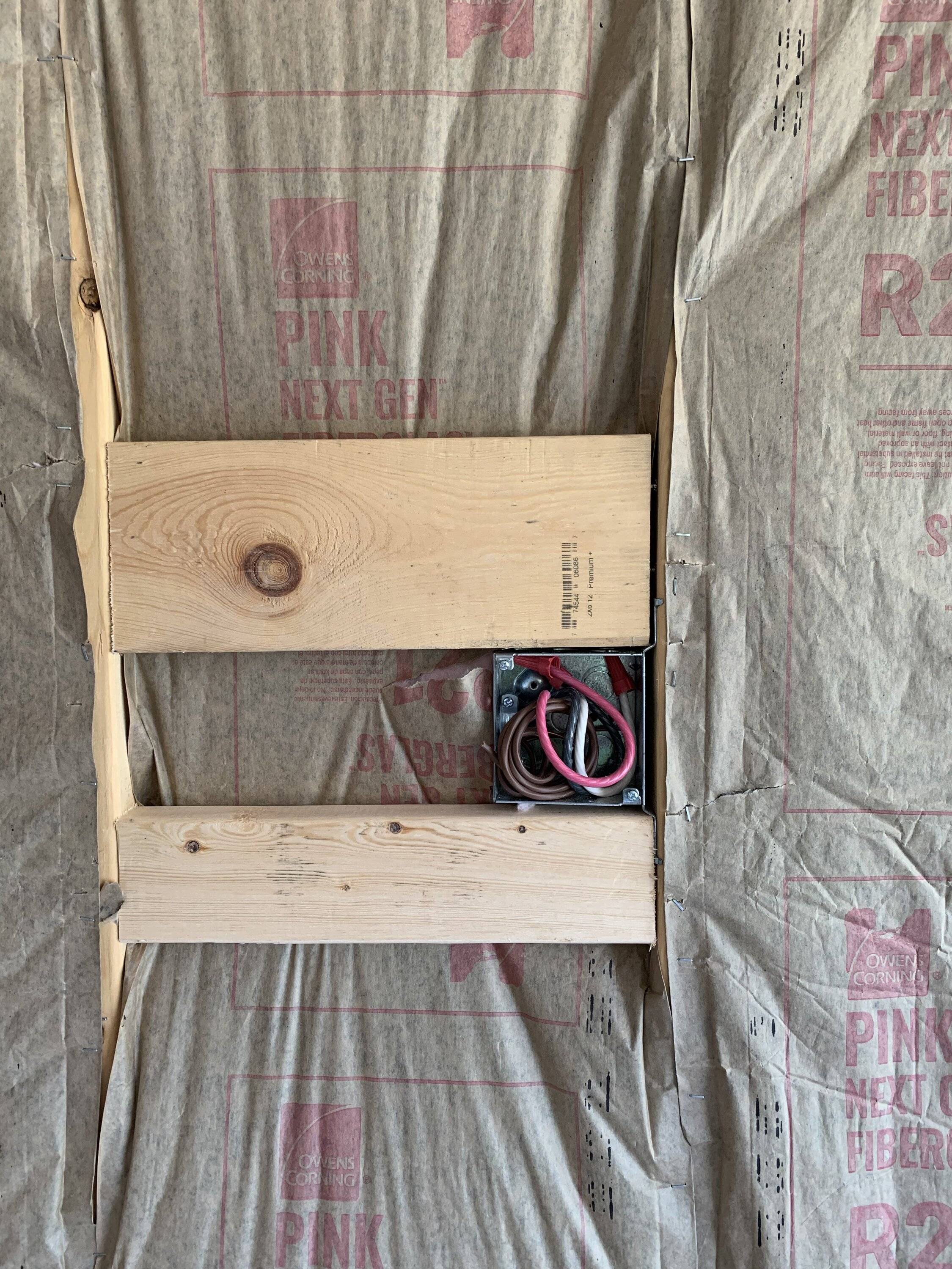

Thank you, using 6” walls so hopefully can make the 90 turn with the right conduit box.
So will have a 1” conduit hole in wall with 2/6 coming out.

Again the issue is the access cover on the backside of the conduit body would not be accessible inside the finished wall. That would fail inspection. I don’t think conduit will work for a rear entry if you need to pass inspection.
Maquis
5,721
8,139
Yes, you can drill the hole in the back.
If you want flush use romex and just have it stub out of the wall. Use a cable clamp in the conduit hole. The EVSE will act as the junction box. 40A setting with romex.
Can’t make the 90° bend in the wall legally with conduit and have it accessible. MC cable might be another option if you can bend it sharp enough in the wall.
MC is the best option since it will allow #6 wire instead of #4 Romex. With 6” studs, I think the bend works, but I haven’t checked.
Another option is to run smaller wire and set the DIP switches to an appropriately lower setting.
Thinking I have two options:
A) called building inspector this morning and I can leave the wire loose. Ready to put in back of charger. As long as the other side of the wire is NOT hooked up to the 220 box.

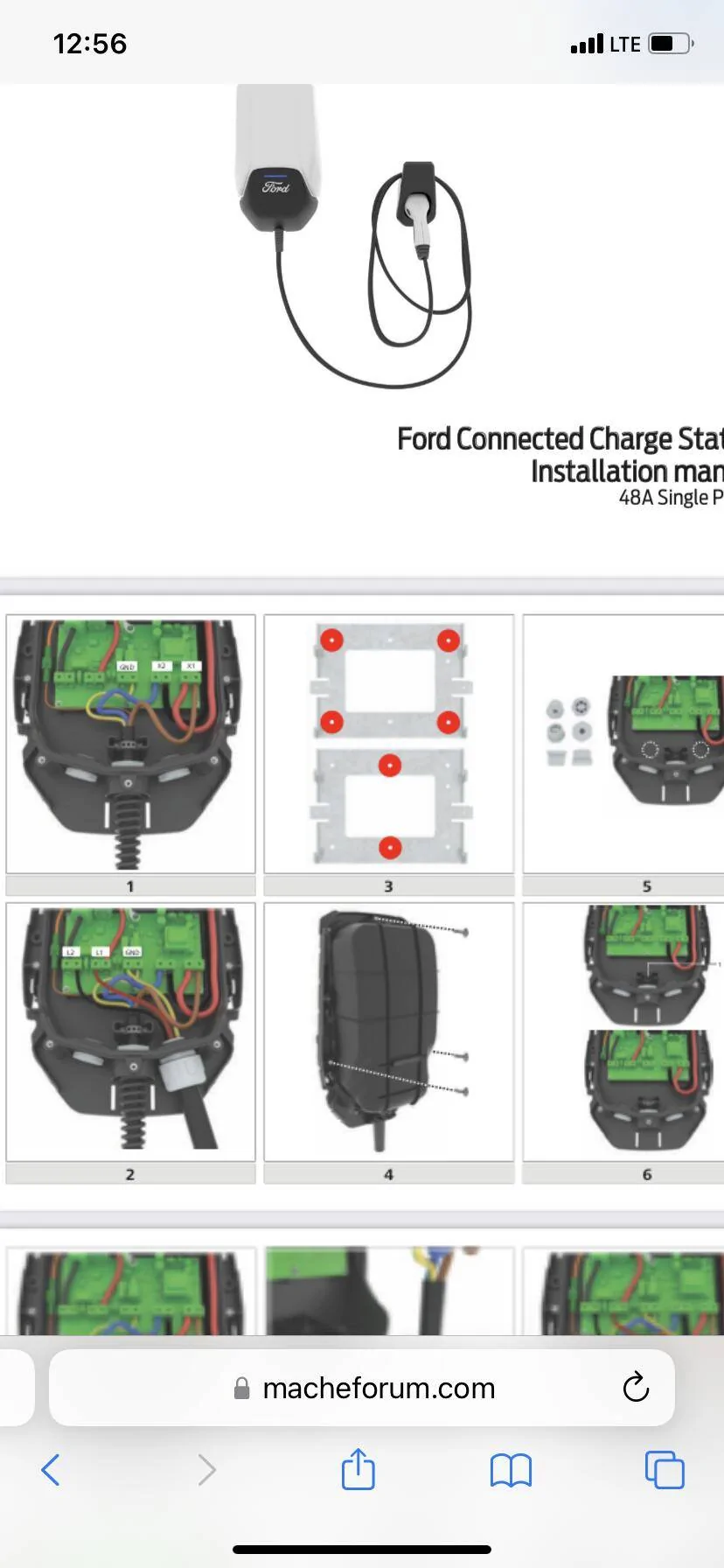

B) does anyone know the dimensions of the inside of the mounting bracket? I can use a box a little smaller than this, then put a cover over it for now.
I asked the same question a year and a half ago. This thread has the best info. Post 373. I popped the beauty cover off of mine and the mountain bracket measures approximately 8-1/2” W x 7” H. I can’t get to the opening to measure it.

Well hoping this is the correct answer.
