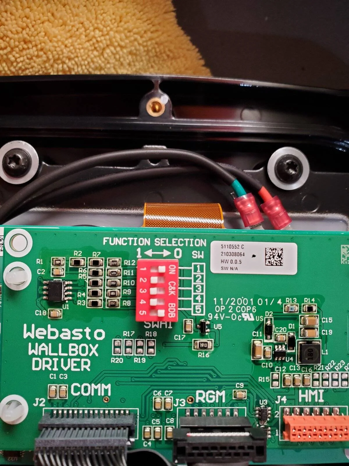

Yes! The issue is your settings for sure. Do not use it until reset Properly. You can only charge with 40 amps on a 50 amp breaker, safety. If you have 48 amps as a setting, that may be your problem and it is unsafe.

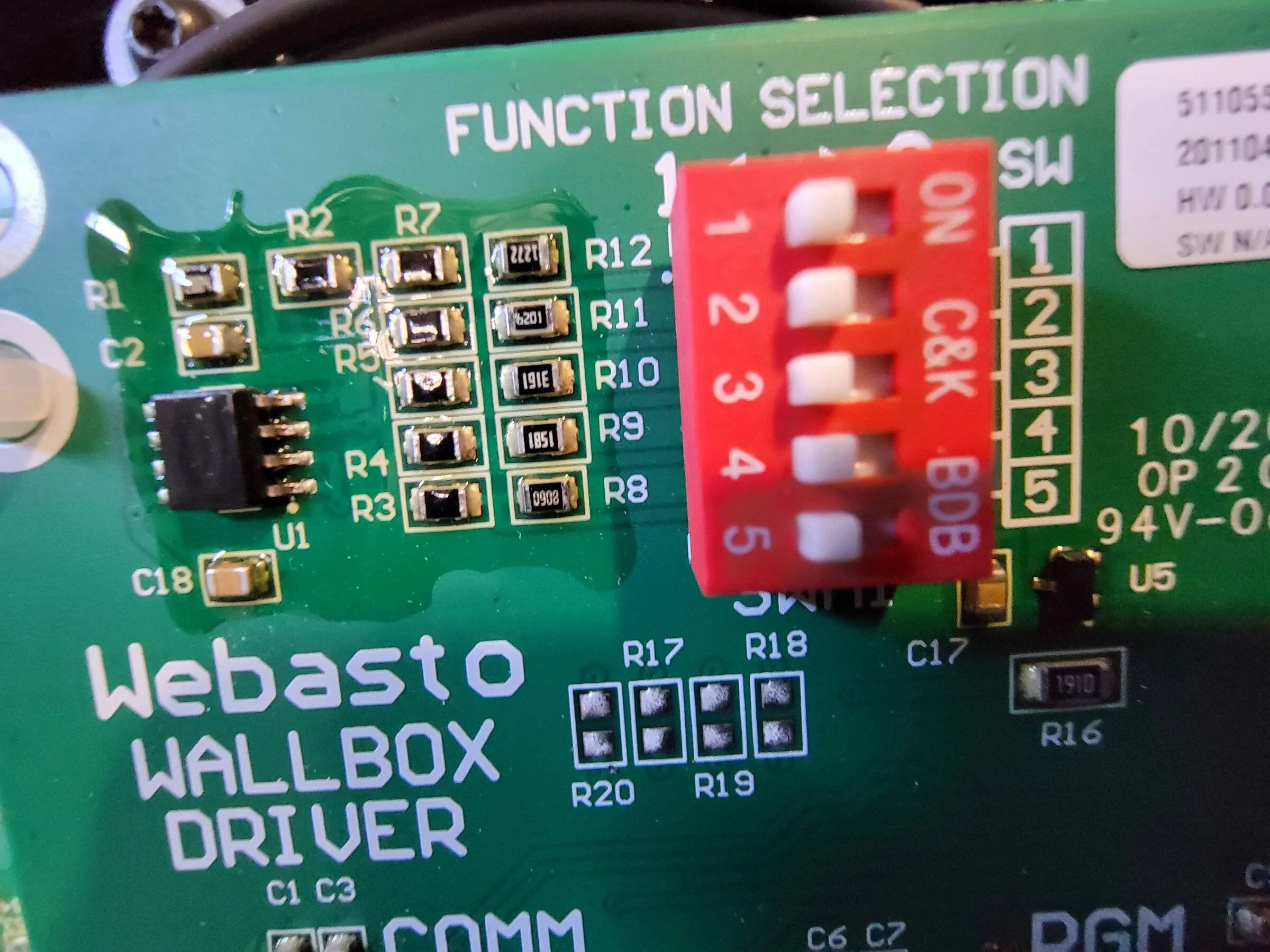

I made the same mistake with the incorrect circuit board labeling and mine did the same thing. You can remove the cover with the breaker OFF and confirm the settings, they should be the 40A 50A CB settings. Remember that the red block is correct, not the circuit board markings. Ford mucked this one up.
I pulled 48 amps through a 30 amp breaker and 30 amp sub panel breaker and it did not pop, but the charger erred out. That’s when I learned from this site that the circuit board is wrongly labeled at the charger.

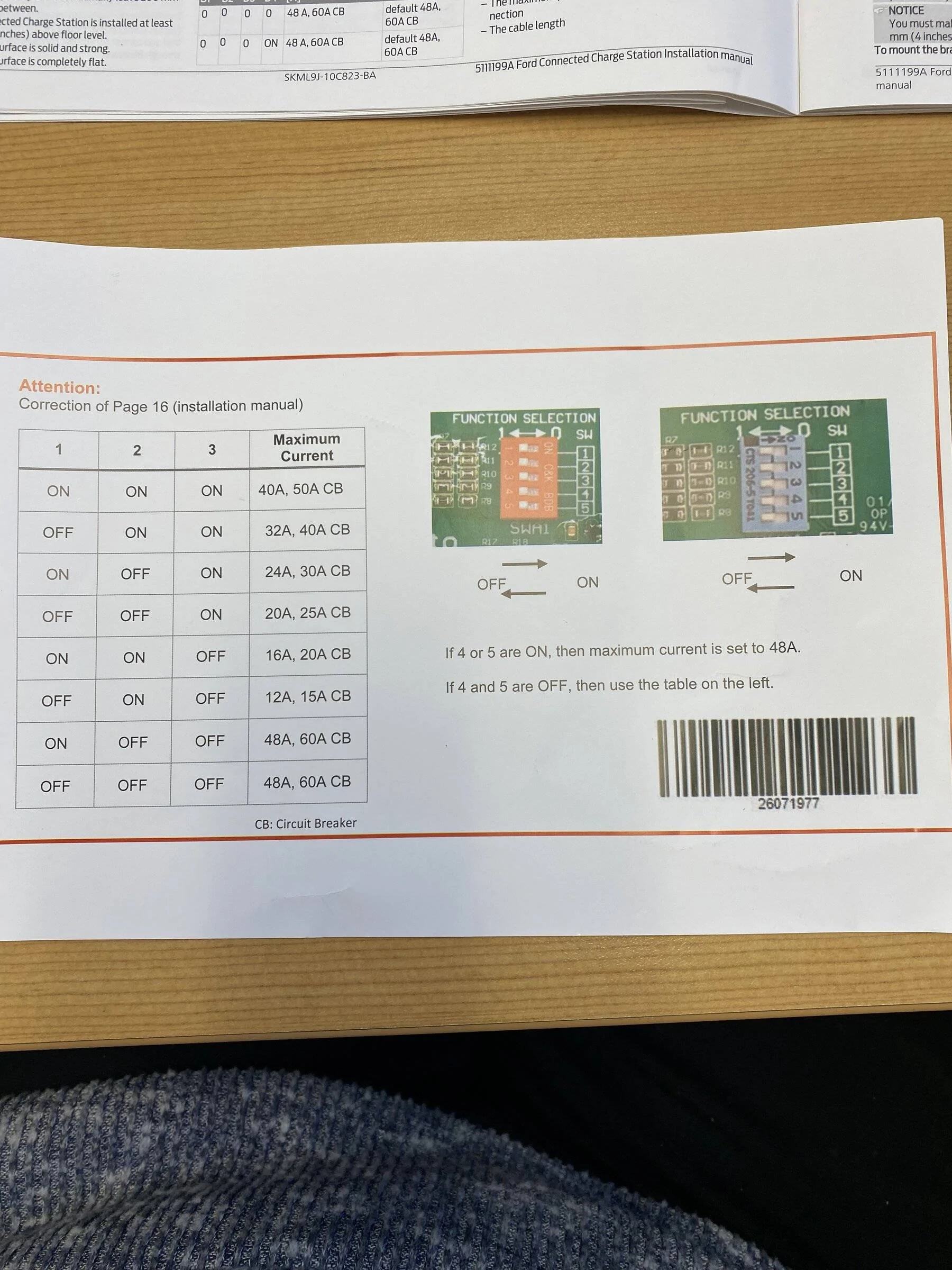

You can try adjusting your phone to 40 Amps and try again and see if it works. I suggest waiting until the DIP switches are confirmed. “On” on the Red Block is ON (or “1” in the manual)……NOT what the green board says, but confirm for yourself And with Ford. As shown in this photo would be a 48 A 60A CB setting.

My charger came with these settings so I don’t know which one to use. Every one I look at is different. Should it be On On On 1 1?

Yes, On-On-On is the 40A setting for a 50A circuit.
When I installed mine, it came from the factory with all switches off = 48A.

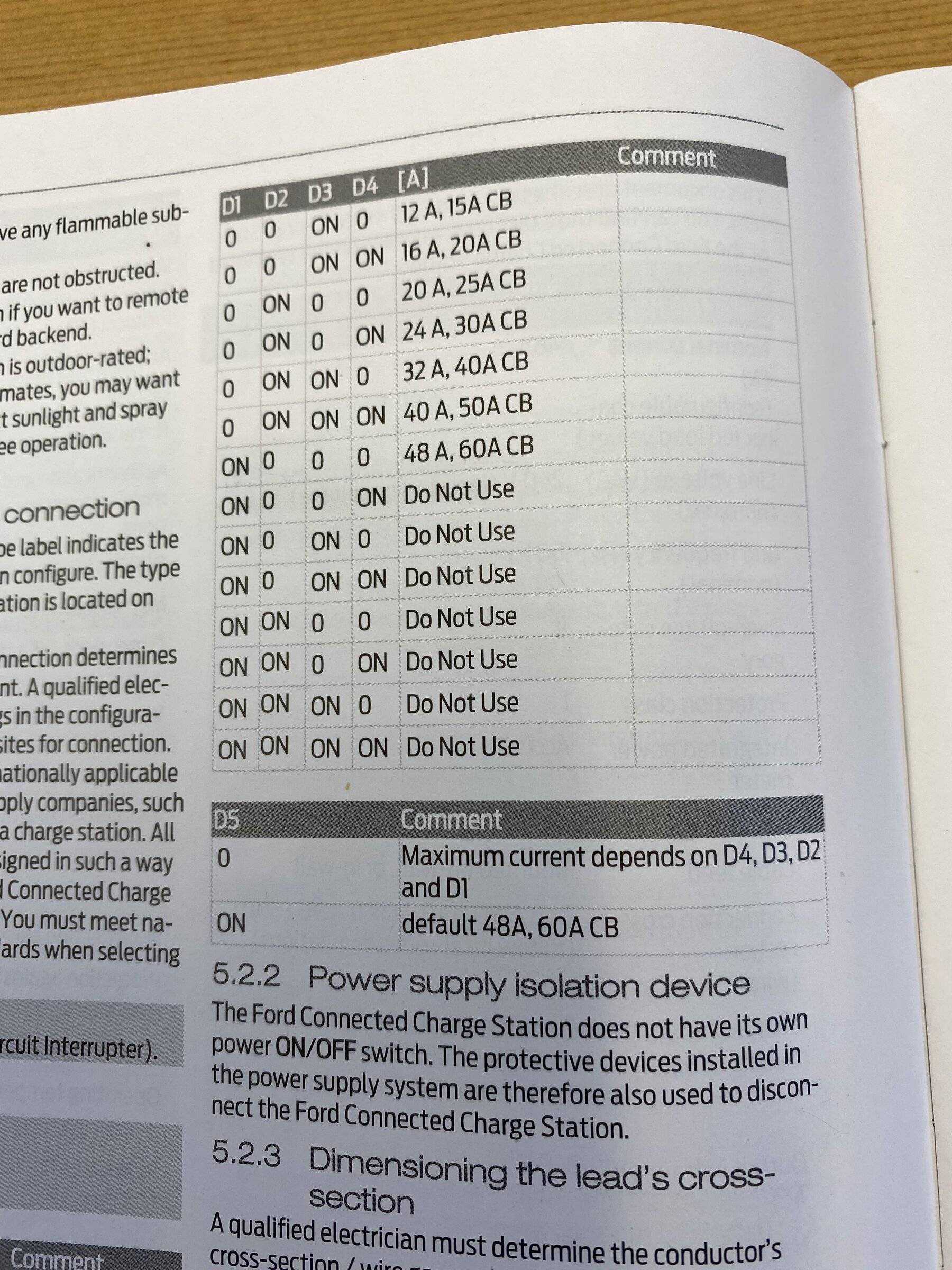

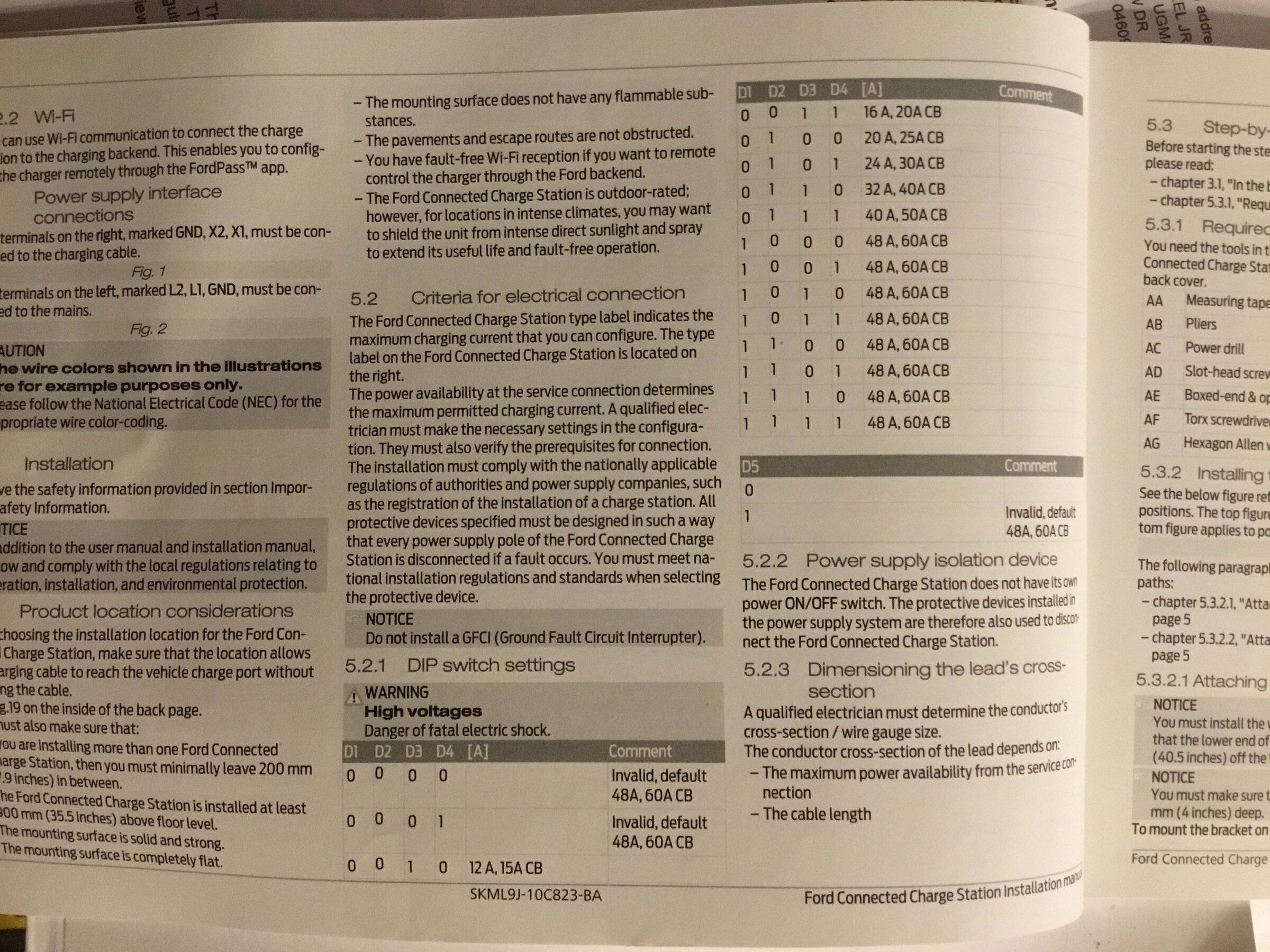

From Manual 1 of your post: 0 on on on for 40 amps.
From Manual 2 of your post: on on on off off
From my manual above: 0 on on on for 40 amps.
From Manual 2 of your post: on on on ??
I do not know what to tell you. This is baad.

The bottom 2 switches (#s 4, 5) should be OFF, ie. to the left, all others (#s 1 - 3) should be ON, ie. to the right, for the 50 amp circuit you have.
Mine is one of the newer builds with the gray dip switch block, it came with all switches ON.
Thank the manufacturer, Webasto for the confusion here, their logic markings are reversed, the way it is marked, 1 = off, 0 = on. This is all hashed out in the Sticky Thread, btw.
