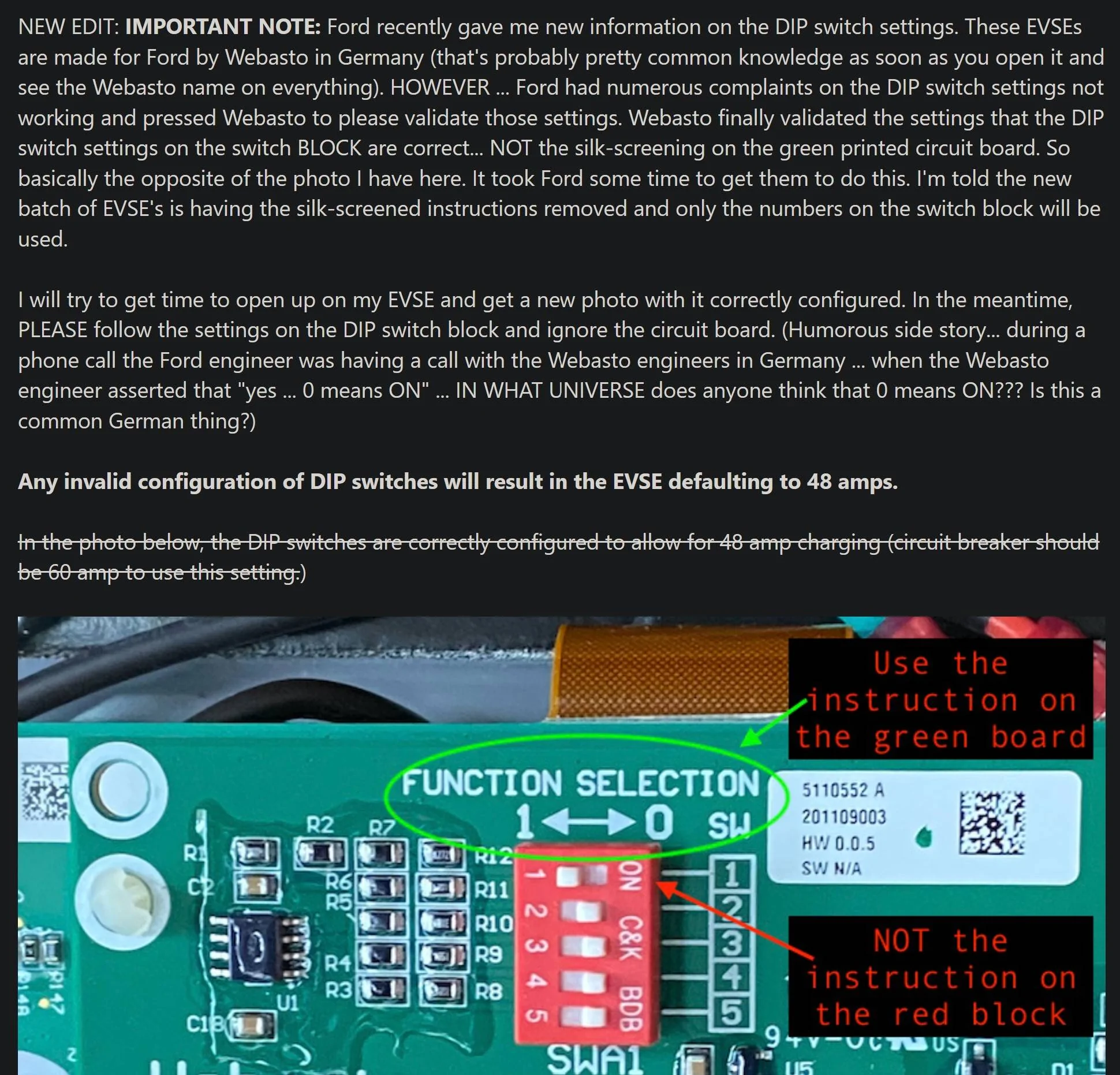

More confusion. The sticky looks incorrect as well. What is listed in the " NEW EDIT: IMPORTANT NOTE " contradicts the text in the image.
That's why I edited and crossed it out. There's a LONG story behind this. I probably should not share it publicly.
Suffice it to say the updated instructions ... FOLLOW THE LABELING ON THE RED SWITCH BLOCK is what you need to do.
I'll have to take that photo down and replace it with a new one.
What adds to the confusion is that this setting actually WORKS correctly ... for ME. But that's because it's technically "invalid" and any "invalid" setting defaults to 48 amps ... and since I want 48 amps (I have a 60 amp circuit) it always did what I wanted.
I have one of the earliest units ... it was my understanding that later production runs corrected the labeling. If you have a new unit, the "0" and "1" on the green PCB may be reversed from what you see in this photo.
In the mind of some engineer at Webasto (they build these units for Ford and made the labeling) 0 = On. That's exactly backward, of course, but that's why it's labeled this way.

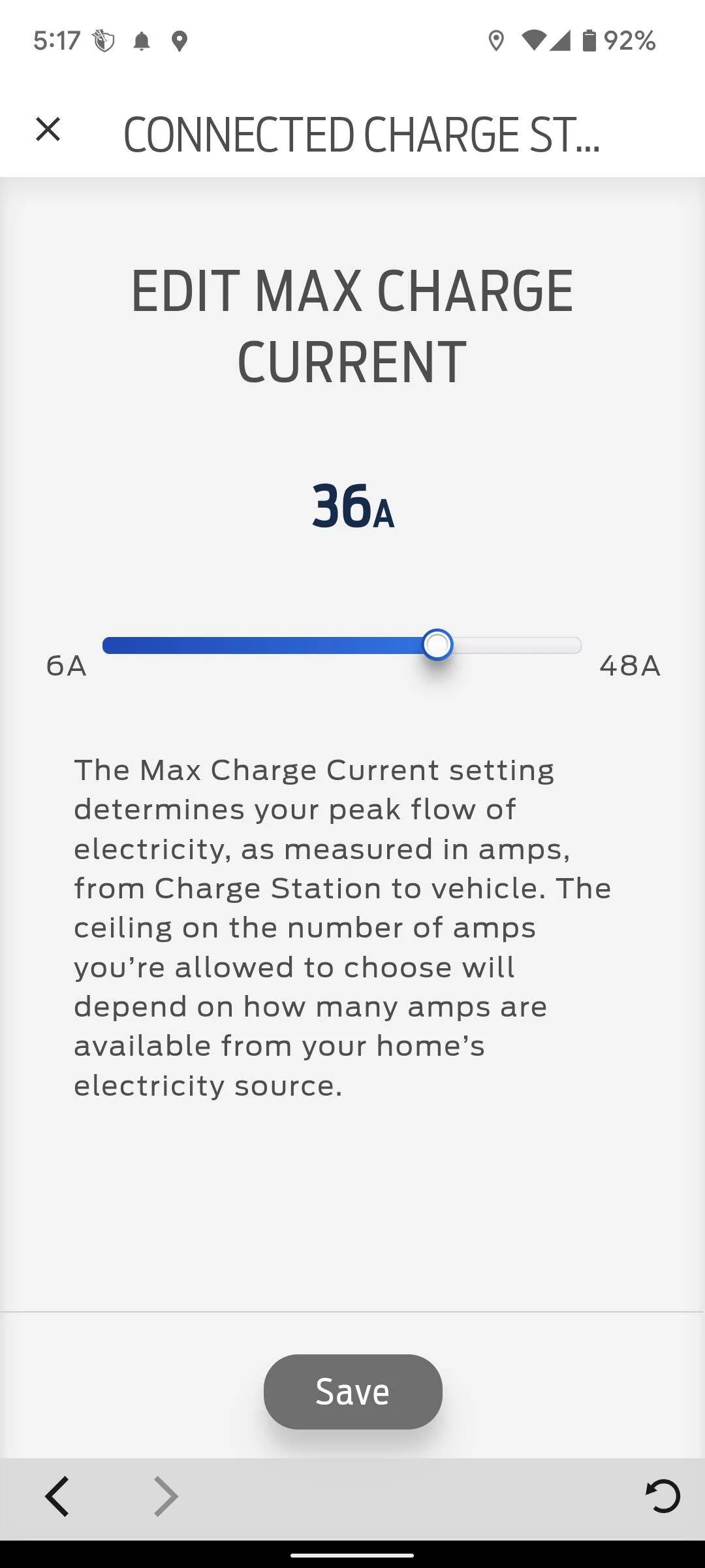

You can verify this without a clamp meter. In fact, it's better to do it the following way, since the clamp meter will only show you current flowing while charging. You should verify correct setup BEFORE charging your vehicle.
Configure it the way you need. Test (see below). If it's wrong due to confusing labelling, TURN OFF POWER, flip all the dip switch positions, and re-test.
To test:
1. Power on the EVSE and wait for it to initialize.
2. If you haven't done so yet, provision the station to your FordPass account. (Follow their instructions for this. It involves the Charge Station Setup app and the FordPass app.)
3. Open FordPass. Navigate to Account, then Charge Station.
4. Expand the section of the page called Settings.
5. Tap the "Edit" option next to Max Charge Current.
This opens a page called "Edit Max Charge Current." On this page, verify that the maximum number shown is as you expect. Mine station is on a 60 amp circuit, so I expect the figure to read 48 amps. If yours is on a 50A circuit, then you will verify that the upper limit for max charge current is 40 amps.

I had wondered about that. Do we know for sure it works that way - Shows the max current = the dip switch setting? I thought possibly it would still show 48 but not allow you select anything above the setting.
Mine is also set to 48 on a 60A circuit and I’m too lazy to open it up for a test. ?
I'm too lazy to test this, also. However in the screenshot from FordPass, it says "The ceiling on the number of amps you're allowed to choose will depend on how many amps are available from your home's electricity source."
Since the only way for the EVSE to know how many amps are available from my home is via the DIP switches, then I take it to mean that the ceiling shown (48A for you and me) is based on our DIP switch configurations.
Right! No question that the max selectable setting will correspond to the DIP switch setting, but what I’m not sure about is how the app will represent that.

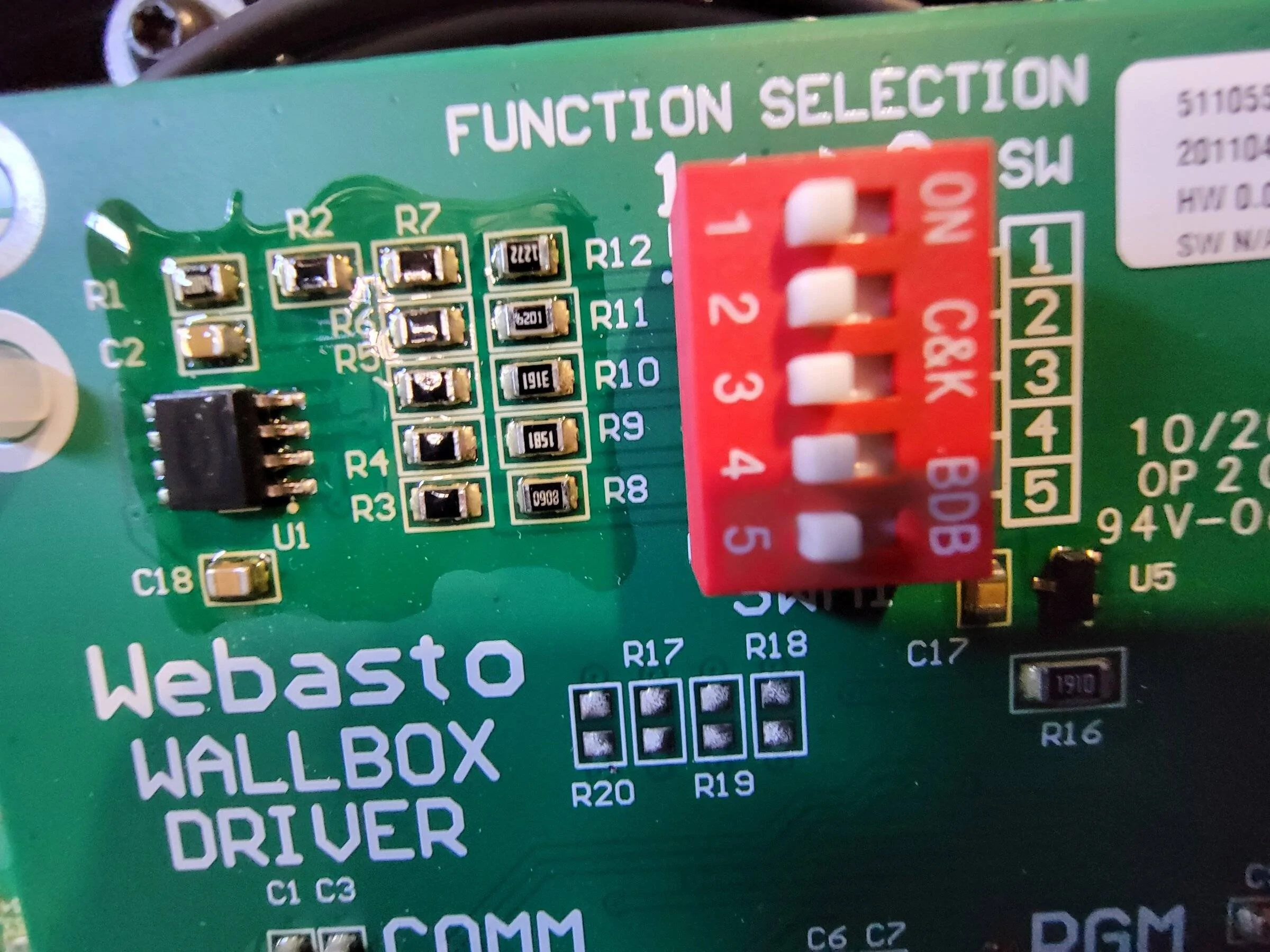

Here is a picture of mine. Looks like I have an earlier unit. I bought it in June. So I should move D1 & D5 to the right ON (Red Block ON)? Yikes, crazy confusing, glad I got this for free from my city. lol

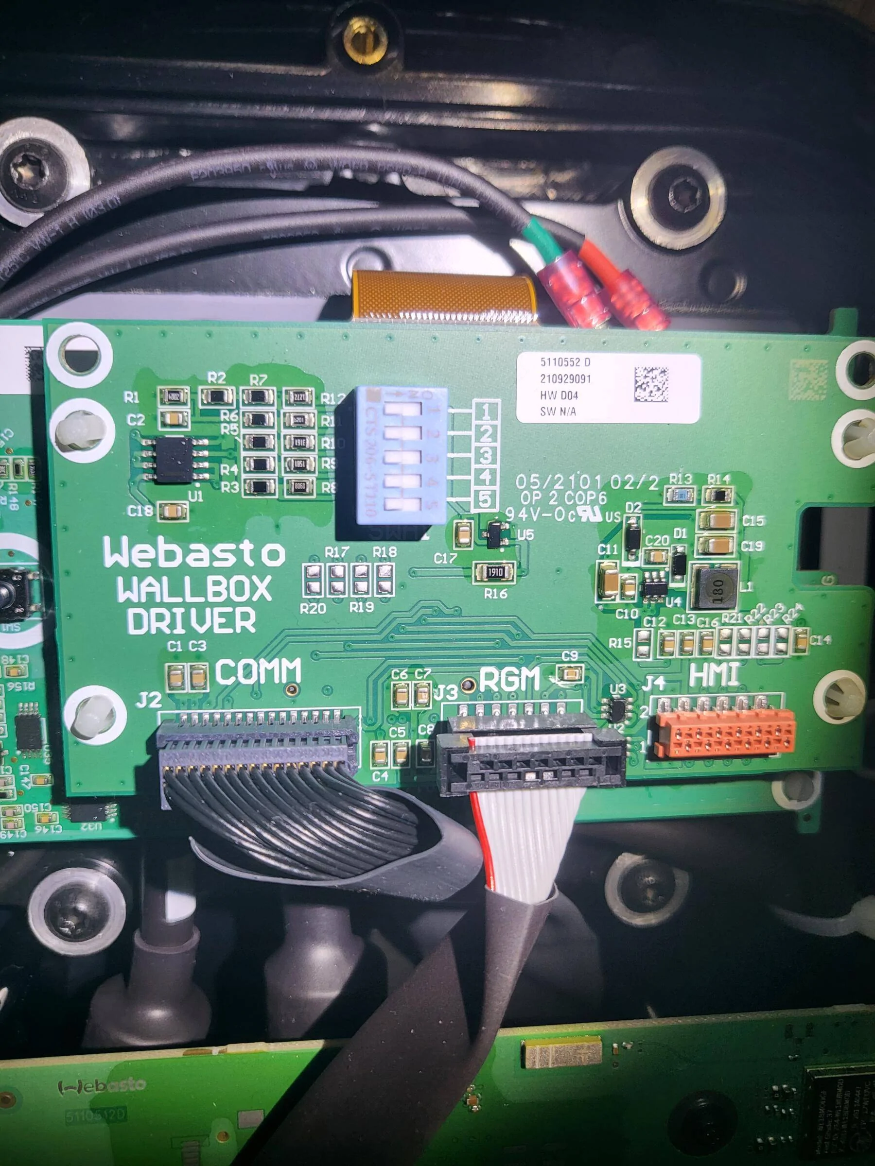

The newer model has a different DIP switch and no labeling on the PCB. I am assuming that the old and new units are electrically the same.
Ford Mustang Mach-E Ford Connected Charge Station issue 1645243120440
In addition to the confusion from the ambiguous markings, it also seems that the on/off switch settings in the original instructions were incorrect because the new manual has an errata sheet (shown in a previous post by the OP, thank you, btw) that indicates different settings.
Bottom line, if either switch 4 or 5 is ON (to the right) max. current is 48A.
If switches 4 and 5 are both OFF (to the left) max. current is adjustable according to switches 1 - 3 as shown in the errata table.

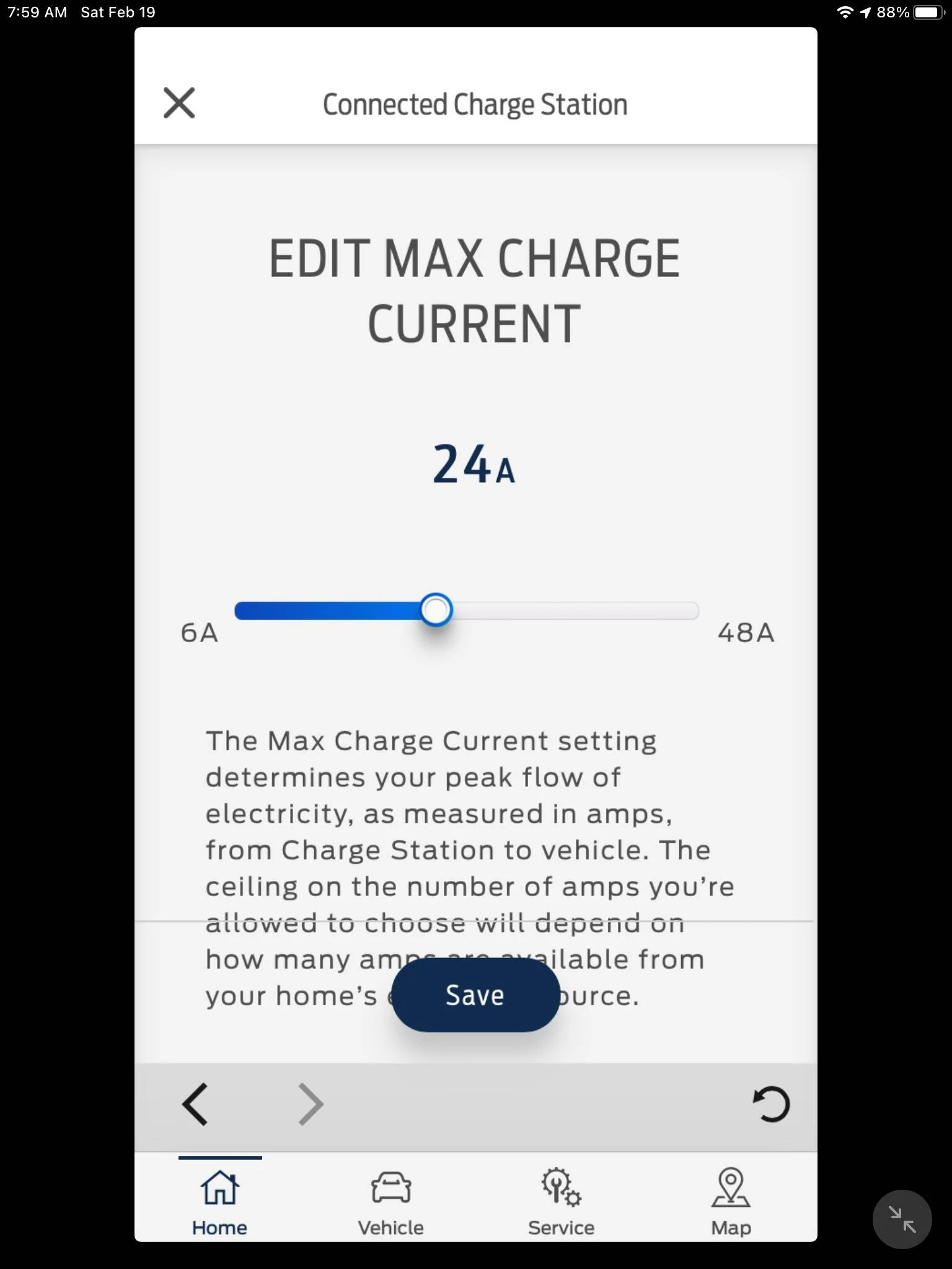

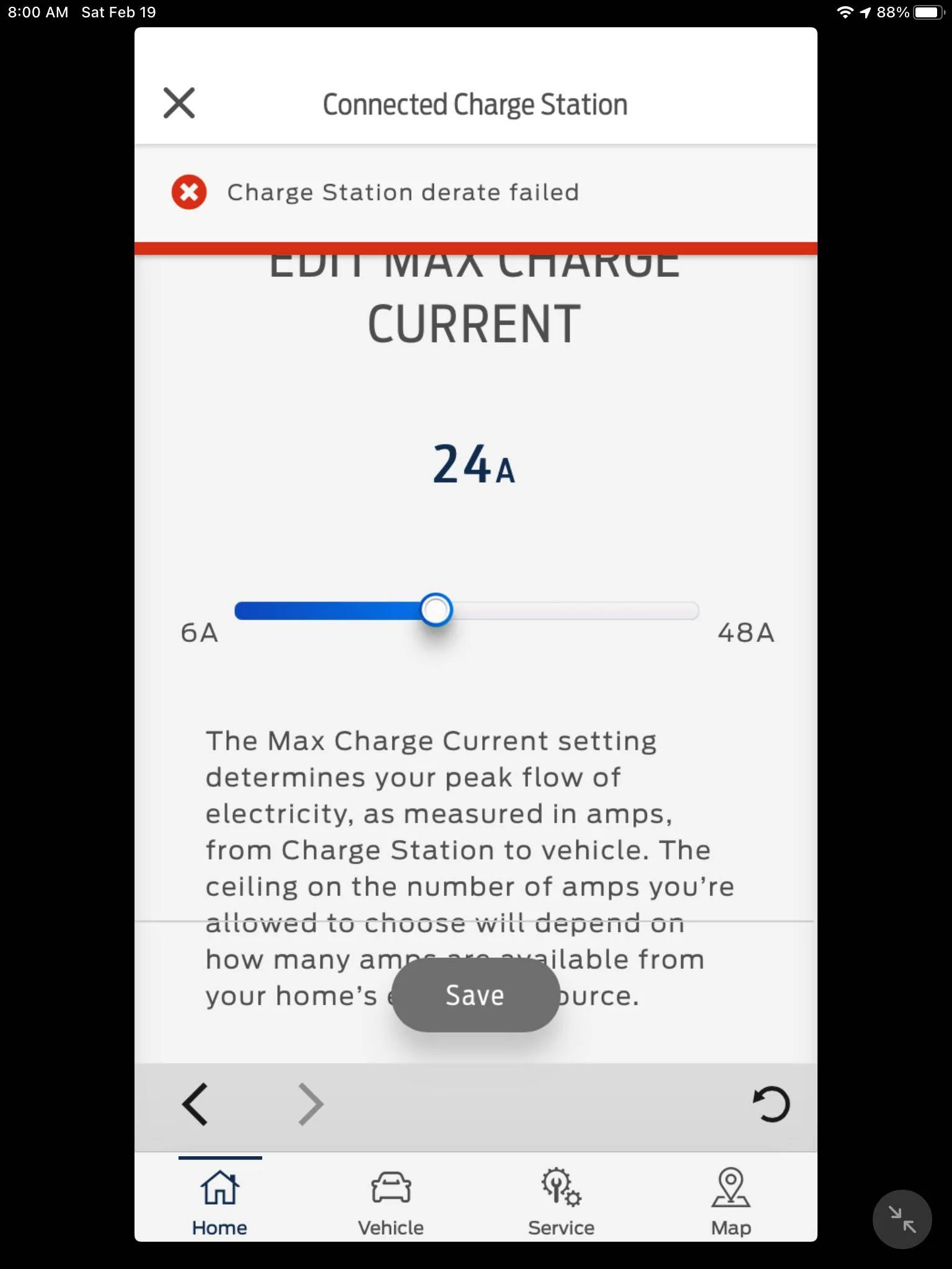

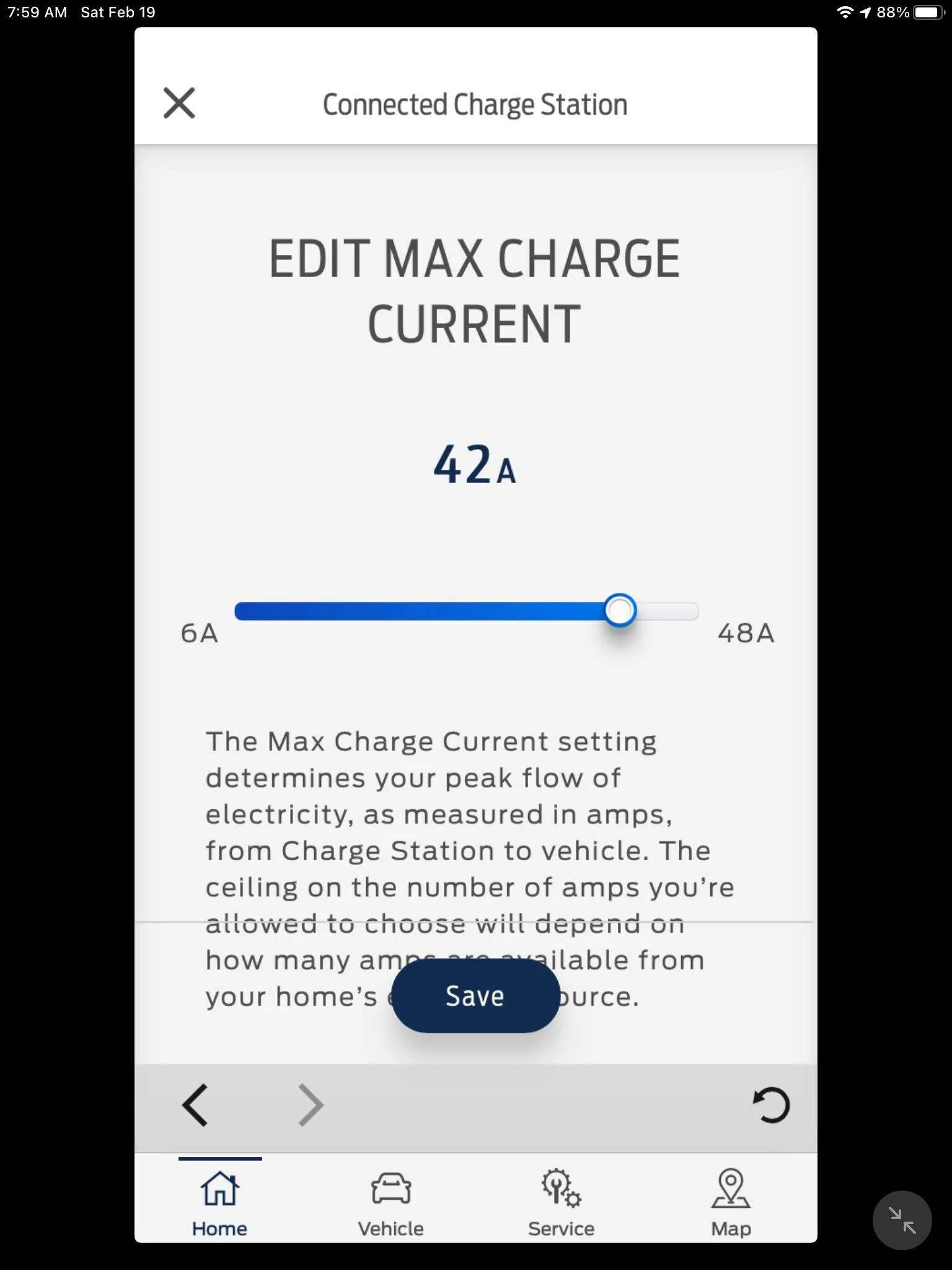

Yes this works but could be risk if plugged in, charging or preconditioning and the users dip switches are wrong. If you do not have a meter or electrical knowledge do this.…..But unplug your car first.
Here is what mine did and it confirms the 24AMP settings via the new Ford Manual Addendum is indeed correct.
Any set point I attempt above 24 AMPs gives this error message.
