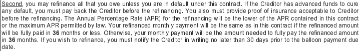

I've been trying to confirm this. My dealer says no but I had thought somewhere on the Forum it said otherwise. I would love for my balloon payment be financed for 3 years at 1.4%
Maybe. It depends on your contract language and what happens at the time of refinancing. You'll want to read your contract before signing.
Some may be like this example:
Ford Mustang Mach-E Ford Options Questions 1637091248082
Others may be like this example:
Ford Mustang Mach-E Ford Options Questions 1637091293468
