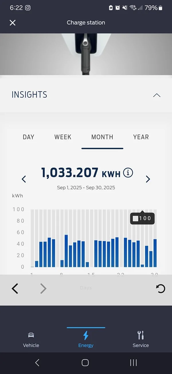

To give some context why I don't want a dumb charger, and why this is such a big issue, my utility company offers an ultra low overnight charging plan, 2.8 ¢/kWh rate from 11 PM to 7 AM daily, otherwise it's 12.2¢/kWh. That's literally over 4x the cost to charge.
My charger pulled over 1000kWh last month, and that will be going up as it gets colder now. that's the difference between $122 and $28 a month. That's why I'm frustrated. Because fords software bugs were literally costing me an entire phone plan outside of plugging my car in manually at 11pm.

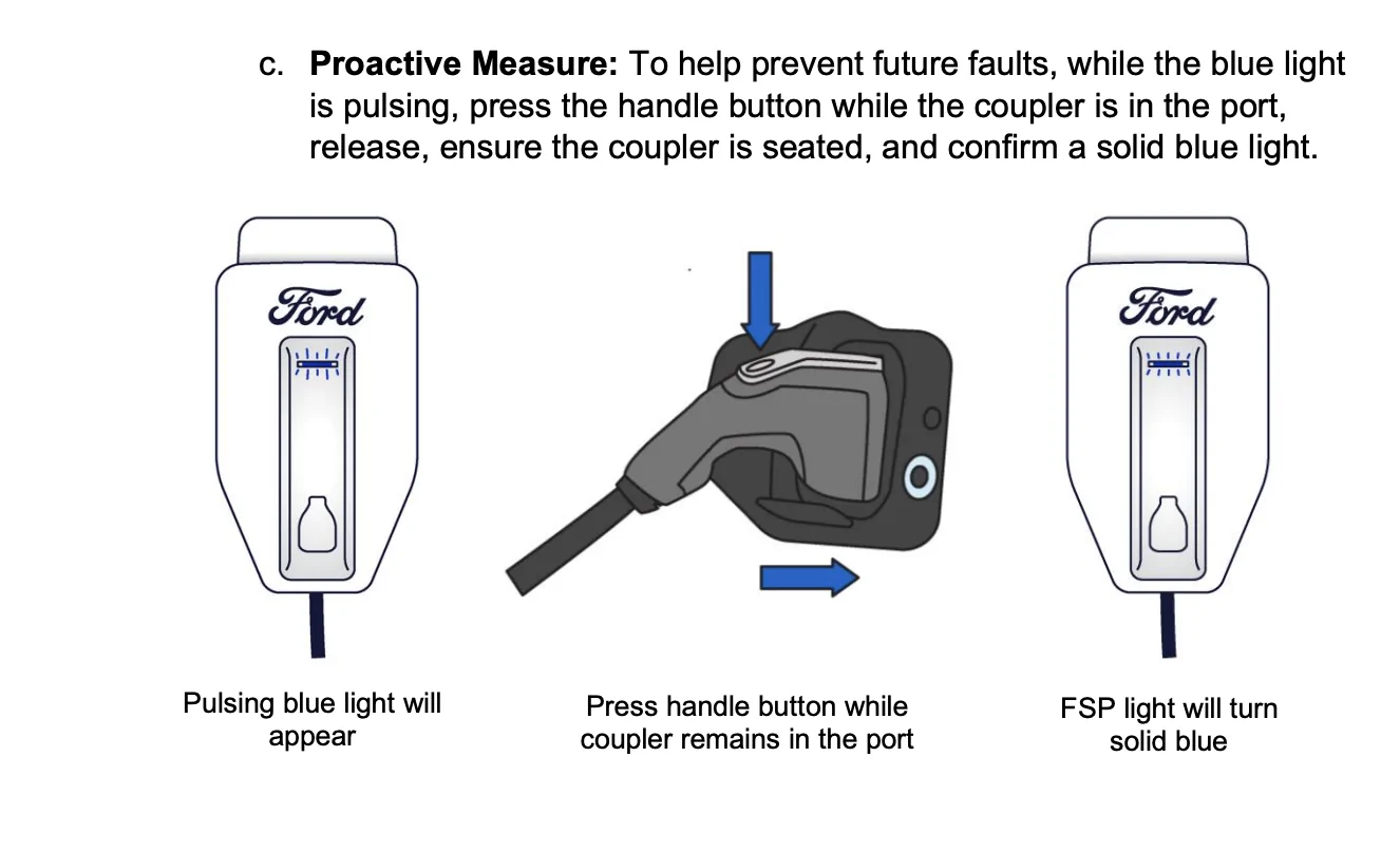

Software
See attached (and below picture) – Ford engineering team is aware of the issue and is testing the solution now. It will require an OTA to charger – so make sure you charger is connected. From the previous timeline I was provided, it shouldn't be far away.
Below is what I do every time I plug in to avoid this situation in the meantime – I hit that button twice every time I plug in and I have not faulted out in several months. It will usually fault out in less than 5 min, if it does.
Are there people just jerking this out without hitting the button? That surprises me.
