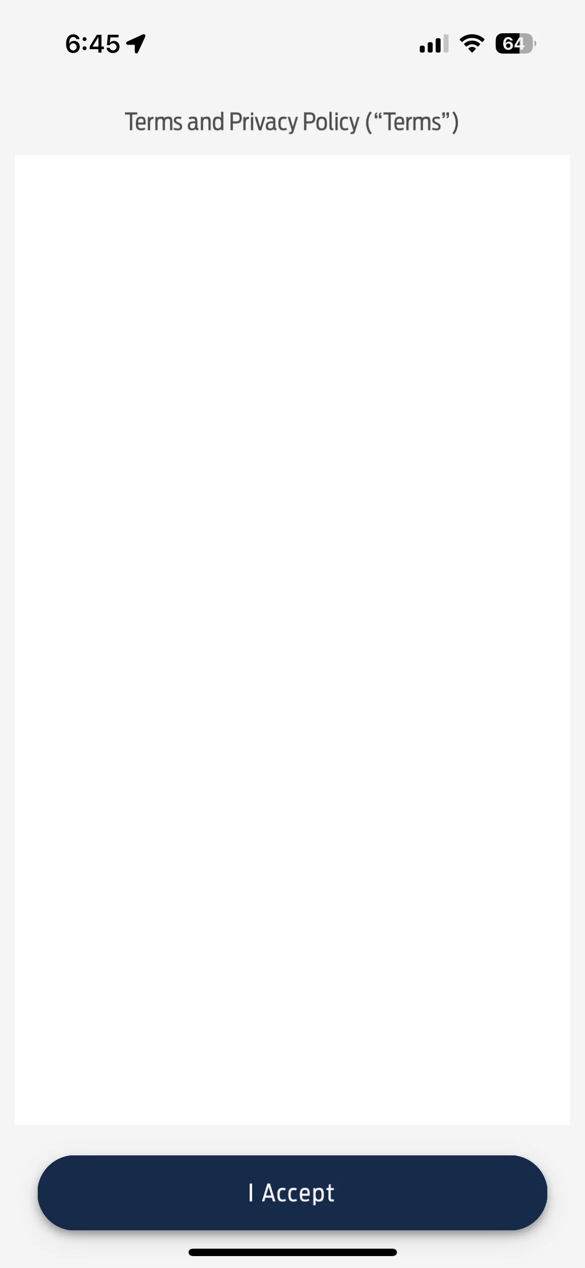

Anyone wanna hazard a guess as to whether this gives Ford no access to my data or infinite access?
Ford Mustang Mach-E FordPass 4.23.2 released for iOS IMG_2980
(Yes, this is a real FordPass 4.23.2 screen that magically appeared when I opened the app this evening.)
