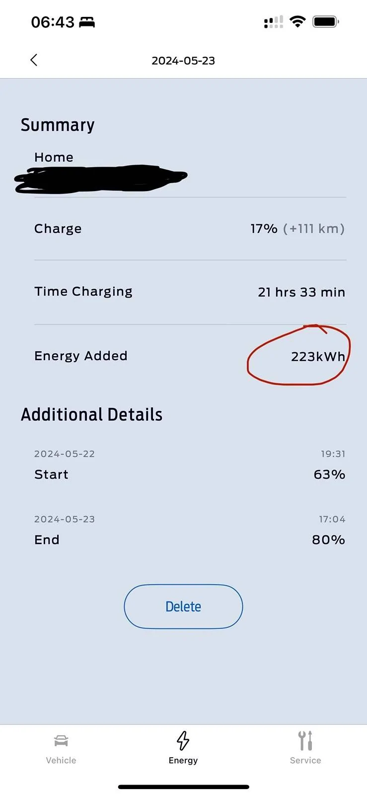

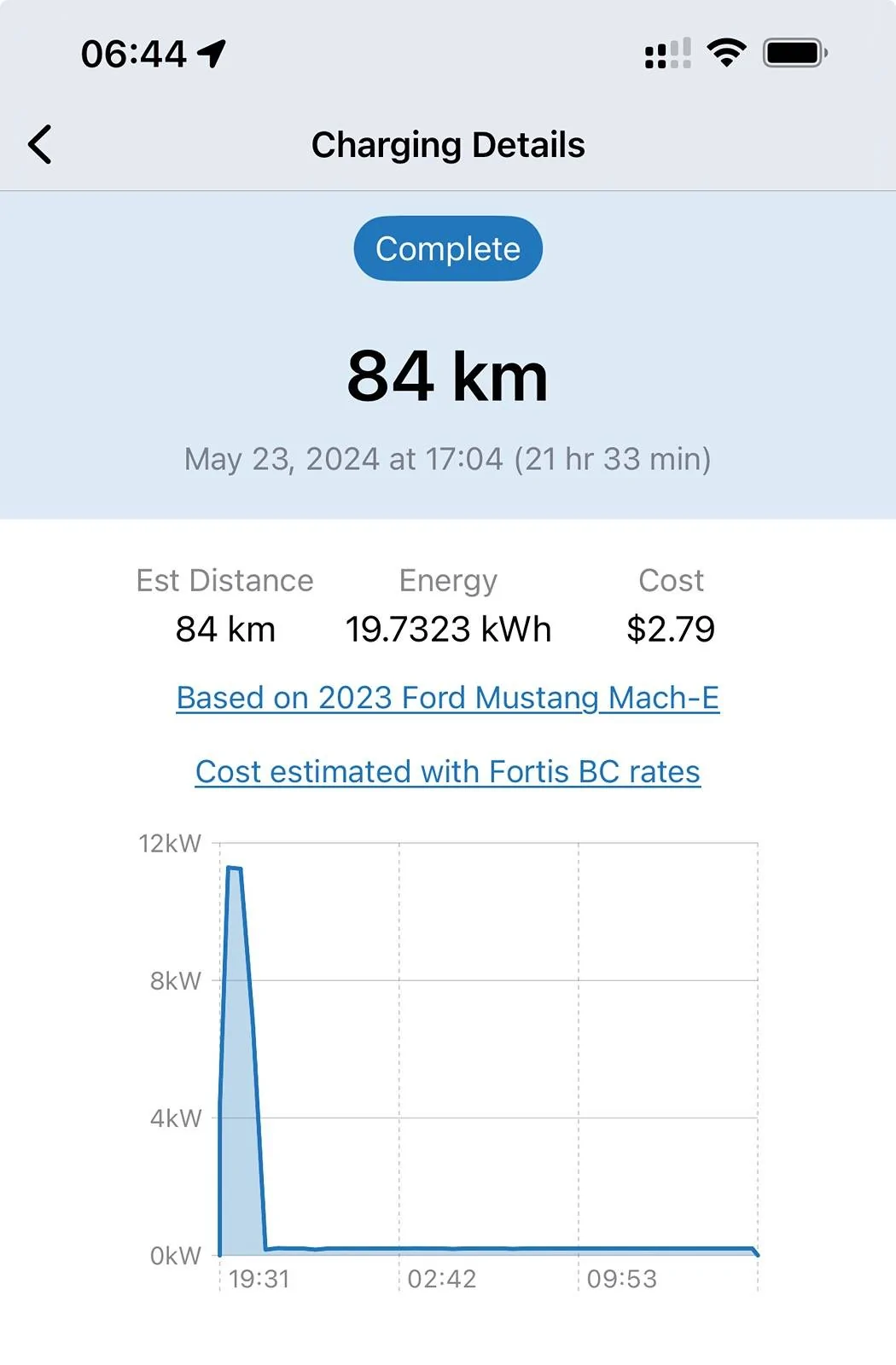

Anybody notice the charge history has the wrong kWh on recent days? It almost seems they got the decimal place wrong. Says it charged 223kwh for 17% !!! My ChargePoint history helped me confirm the obvious, that this is in fact NOT true. ChargePoint on same day confirms 19 kWh (same plugged in time so I know it’s the same session) which is much more appropriate .
ford pass:
Charge point:
The old version of the app would have this bug for me also. It just assumes some rate of charge and the number keeps ticking up until you unplug. (Even if your charger says it isn’t charging)
Though if you have a 23 MME you should double check that your blue charge light is actually turning off. Because you may have a bug where it is never actually disengaging the charger.
Will check when i next charge - however, if thats the case, how is the bug addressed? Whats odd though is that the car remains plugged in with an 80% limit and it does stop there .. so assume it is disengaging?

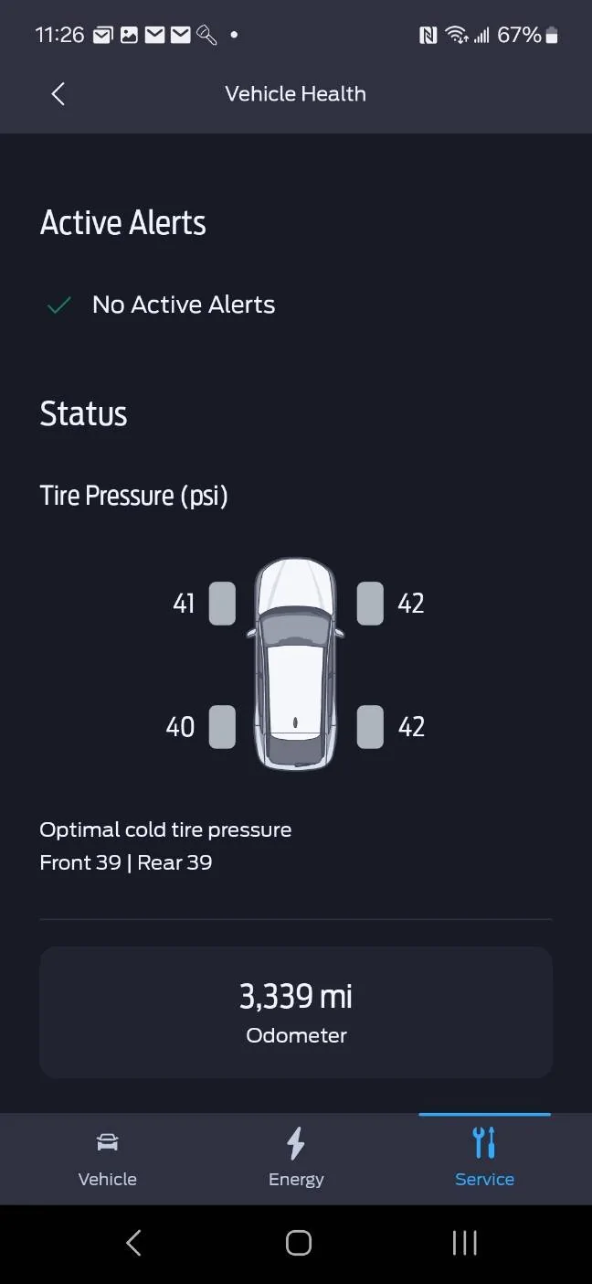

The Control button showing is for offline capabilities tied to BLE + Paak.
As for the skeleton/placeholder states, this is all connectivity driven. If this doesn't load, there's likely some sort of communications issue happening with your vehicle. This could be wifi, cell, vehicle wifi/cell, vehicle permissions, or anything in between.
This looks like the Android app -- so not my cup off tea on all the issues that could happen locally ?
There seems to be many issues with Android and it looks like your partial to iOS. It looks like there was little testing on Android especially the maps.
If your blue light is staying on after charge is finished you’ll have to take it to the dealer and they update some modules. Just point them at: https://www.macheforum.com/site/attachments/tsb-24-2094-pdf.120061/
If your charging light is going out, it’s probably just a bug in FordPass. Mine is currently doing the same thing, while I can login to my charger and clearly see power isn’t being drawn.
