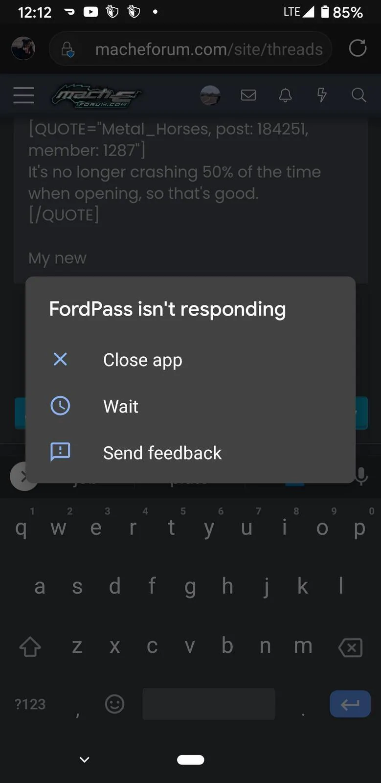

It's no longer crashing 50% of the time when opening, so that's good.
Previous releases ran okay for me, other than battery drain and poor layout choices.
This version is causing OS notifications quite a bit, even while I'm trying to reply to this post.
And when I'm running the app, it freezes for a few seconds while waiting for it to receive its backend data.
Ford Mustang Mach-E FordPass 3.23.0 Released Screenshot_20210602-121202
Weird. Mine seems good, but haven't used it much yet
