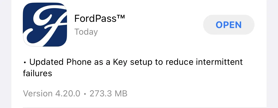

placing phone on charging tray works way better than back pocket. ;)
However, after about a year of great luck with PAAK, it started failing a couple days ago for me. I initiall thought it was FP 4.20.0.... but turned out to be a frigging update of my PHONE operating system that screwed up the phone-car BT connection.
Long story short, I fixed it this morning by:
- uninstalling FP from phone
- deleting existing pairings on phone to MME and PAAK
- resetting PAAK in MME
- deleting phone from MME
.... and re-installing and setting up PAAK like it was a new car
Took me hours to figure out it was the frigging phone update that killed it, but it works fine now.
