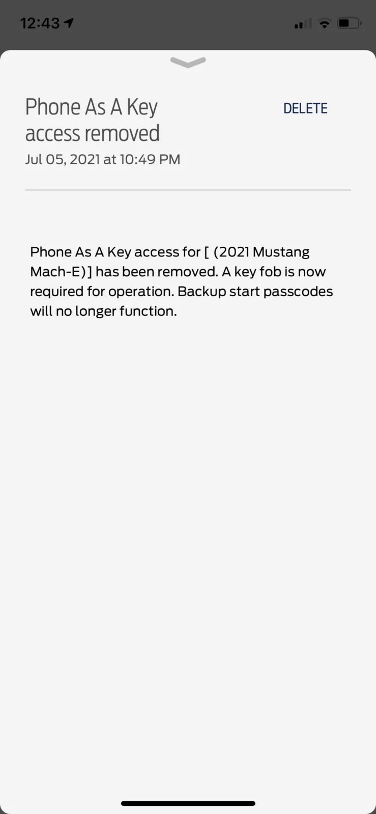

Also this was just emailed:
Your Phone As A Key access for your 2021 Mustang Mach-E 2021 2021 Mustang Mach-E has been removed due to an account update or a vehicle-reset action. Drivers are no longer able to use this backup start passcode to enter or start the vehicle. A key fob is required to start this vehicle. Backup Start Passcodes are no longer valid.
If you own this vehicle and this notification is unrecognized or unexpected, please contact a FordGuide.
Ugh. It's a good thing you are not without your key fob right now. ?

Has anyone have this happen? The PAAK was deleted somehow by car or
FordPass app on its own. Now it is unable to add back.
Maybe have to reset and start over again but if this happens when you are out without fob, could be a major issue. It also deleted backup codes.
I had the same thing happen this morning. PaaK removed, and now the FordPass app isn't updating.
How did this happen?
I am going to turn off auto update until I see more news on this !?
Not sure. Supposedly there was an OTA update released in the last few days? Maybe that did it, or could be some backend problem with FordPass. Since my app won't update, I'm beginning to wonder if it's a server-side issue.

My FP auto updated to 3.25 a couple days ago... PAAK and backupStartCode still seem fine.
I am wondering if the people that have had their p a a k functionality removed did any kind of Sync reset or uninstall reinstall of FordPass that may have wiped out their PAAK configuration?
FP, PAAK, Sync are 'working' for me pretty well now. Only thing not obviously not 'updating' remotely is the battery% displayed on FP Vehicle tab... but it updates when FP connects when I drive, so no biggie.
so.... for now, I think I will turn off auto-update on FP because I sure don't want to lose my PAAK settings and BackupStartCode!
Been off for a week. Hardware and software are both function well so off the train for a bit.
Did you ask them that? That notice reads pretty definite and there you go o_O no sugar coating for explorers. I think servers are involved and they may have had an unscheduled down a while back. I would definitely be interested in the outcome after you query them. Sometimes it is good to hold off on your set up until you are sure it is at your end.
Nope, didn't did any reset or uninstall/reinstall. What's weirder is FordPass says last updated was like 14 hours ago, and if I try to refresh it, it fails.
Same here. My battery now shows - - % Charge & - - Miles
hhhmmmm, that sounds like an incomplete FP update if FP is messed up. You might want to un-install FP, download and install fresh from AppStore?
If it is just the pull-down 'refresh' that is failing, that seems to be a bug in 3.25.0. Try getting in your car, turn car on, and THEN check to see if FP Vehicle tab updates range and battery % to match car.
