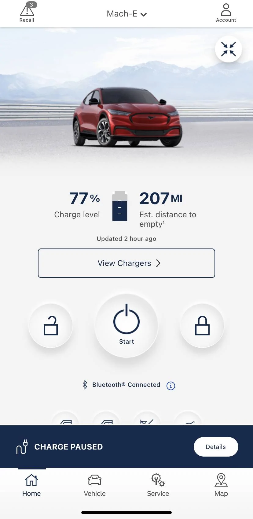

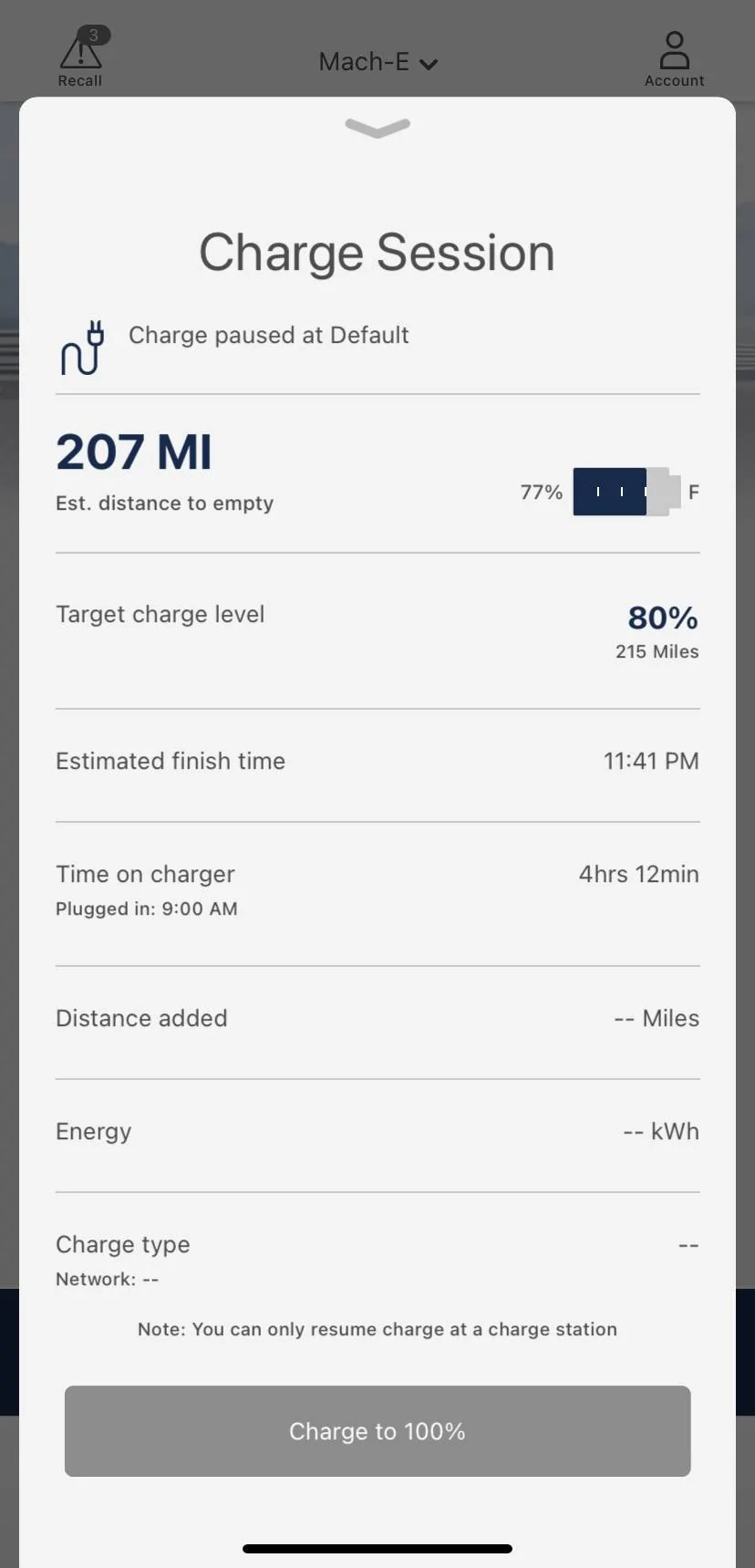

Mine last updated 2 hours ago but I see the charge to 100 button. I’m not with my charging schedule time so it’s greyed out.
Could always go into the car and update the location to charge to 100% if needed.

@hybrid2bev, yours may be grayed out because you're waiting for your charge window, but aren't at your charge level, whereas I am at 90%.

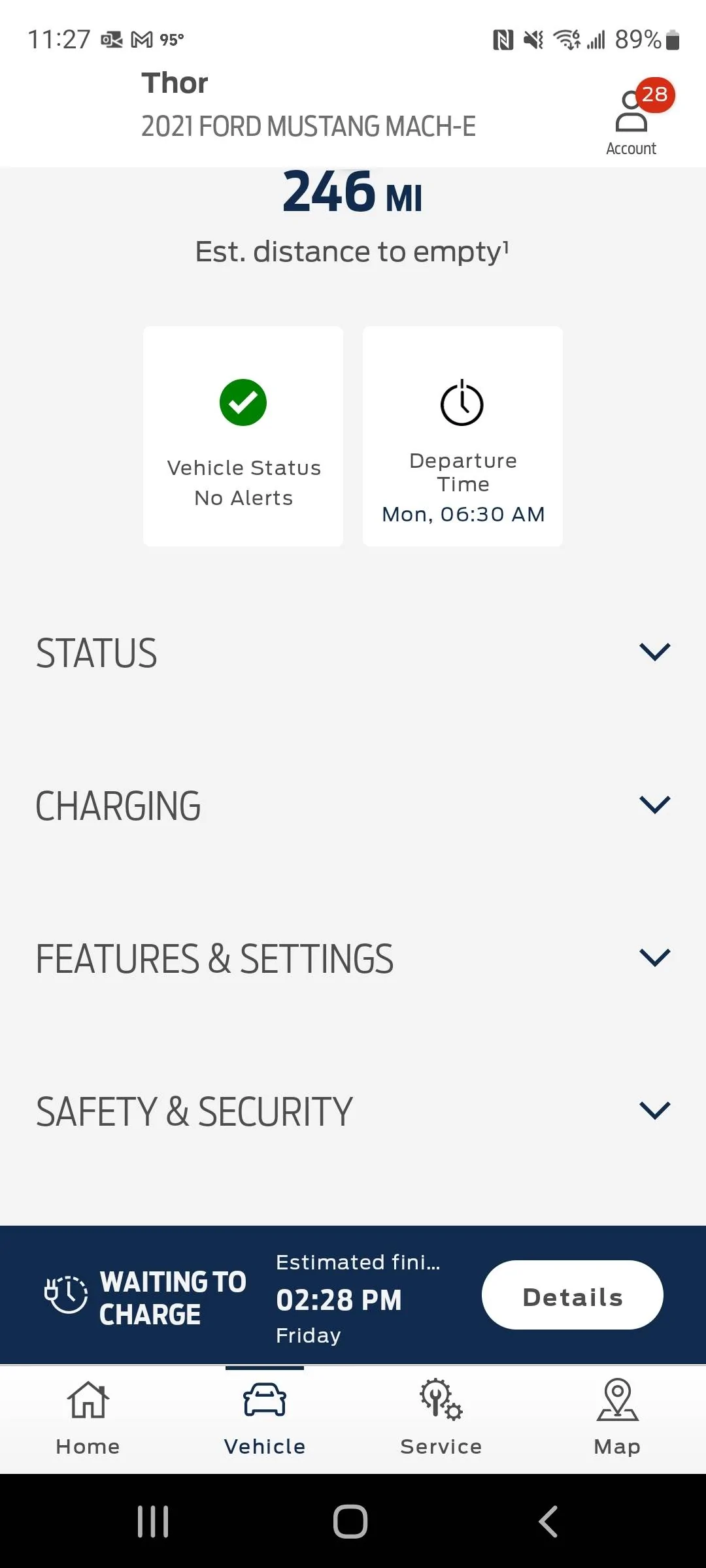

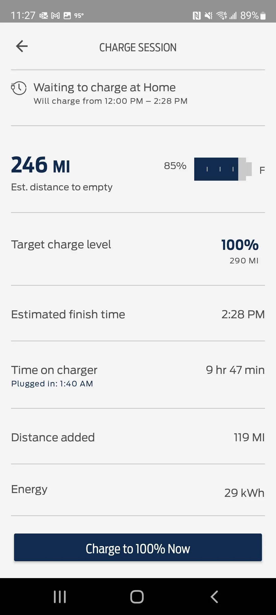

I have a long roadtrip coming up this evening. I plugged the car in 20 minutes ago in the garage. Tried using the app to charge it to 100%. No such option. The app still says "Updated 21 minutes ago". Pulling down to refresh doesn't seem to refresh anything - even though it's connected via Bluetooth. There used to be a dialog that would show-up when the car is plugged in that would let me override preferred charge settings, and charge to 100%.
At times, the simplest tasks with this car are beyond frustrating. I really don't know what Ford app engineers are doing with their time.
What I do to get it unstuck is switch from the Home screen over to Vehicle. Then the charging banner at the bottom refreshes and I then click Details. That gives me the working "Charge to 100%" function.
