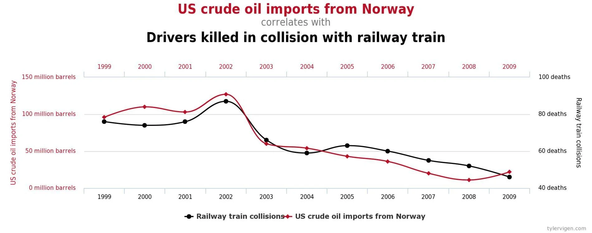

A few anecdotal reports are not necessarily indicative of the quality of the OTA. Plus correlation does not equal causation. I offer this table as proof of the latter:
Ford Mustang Mach-E FordPass keeps crashing - iOS 1628052419254
