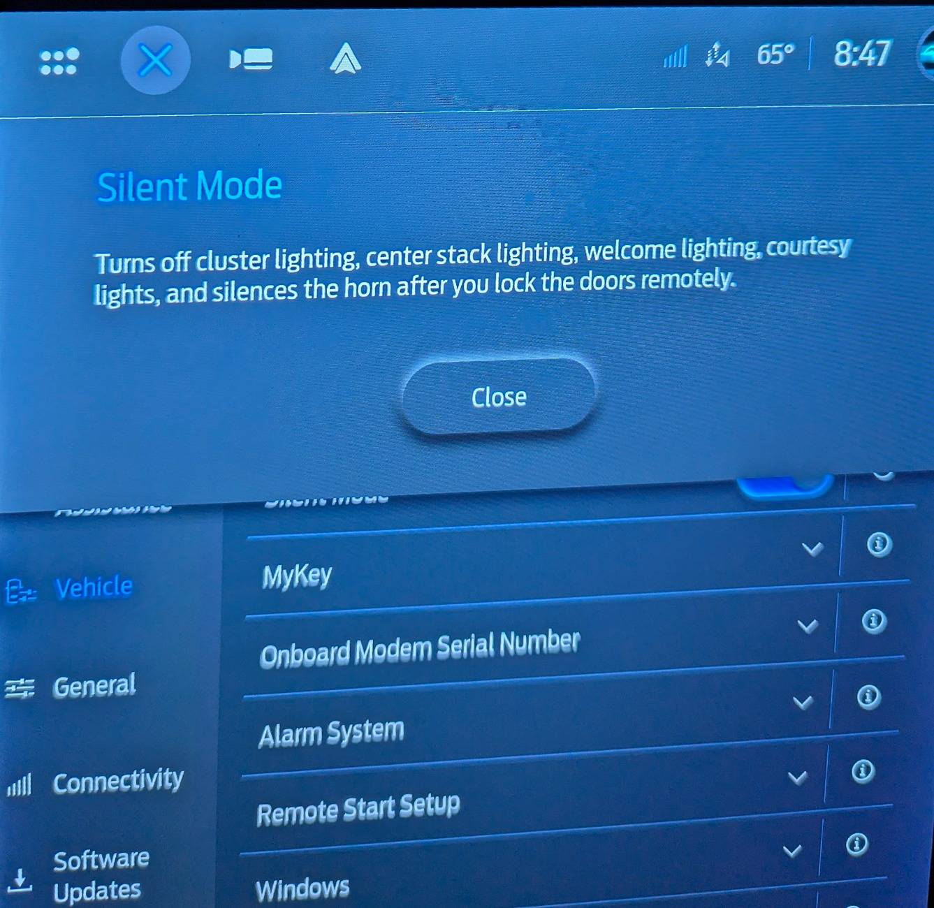

Can you expand on which ones actually did anything and what that was? Some seem interesting, like rear camera auto zoom, auto air refresh, sentinel, comfort pet
I haven't noticed anything specifically related to those yet. But Silent Mode does add a new option in APIM which basically makes the car completely silent and "invisible" - no lights inside or outside and no sounds when you lock / walk away ?

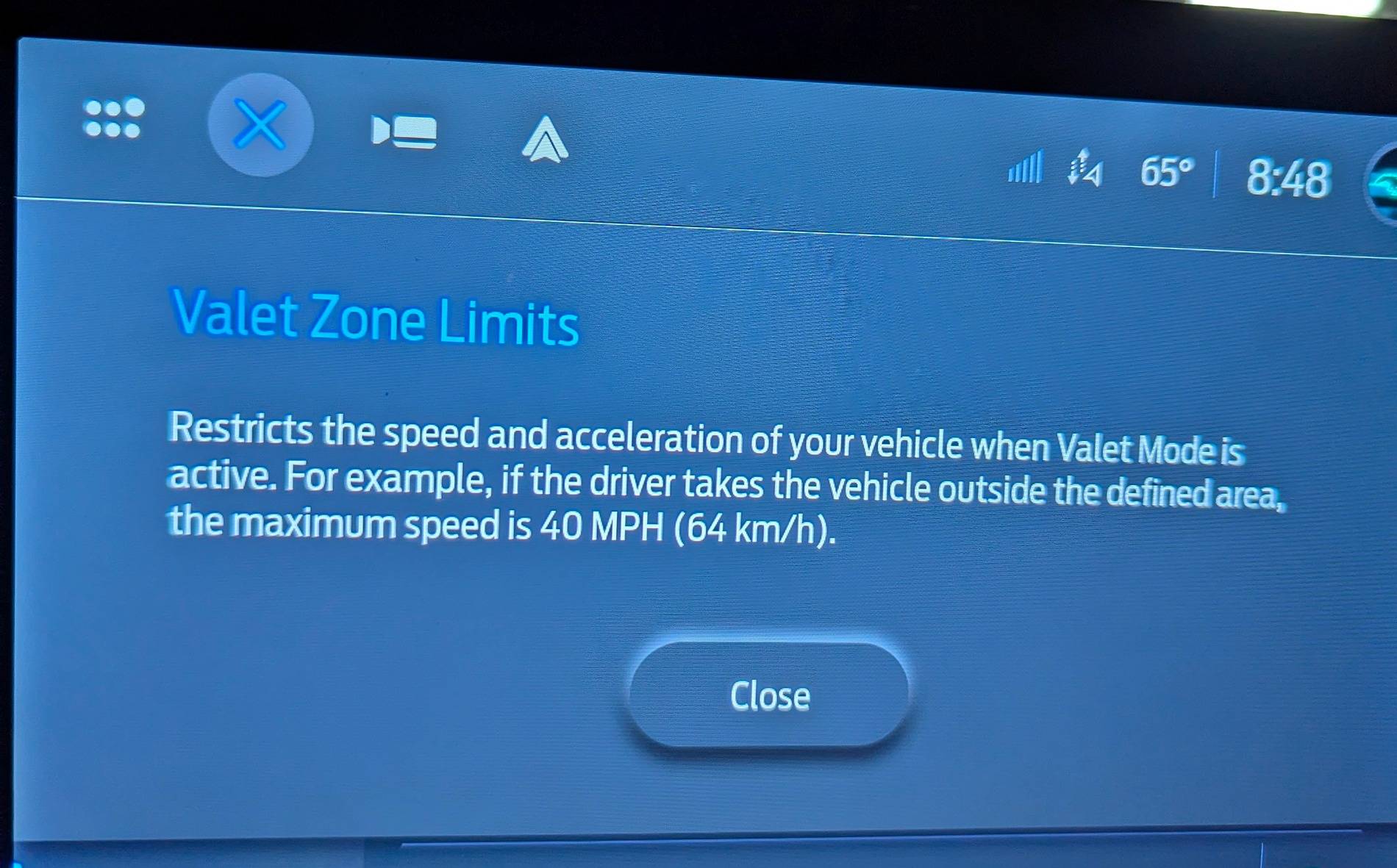

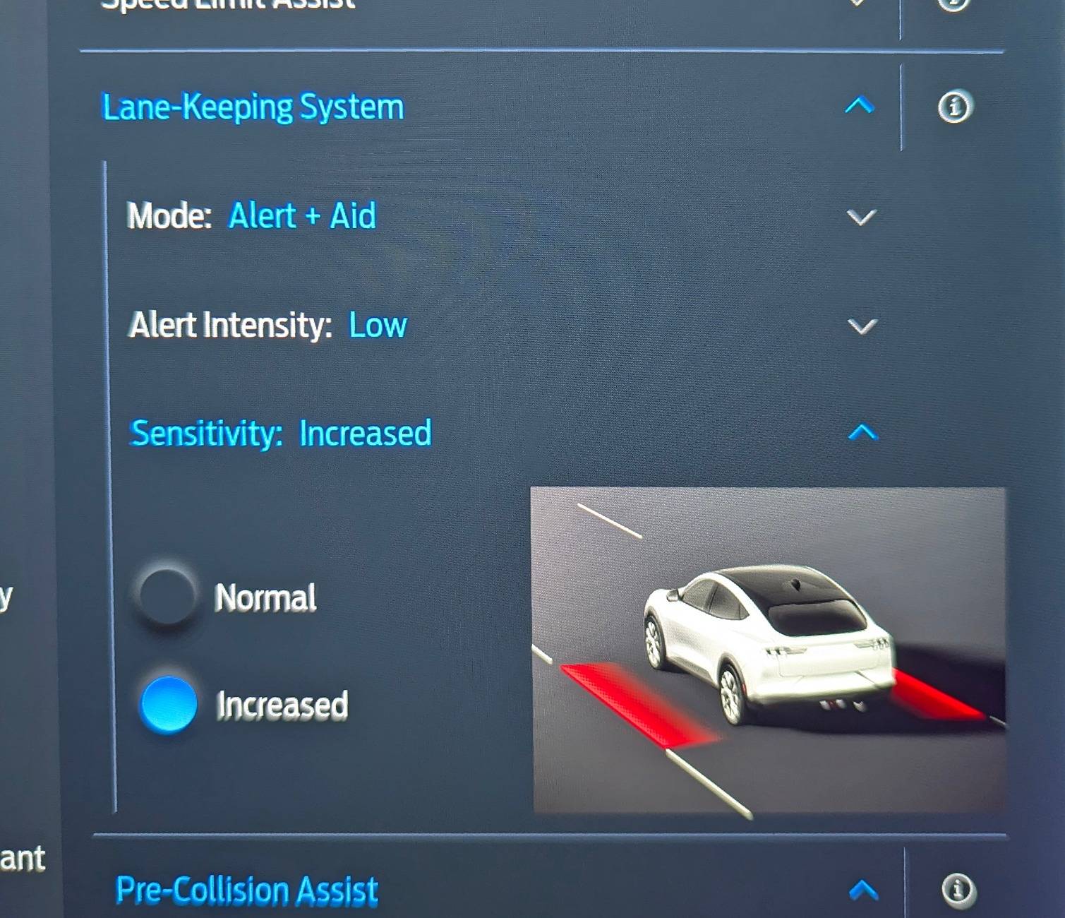

Also the reason I turned off the wireless charger is because I got the custom fit one from TWRAPS and didn't want it conflicting as it sat on top.
Anyway, here are pictures of the settings and results that I took tonight
Ford Mustang Mach-E Forscan *working* mods? 1000013544
Lane assist sensitivity

Valet geofence
Ford Mustang Mach-E Forscan *working* mods? 1000013546
