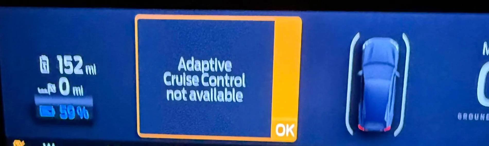

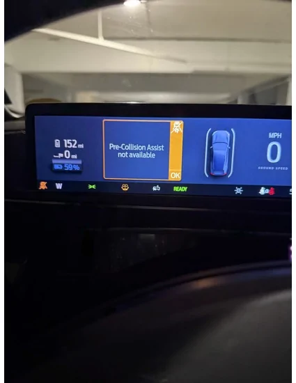

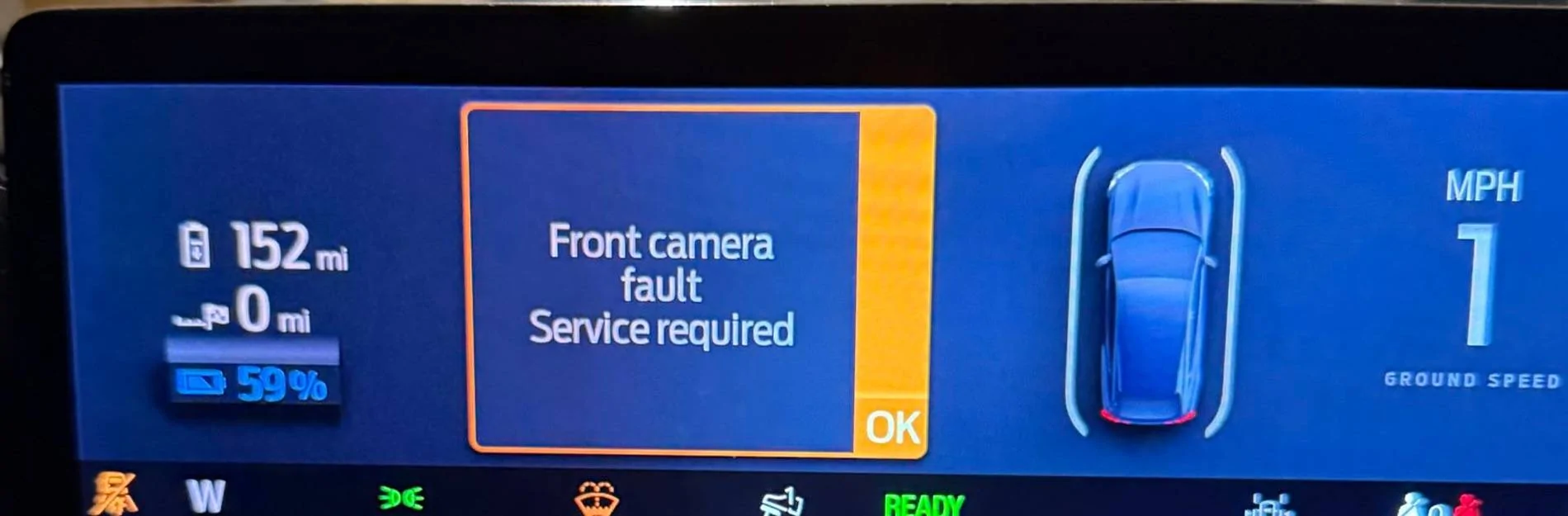

I own a 2021 Mach-E and have been experiencing the same issue that initially appeared intermittently. I brought it to the dealership’s attention, but they said there was no problem at the time. Unfortunately, the issue has now become permanent. I returned to the dealership (Autonation Ford in Margate, FL), and despite having the Extra Care EV extended warranty, I faced resistance from the service team.
I informed them about TSB 23-2155, but they insisted the module needed to be reprogrammed first. They estimated this would take up to four hours and cost me between $380 and $780, claiming it wasn’t covered under the warranty. They assured me that reprogramming should resolve the issue. Despite my concerns, I authorized the reprogramming.
Later, I received a call stating they were unable to reprogram the module because it was faulty and needed to be replaced—at a cost of $3,000, again claiming this wasn’t covered under the warranty. I firmly insisted they contact Ford Motor Company to get the repair covered under my warranty, as this is clearly a known issue. I also referenced posts from this community and reported the safety hazard to the NHTSA.
As a home health nurse, my vehicle is critical for my work, and I refuse to pay out-of-pocket for an issue that should be covered. I am extremely frustrated and would greatly appreciate any advice on how to proceed further. Thank you in advance for your help.
