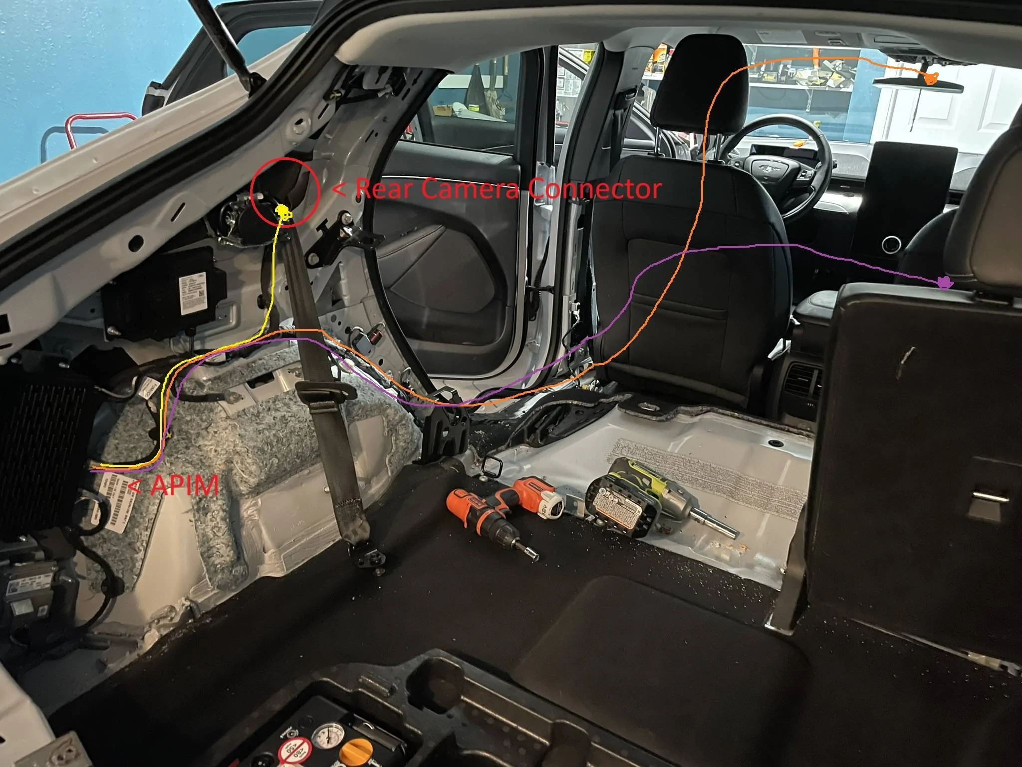

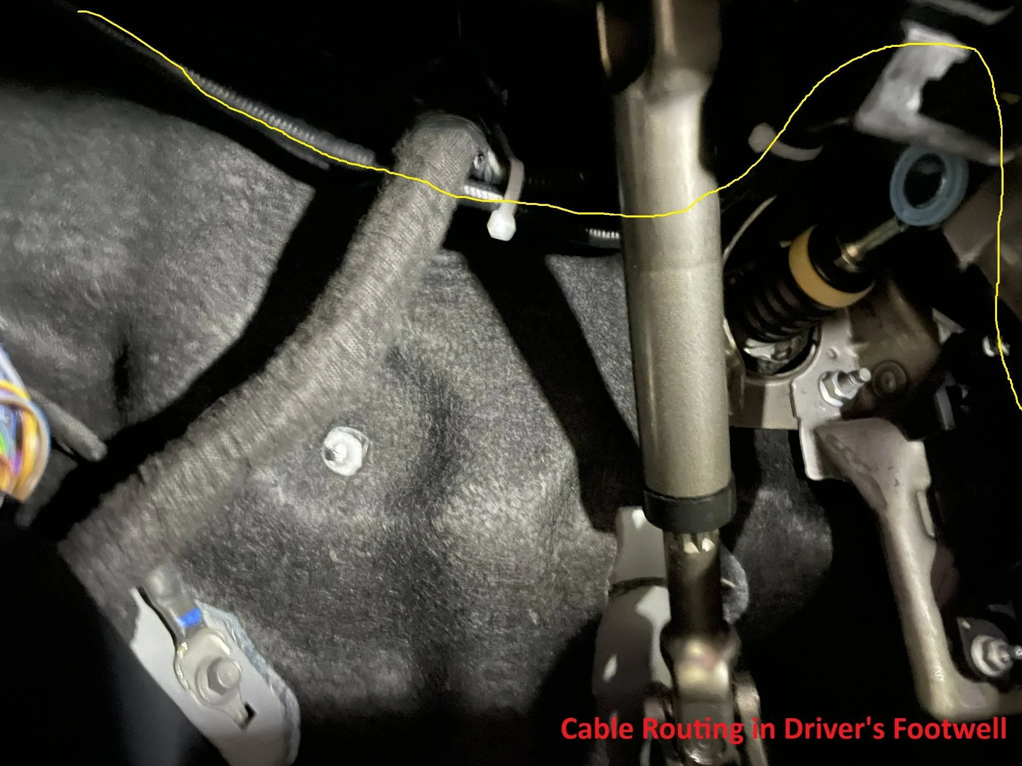

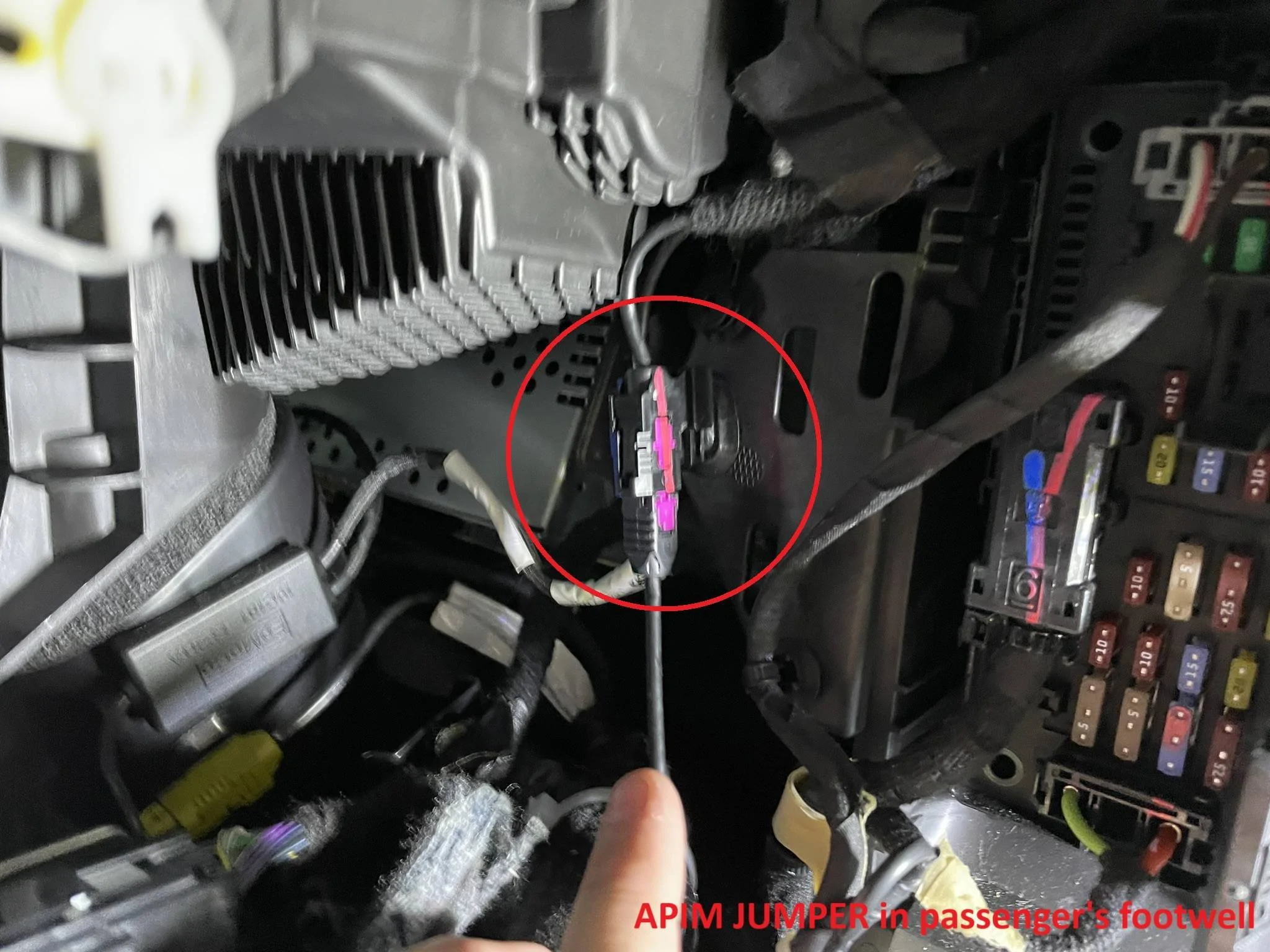

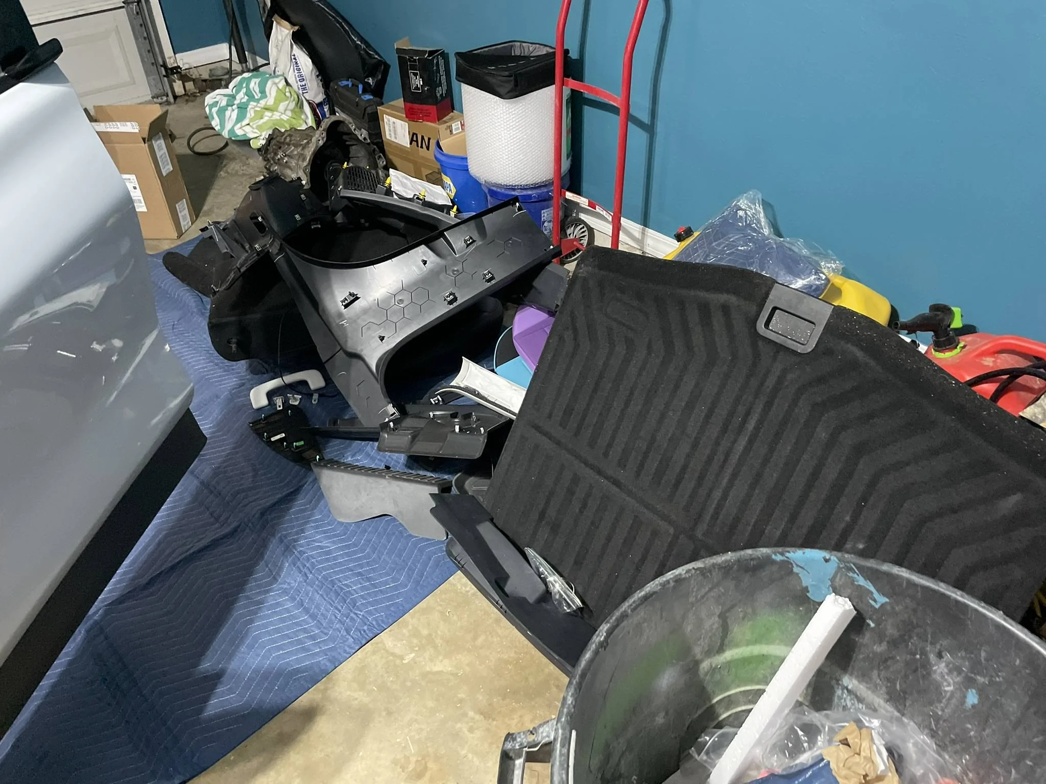

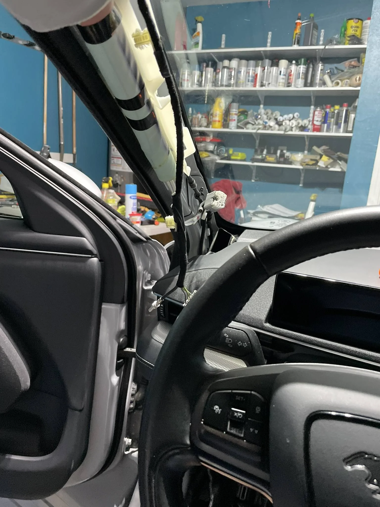

Here is my post from the other thread:
I did it myself, by my observation, the original front camera cable is in a state of tension, and if you follow each of the cables they are subject to a number of sharp twists. Furthermore, the instructions indicate that only some cars will have the APIM jumper, but near as I can tell they all will since our car doesn't have BC yet still had the jumper. Also, I used split loom cables under the dash.
Here is a photo Dump:
Ford Mustang Mach-E Front Camera Fault & Pre-Collision Assist Not Available Errors img_6990-jpg-
