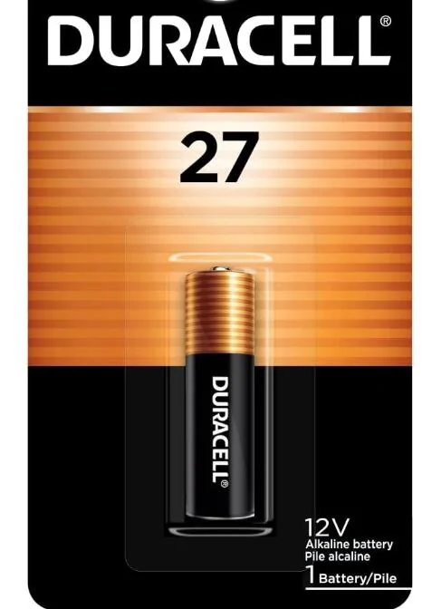

Will that work?
Ford Mustang Mach-E Frunk Bumper Release 9V battery does not work, 12V works 1739743894309-dm

Crazy stuff!! Back to the Dealership for me!! If that should happen!!!lol
