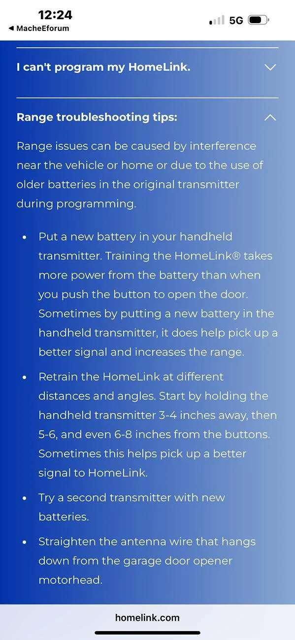

I put this in another thread. Can’t speak for the side buttons but:
Put a new battery in your remote to program Homelink as it will copy signal strength. Training the Homelink requires more power from the transmitter. A new battery will help homelink pickup a better signal and increased range.
I did this on my 24 and the range for me is easily 8 houses away with the center button anyway.
Is this a thing? I've been annoyed by programming garage openers for a long time and I've never heard or read anything that suggests signal strength is copied. I'm not saying you're wrong. But if you're right, that's definitely one of those ? moments for me.

It’s literally from the Homelink website.
I've gone over that site but I must have read through the tips too quickly. While it doesn't specifically SAY it "copies signal strength", it does infer that by saying "increases the range". How else could a new battery on a completely separate device increase the range of your homelink remote? Reading comprehension is an underrated skill these days. I appreciate the degree of hand-holding and patience you've offered to explain that. I'll have to try that and report back!
