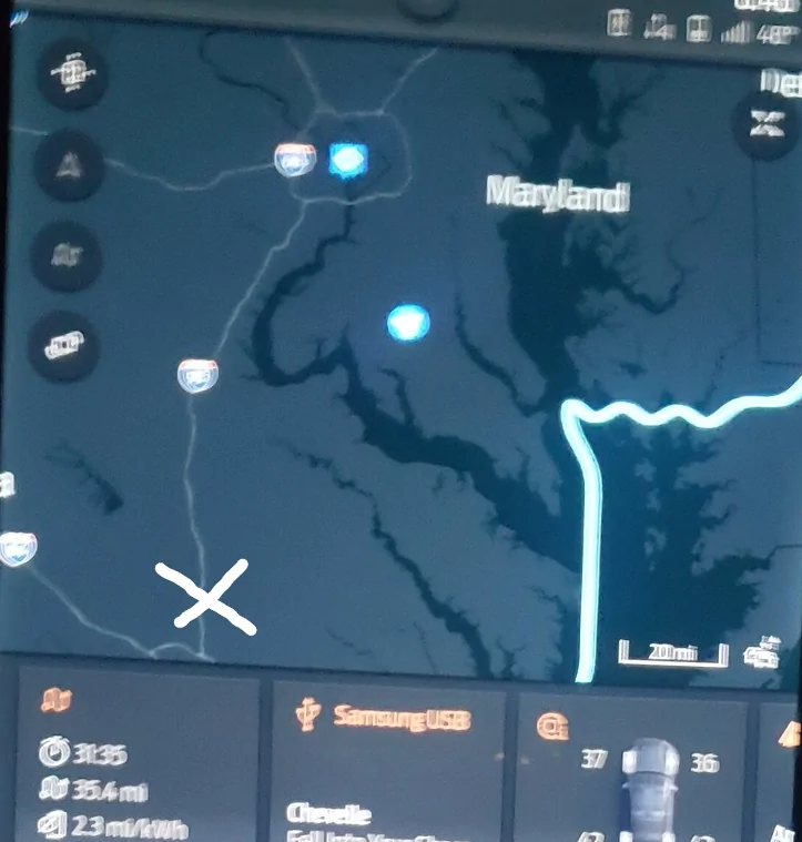

Same as Kirk. It has happened a couple times with me. Once I was driving home, and it showed me going off in into the forest and into a river, more than 30 miles away from where I was. Then it started going in circles through the river and the neighborhood around it.
Sometimes it thought I was on a 25 mph residential road, and my cruise control suddenly slowed down from 75 mph. I could almost predict when the car would jam on the brakes by looking at how my car was driving across streets and through houses.
I eventually turned off the cruise and now I don't even have cruise set to monitor the speed limit. I found the way the car responded to speed limit signs really annoying.
In the photo below, my car was actually on I95 South, where the white X is shown. BTW - it has not done that again - it was a one time occurrence.
