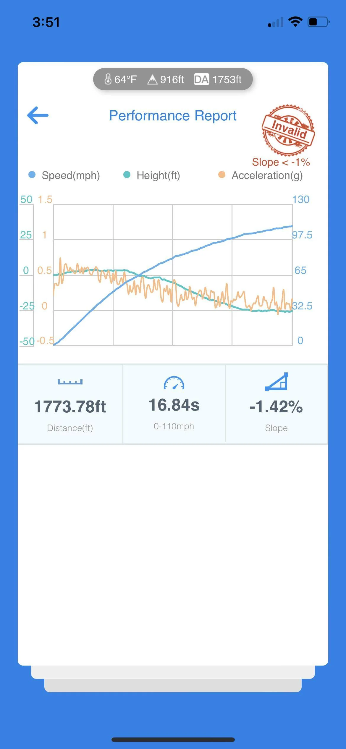

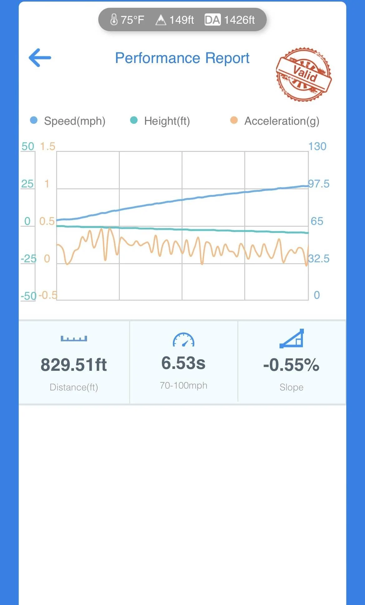

**EDIT** decided just to keep continuity in this thread for better or worse... Anyway. WHY am I doing this in this thread. Apparently there is no 70-100 pulls available for GT MME's, at least not here, so I bought a Dragy and set out to find a place to do such pulls in a completely legal way, except for "driving to an undisclosed road in Mexico" or whatever the YouTubers say when they break speed laws on roads. This can be consumed guilt-free! No need for public road speeding.
I am also SUPER tired, it has been a long (but fun!!!) day and I remember how much I liked autocross and drag racing. Super awesome time. Watching the tuner cars skirt around the cones, and watching the RC jet guys fly around, was such a rewarding time.

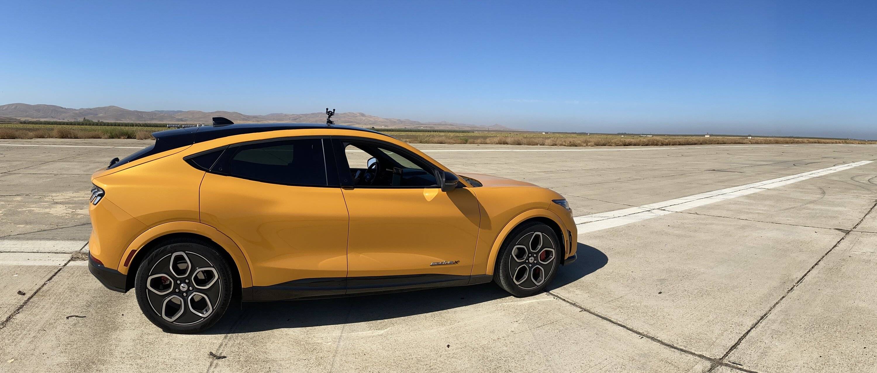

Back to the topic. So what I did was went with my buddy out to a decommissioned NASA test facility, in Patterson, CA where there are autoX events every weekend, with plenty of hoonigans all the time, along with RC planes and fighter jets and all sorts of cool stuff! It is a MASSIVE set of air strips, complete with the 7000+ foot primary runway, that is straight and pretty level (you'll see more later w/ the DRAGY results) and then taxiways and another runway that has been set up with cones, tires etc, as an autoX course. VERY cool, there is video from these events on YT and Reddit, if you wanna see it, worth checking out (not mine).
I imagined awesome space shuttles and stuff landing there in eras past and it felt amazing to be there!
We did a bunch of GoPro 360 stuff, I don't have a channel to upload larger videos to, so I didn't post any of those really awesome exterior videos. I ALSO have GoPro video of one of the pulls from 70-100 showing the instrument cluster in the event that someone wanted to see the numbers click up and the jailbars grow over time.

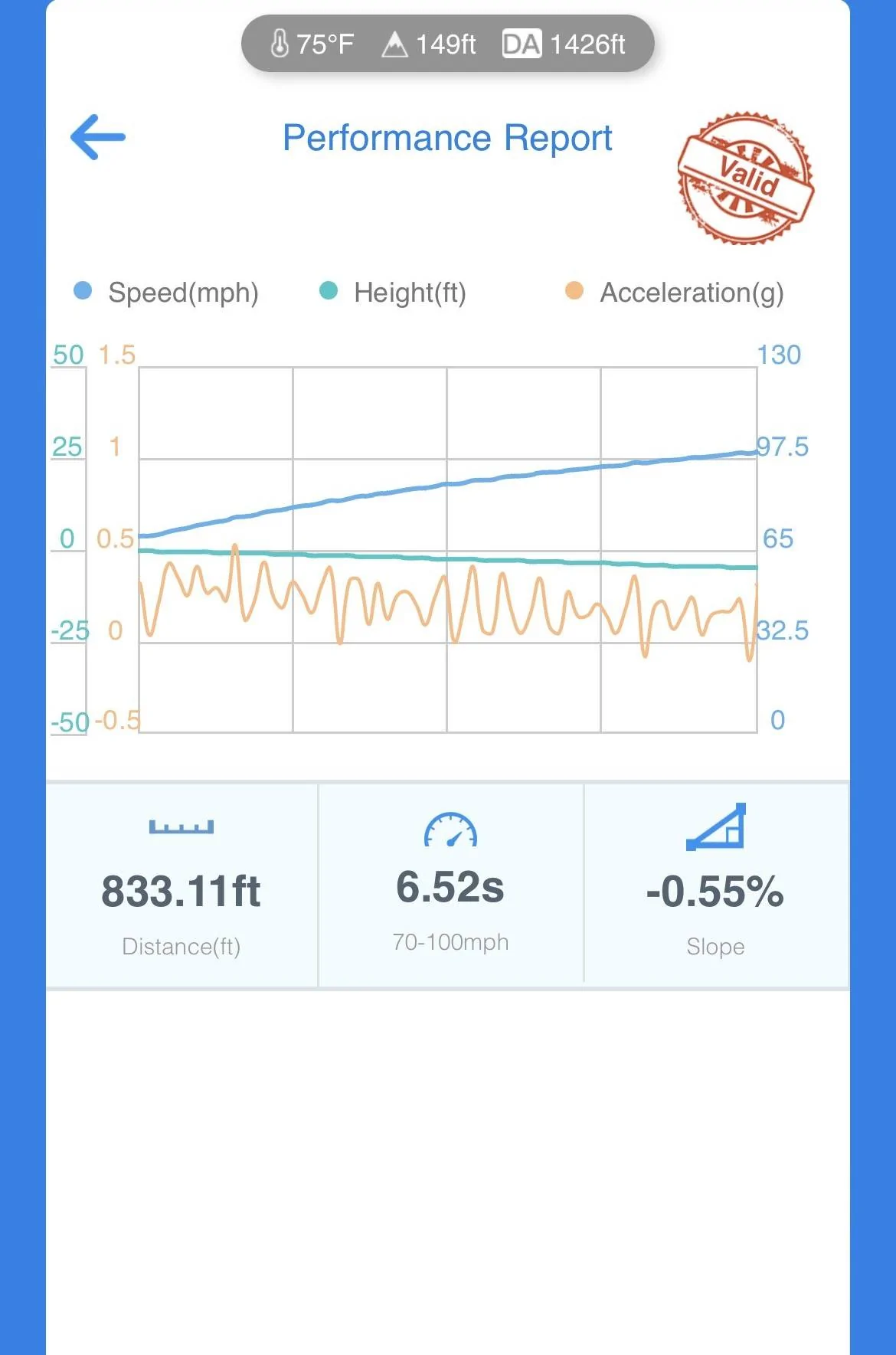

Methodology for the 70-100 run: I started at the end of the runway, and accelerated slowly and steadily to 70, then jammed it from 70-100 then let the car regenerate as it slowed down. It was cool to see the SoC going up as it slowed down and regenerated.
With that said, one unfortunate component of this test is that we could not hit the EA station on the way as it was *FULL* (shocker) so we had to do the run with a suboptimal 56% starting SoC. Temperature was great, not too hot, not too cold. Surface was very nice, as people routinely use it, and there are car clubs that appear to take active roles in maintaining it as much as people can.

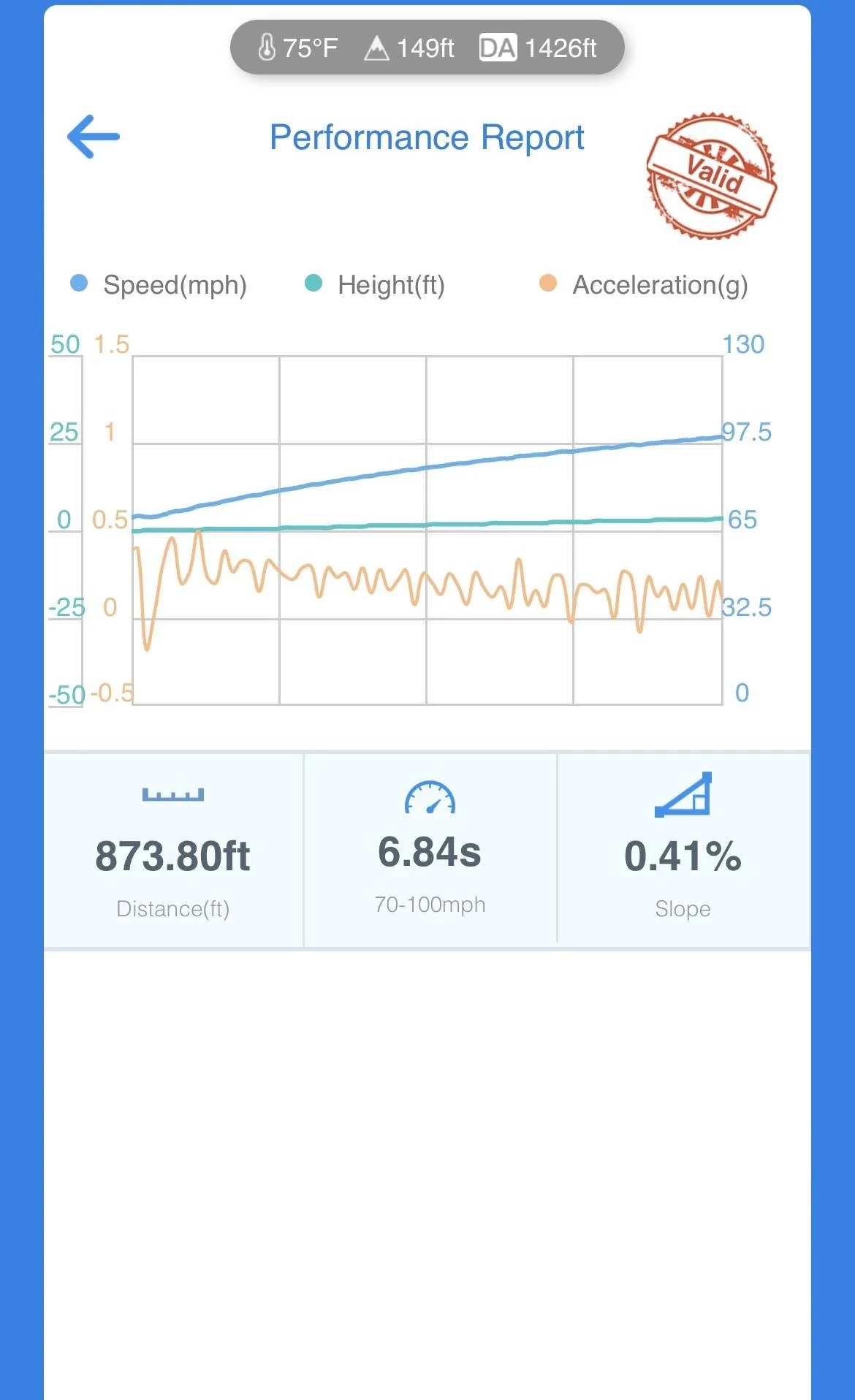

I noticed on the first run that there was a very slight slope of -0.5% so made sure I ran it back as well and then back the other way one more time.
Dragy is such a cool module. Unbelievable it is such an inexpensive tool for what it is capable of doing.
Run 1 - 6.52 seconds with a downward slope
Run 2 - 6.84 seconds with an upward slope
Run 3 - 6.54 seconds with a downward slope
I saw a European YT content creator show the OBD2 + CarScanner data on the screen and I feel like people like seeing it on the comments and such. Therefore, I decided to screen cap the CarScanner data as I did the very last run.
I had to be careful with the SoC, because I had a decent drive back home, and indeed, ended back at the barn with a REALLY low SoC, moreso than I was prepared to see! (13%, yikes!)
I ran one 1/4 mile test with my buddy in the vehicle, also on the "upslope" direction (0.40%) just to stack the deck against the car. The run occurred at the end before we thanked the Road Gods for the opportunity to drive there, and headed back out. At 51% SoC, it was a 4.27 seconds 0-60, 1/8 mile was 8.18 seconds @ 82.50, and 1/4 mile was 13.19 seconds at 94.83 miles per hour. The 5-second power down was palpable on wide open throttle which is, admittedly, difficult to experience on roads controlled by speed limits and traffic laws that aren't closed road courses.
All testing done in "unbridled mode" not that it makes a difference at all for the "standard" GT.
I hope that this is useful to someone. In the very least, it was a lot of fun, a good road trip with a friend I haven't seen in a long time, and being out there with a whole bunch of auto enthusiasts was incredible. I would like to do this again, in the same conditions, but 80%+ SoC like I had planned it to be.
Ford Mustang Mach-E GT / GT PE Dyno? Run 1
Ford Mustang Mach-E GT / GT PE Dyno? Run 2
Ford Mustang Mach-E GT / GT PE Dyno? Run 3

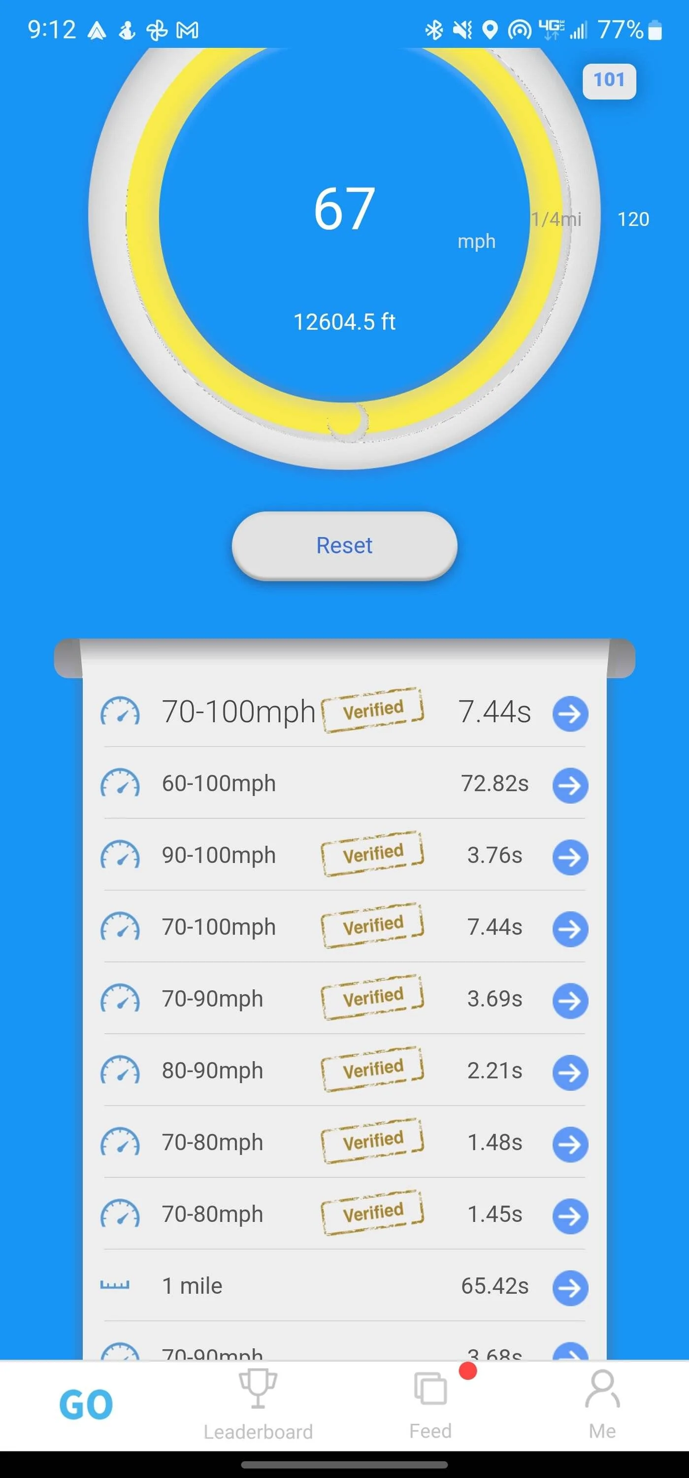

It's freezing out (about 37°F) but allegedly my car did a few 70-100 pulls from about 68/69mph. Approximately 75% SOC.
Ford Mustang Mach-E GT / GT PE Dyno? Screenshot_20221022-091228_dragy

Thanks for the detailed report. Crazy how much power it loses at 50% state of charge. 1/4 run at 94mph. Yikes.
