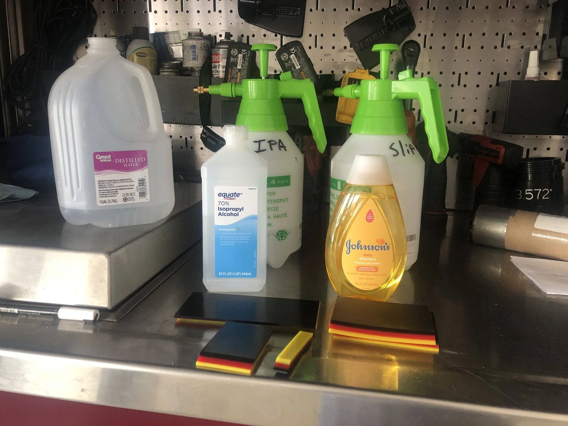

Attached is everything I used. 2 separate spray bottles one labeled "slip" and the other "IPA." The slip solution I mixed was 48 oz of distilled water and 8 drops of J&J Baby Shampoo. For the IPA/Tack solution, I mixed 8:2 distilled water and 70% IPA. I tried 9:1 but didnt get the tack i was looking for.
For the squeegees, i highly recommend the Fusion Hornet. I got a set from Tintdepot.com which came with .5", 2", 4" and 6". I don't think i used the 6" as i felt I had more control with the 4" in larger areas (doors, hood).
Best advice is take your time and do the flat surfaces first (B-Pillars are great for getting the hang of the process). The more advanced areas will be the bumpers and the hood as you have to "stretch" the film. I used the Suntek Reaction and was impressed with the thickness, holding power when trying to stretch and how strong it really is (i was really pulling hard at times especially on the front bumper).
Also, plan on having 2 people (at least) for a few pieces. The bumpers, hood and the "rear fender" pieces are quite large. Make sure you clean the area thoroughly too. Whenever I started an area, first thing i would do is clean with a quick detailer and a microfiber towel. Then spray with the slip solution. There is no such thing as too much slip solution. Also, i would spray the "tack" side of the film as I peeled it off the backing material. I would then line up 2 "fixed points" and then work the film from there. As an example, the piece on the bottom of the rear hatch has 2 cutouts for the threaded areas for the license plate. I would line those up, squeegee out the slip solution and that would be enough to be able to "pull" around the areas needed. The film would hold as long as the slip solution was squeegeed out. If you need some "assistance" that is what the IPA is for. Spray a little IPA solution and it will "dissipate" the slip solution and provide a quicker "tack." Also, i noticed if I sprayed the "outside" of the film where you run the squeegee across, it really helped "glide" the squeegee over the film vs it dry.

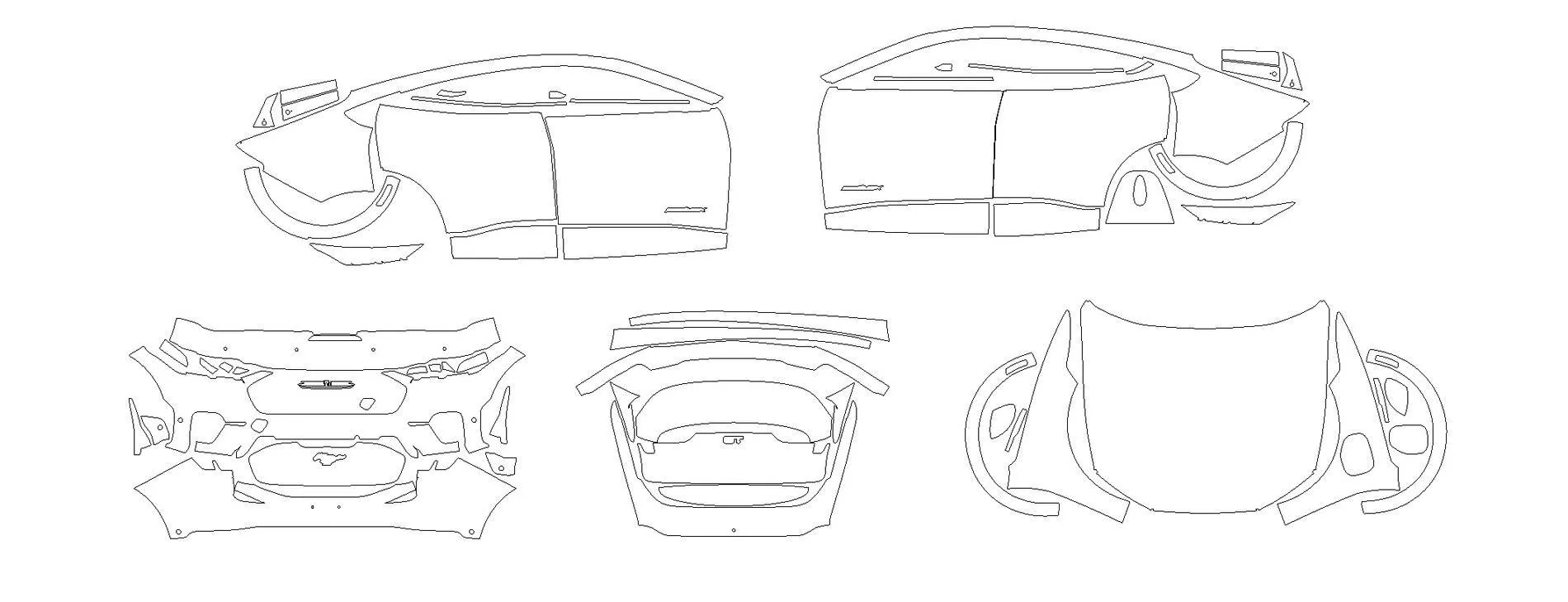

I just finished the whole car with the Suntek Reaction film. There were easilly over 50 individual pieces. Some small and some large (see attachment). Also, some pieces were left out and they are sending me the pieces as we speak. In all, it took me 2 long weekends plus 3-4 hours per day through the week to complete all the install.
Ford Mustang Mach-E GT PPF IMG_4687
Ford Mustang Mach-E GT PPF fullsizeoutput_b1d

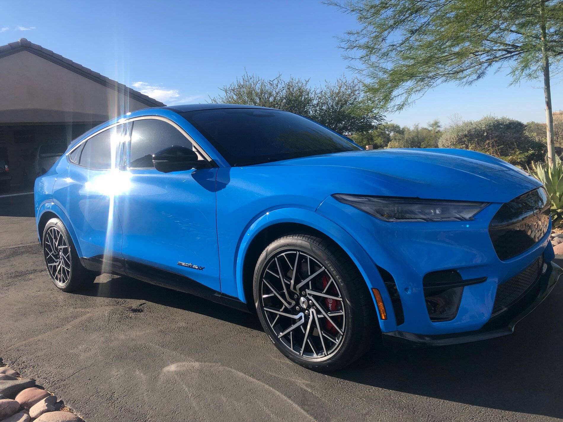

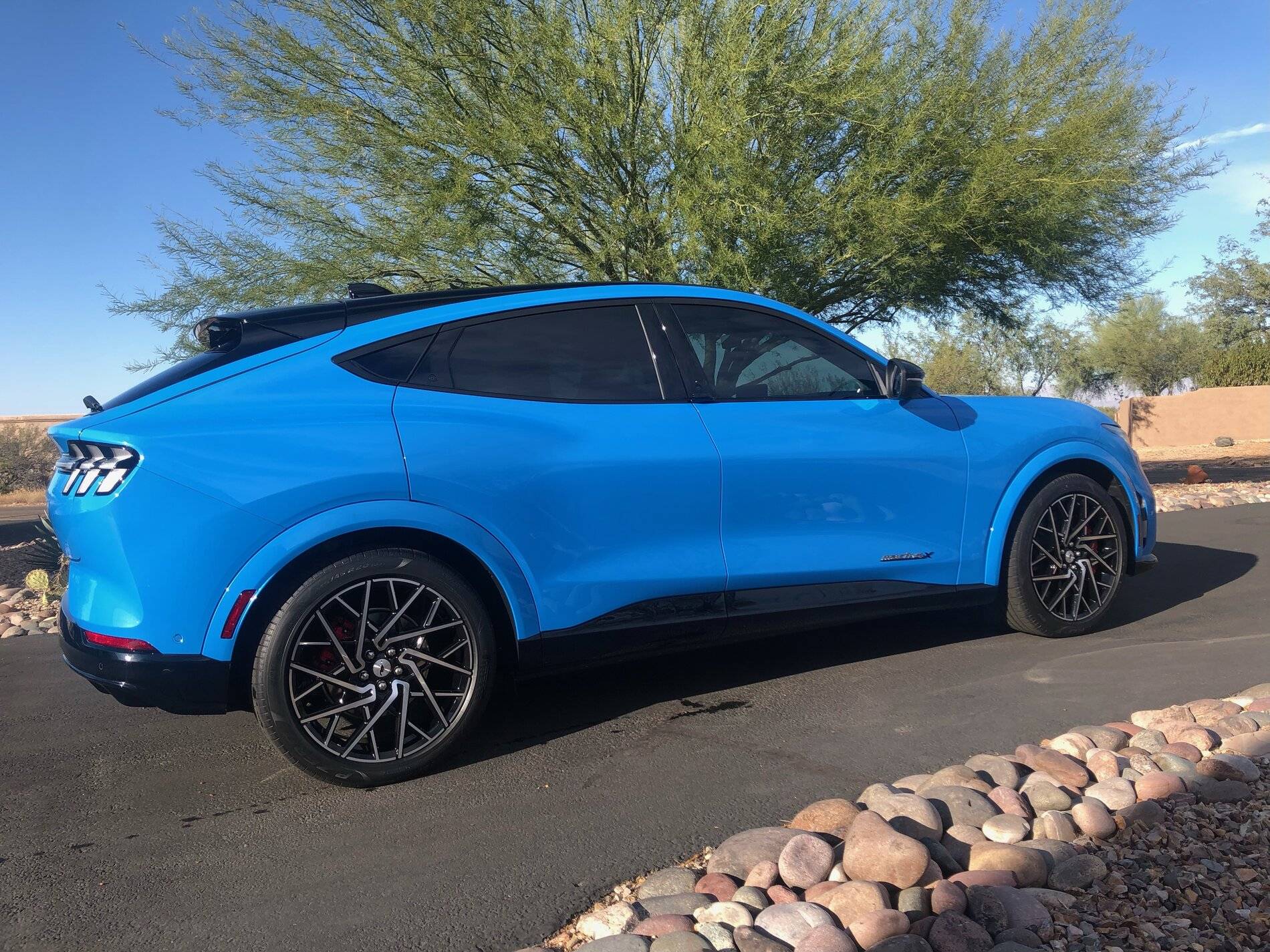

Final Product:
Ford Mustang Mach-E GT PPF IMG_3169
Ford Mustang Mach-E GT PPF IMG_3170
