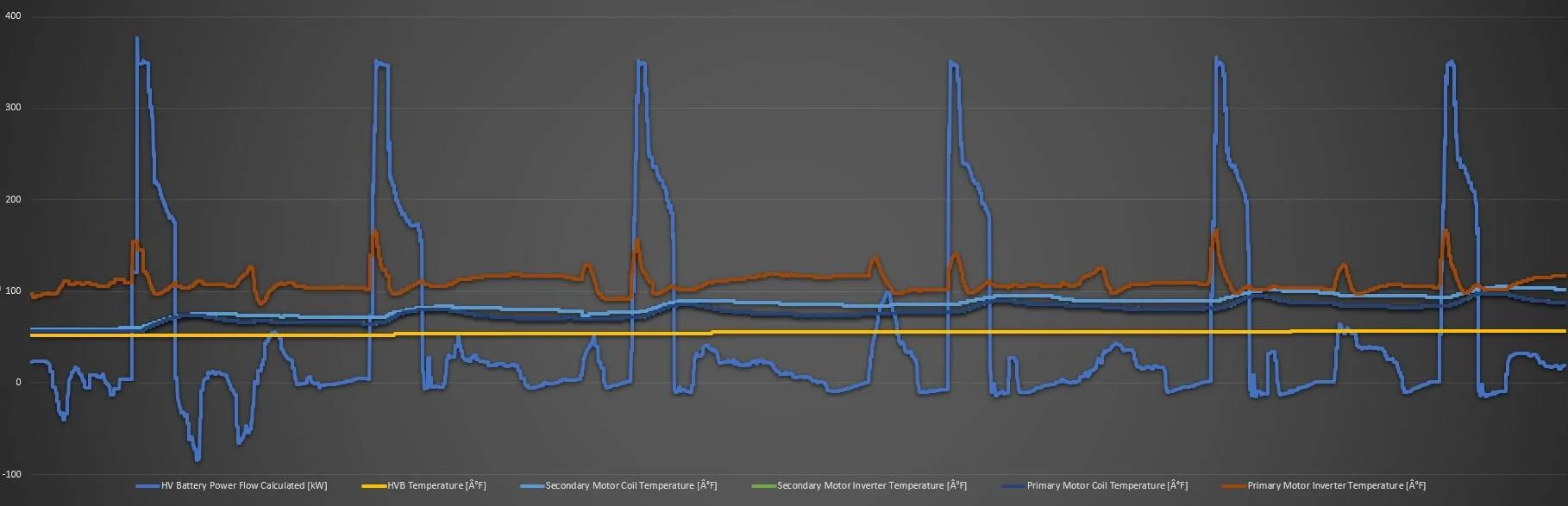

Sorry, but no.
You say things like “physics” and “simple fact,” but the reality is that you’re making this up to scare people……. And it isn’t true.
Heat is an issue, that is correct.
But risk of fire? Complete hogwash.
Here is a screenshot of the temperature readings during multiple back to back full throttle runs:
Ford Mustang Mach-E GTPE extra torque 54725E12-0579-4DED-8E2B-6EA79AB3330C
Your eyes don’t deceive you, that shows the temps spiking and then dropping even during the full throttle run. And the battery temp? Barely changes.
Again, heat is an issue. But we are nowhere even remotely close to a fire.
And……again…..the HVJB is a completely separate issue. Not GT specific, NOT related to the horsepower limit nor the 5 second limit. The regular models weld shut too if they got a “bad” one. No need to bring it up in this discussion.
You are correct though that “there is a reason” for the 5 second limit. Because Ford spilled the beans at one point: They don’t have enough temp sensors and they don’t respond quickly enough.
So we got training wheels because they weren’t comfortable enough to be sure that heat wasn’t an issue.
But that doesn’t mean that 5 seconds is the REAL limit before things break. They created a cushion. My bet is the cushion is significant since again, no GTs have broken due to acceleration.
TLDR; 5 seconds is the limit they gave us. But that doesn’t mean it’s the real limit the car is capable of before melting. And catching fire just isn’t a thing.
