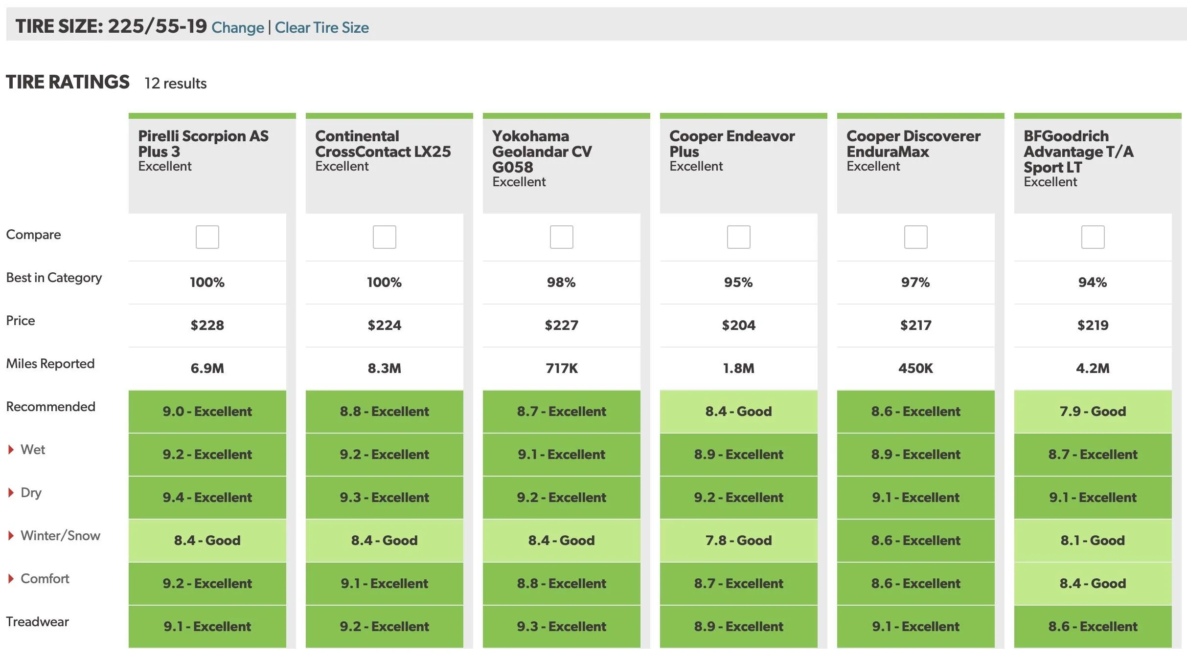

For the smoothest riding, quietest all-seasons I recommend the Pirelli Scorpion AS Plus 3 which is a SUV Touring all-season. Available in both the OEM 225/55/19 size or one size larger 235/55/19.

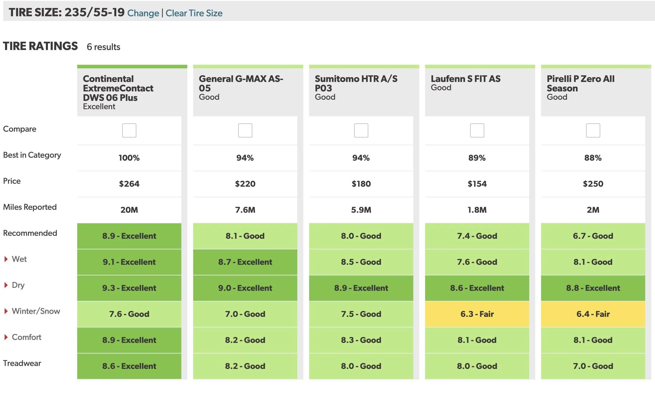

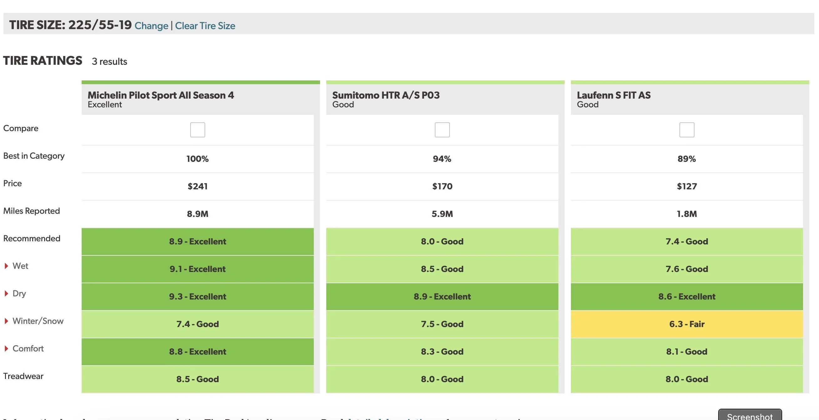

Going with a high performance all season tire in the 225/55/19 size my pick is the Michelin Pilot Sport All Season 4. If you went up one size (235/55/19) I'd get the Continental ExtremeContact DWS 06 Plus.
