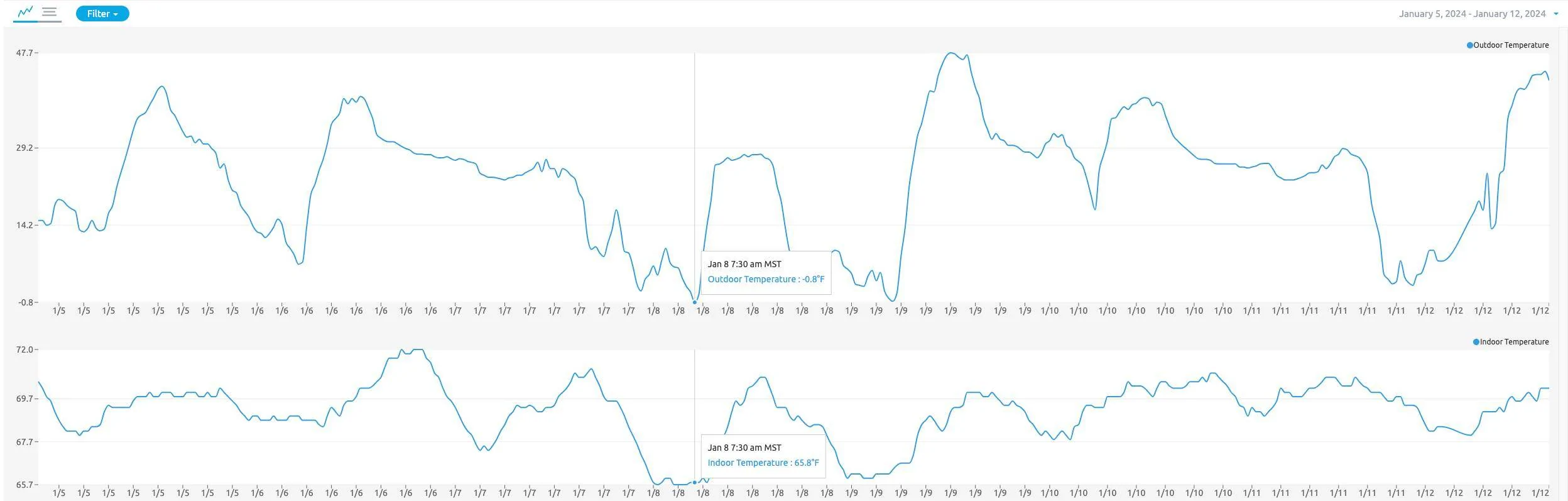

My heat pump doesn't even run aux heat on defrost cycle. It's also our cooler, so it's programmed to just use some of the heat from the house to defrost the coil. This cools the house down a bit, but it's far less expensive than running aux heat, which I have locked out until/unless the house interior temperature reaches 35 ºF.
These graphs are from the past day and a half from our weather station, with a sensor inside the house and a sensor outside. The temperature in the morning of 8 January dropped below 0 ºF while the interior of the house stayed at ~65 ºF, which is our thermostat setting. The outside temperature dropped to below 0 again in the morning of 9 January. The house insulation isn't enough to keep it at a constant temperature of ~65 degrees, which can be seen in the day-night cycle.

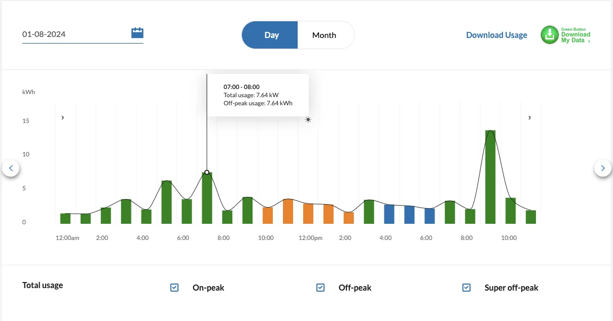

Ford Mustang Mach-E Heat pump in new models? Screenshot 2024-01-12 at 3.21.54 PM
And our energy use did go up a bit during the same 7-8 AM time period, but that's also when we make breakfast (resistive heaters for the coffee machine and stove, and microwave use). The larger spike around 9:00 PM is the Mustang pulling 11 kW to charge and warm up the battery for the night.

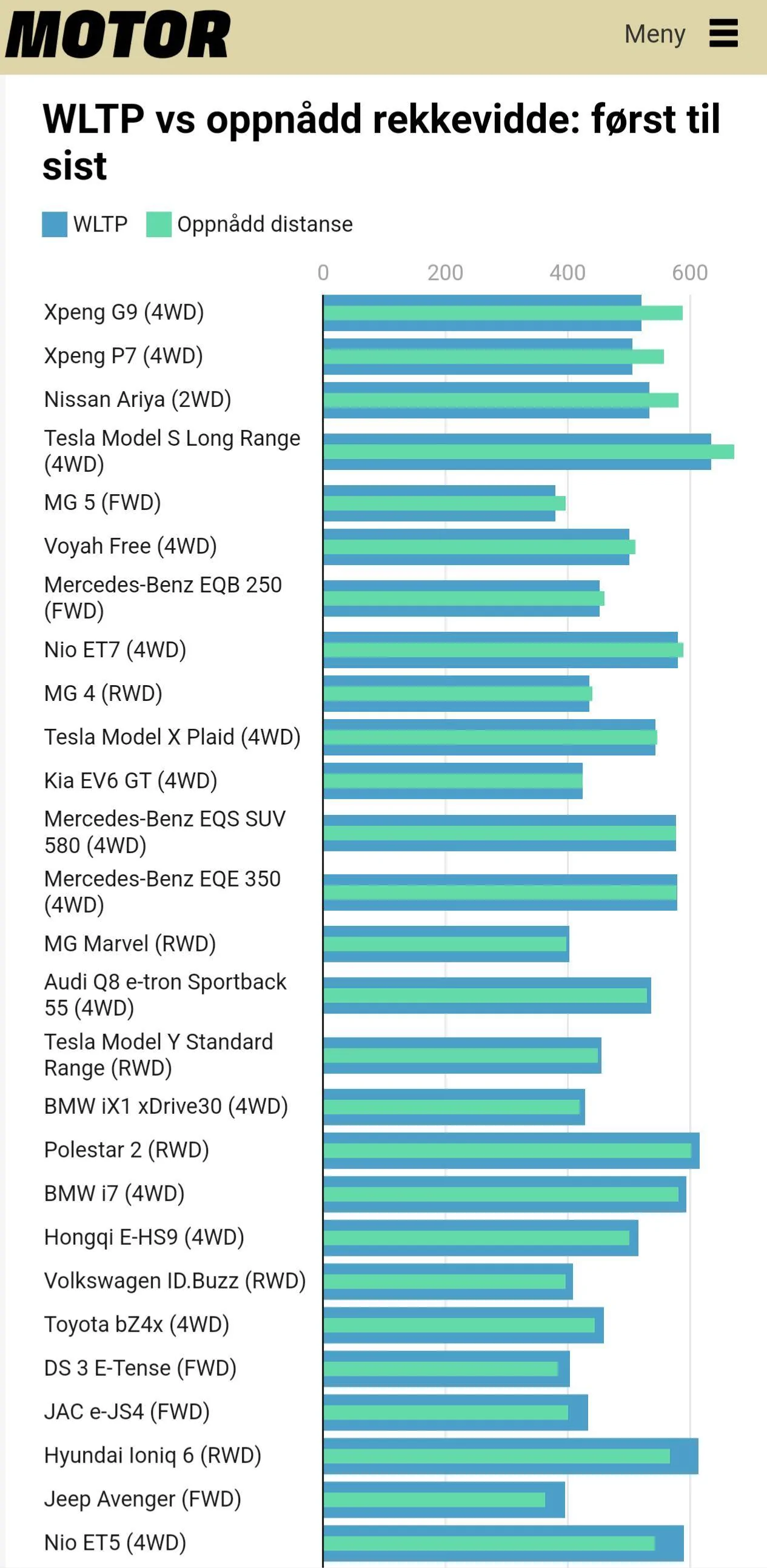

The ranges in Europe are based on the WLTP standard, the US is based on EPA. EPA is optimistic but it could be achieved if you drove the EPA cycle (think slow) The WLTP figures can't really be achieved in the real world. Take 25% off that figure for warm weather range.
WLTP is optimistic - but real world independent testing has achieved WLTP range+ in normal traffic - it's not simulated - but need careful driving - and no stops. Norwegian "summer"?
Also the MME over perform in the same test, but not in the graph under.
Ford Mustang Mach-E Heat pump in new models? 1000004512
Blue is WLTP - green is reached distance.
Speed is an important factor, and Norwegian speed limits are quite low (mostly 80 km/h ≈ 50Mph)
(The summer test was conducted in the first week of June, with temperatures around 20 degrees Celsius in the lowlands and between 10 and 15 degrees Celsius in the mountains.
How we test: We conduct the test with a selection of current cars every six months, winter and summer, on the same route: A loop through Oslo, up Rv4 to Gjøvik, from there E6 up to Hjerkinn, then east and around Rondane over Venabygdsfjellet, down to Ringebu and up E6 again. The cars are driven at the speed limit until they are empty. The drivers, who are all experienced, are required to use regeneration actively and intelligently. They should drive in eco-mode, and refrain from using driver assistance systems, autopilot, and adaptive cruise control.)
The result for MME; (tested 2021)
Mustang Mach-E AWD WLTP 540km - range in test 551,9km
Mustang Mach-E RWD WLTP 610km - range in test 617,9km
For the winter test - the MME get less penalty for the lacking heat pump than other EVs - but cars with heat pump (generally) have less penalty.
