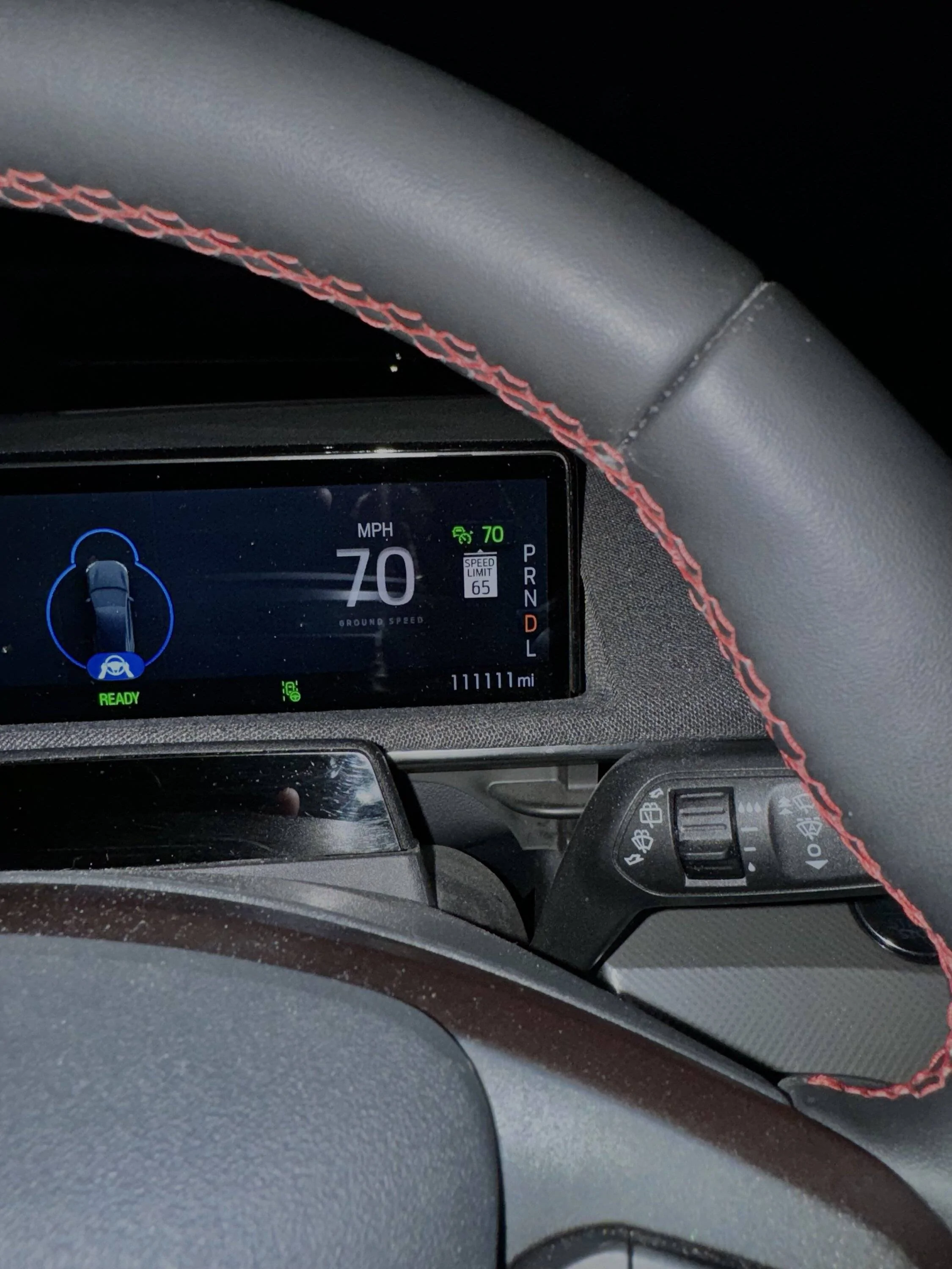

Picked up my First Edition Feb. 26, 2021.
2 HVBJB replacements. One at 54,642 the second one at 94,362.
Battery SOH is at 91%
Interesting that they drop the tenths at 100k. Harkens back to the original display so many of us probably remember.
