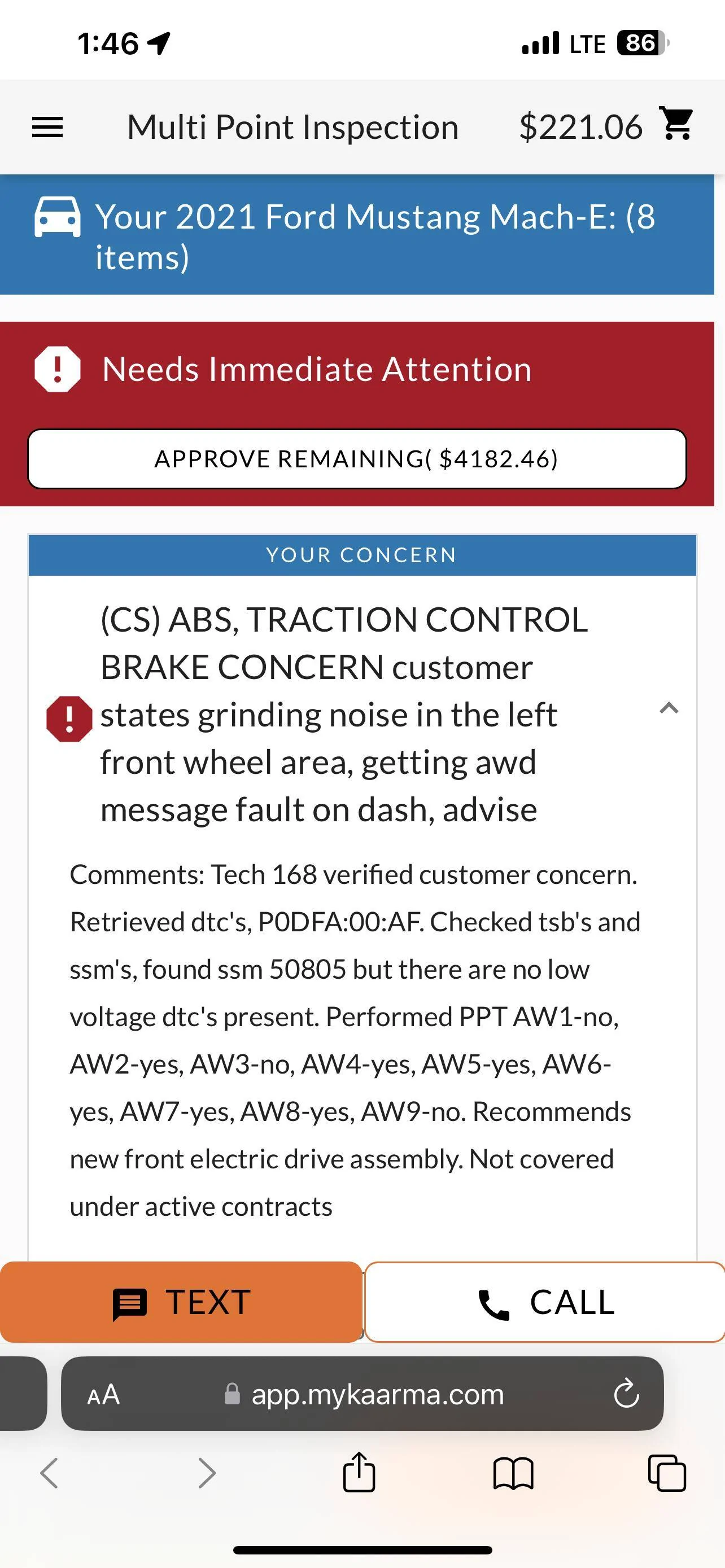

Yes, I was driving home and the car started to try and stop itself while driving. That’s when all of the lights started firing. I just thought the HBJVB needed to be replaced again since I’ve only had one in 103,000 miles. Once it was taken in, I got an alert from the dealership saying a $4100 part needed to be approved. I just figured it was a mistake but it is not.
These are the alerts when it happened

I am wondering. Have you had to replace or has anyone had to replace the front electric drive assembly? I currently have 103,000 miles on my Mach-E 2021 Premium Ext Range and the cost to replace is $4100.00.
I did, at about 47k miles. Its cooling fluids penetrated across its internal seals. Same IPC alerts. AWD Extended battery. Replaced under warranty in November 2023.
How many
I believe I read your report, you got the rear oil flushed at your expense right? My dilemma is, my car is just outside the Powertrain warranty and Ford is not willing to cover anything because of that. I’m worried about the rear failing as well.
