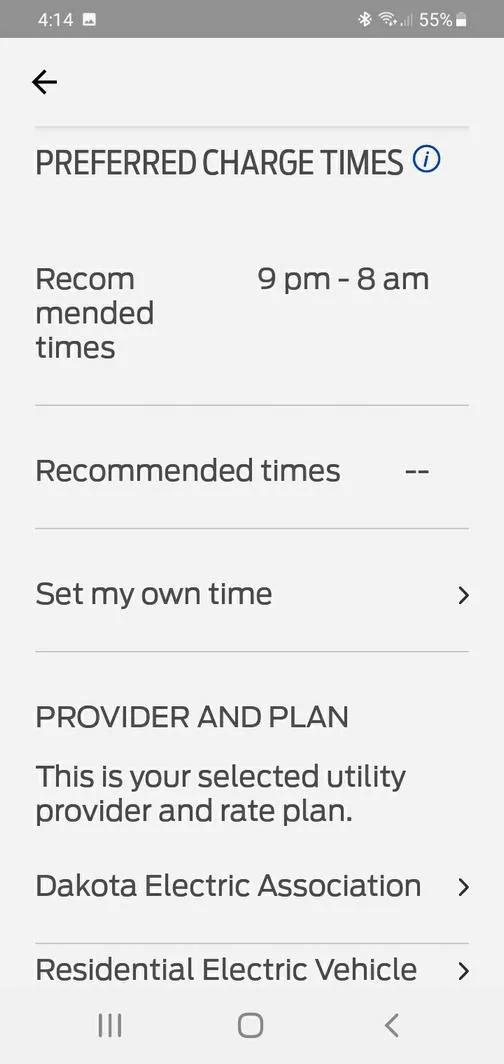

I'm curious, can you show a screen shot of your preferred charging times?
worachj

What does it look like when you click on 'Set my own time'?
When i first got mine, FP didn't have my provider's plan so I just had to manually do it. So mine looks like this.
I've tried it both ways. I set my own time, and now tried using the recommended time from my electric company. Same results.
