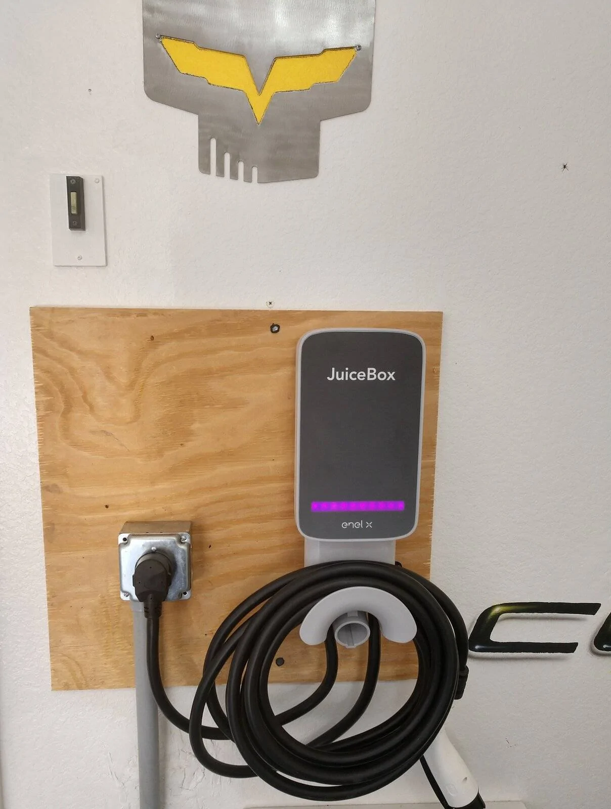

You know what that hole under the cable reel is for - right?
Yep...this was right after electrician finished. But thanks for noticing.
