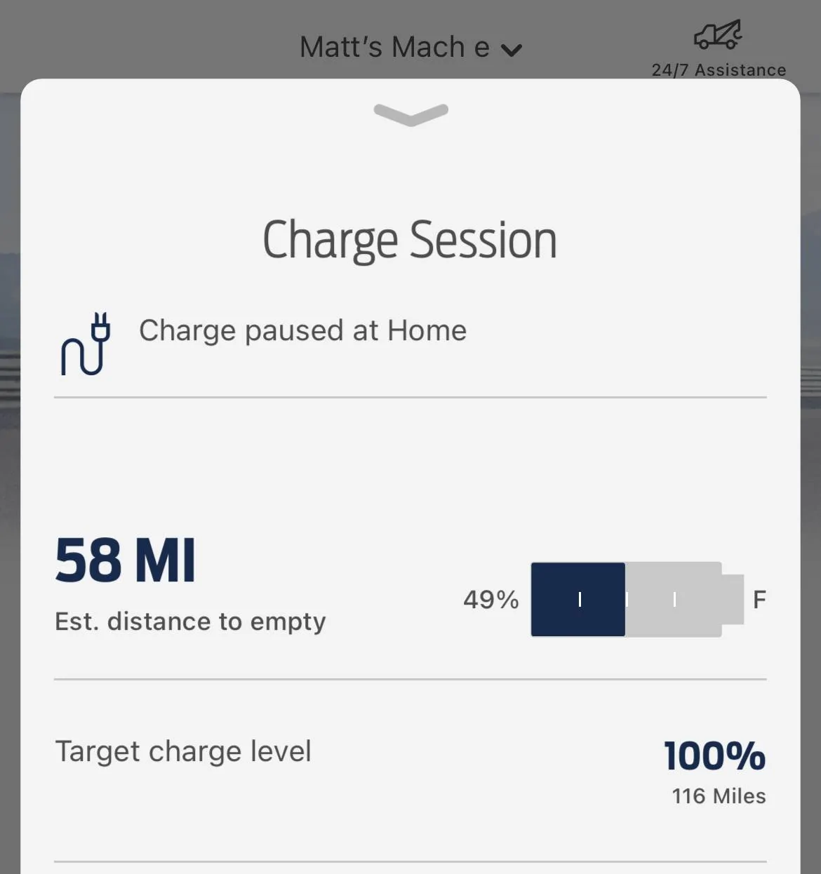

Not sure what to say spent $63,000 on a car that is not even close in range. Don’t understand how Ford can advertise 270 I can’t even get 170. I know it’s cold out. Car sits in a heated garage at night what else can a guy do?
