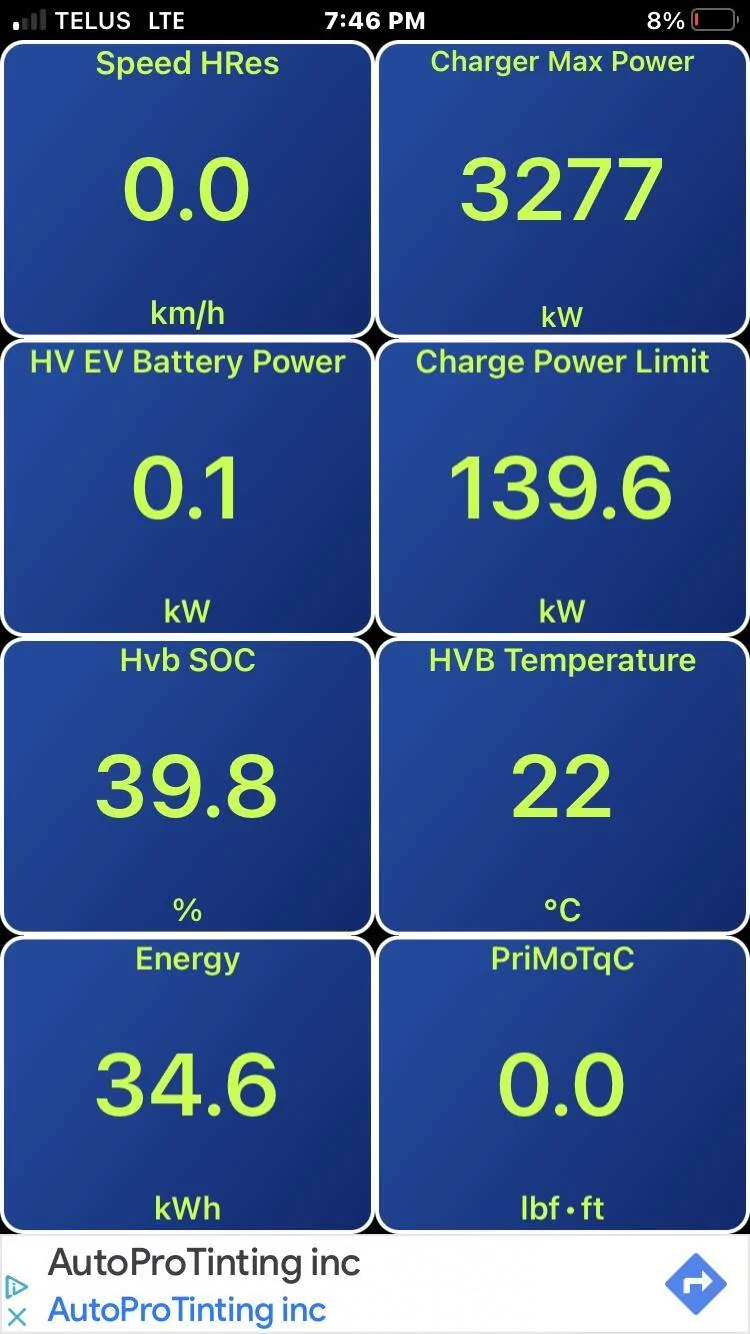

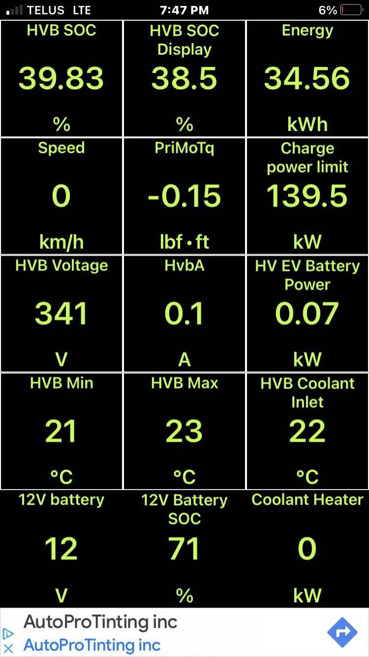

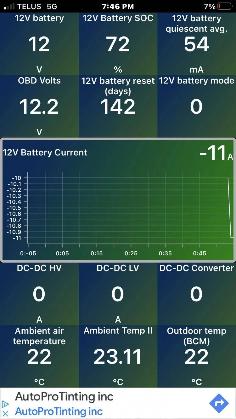

**OBD READINGS JUST TAKEN IN SLEEP MODE**
My vehicle is brand new; only 6 weeks old. It has switched to Deep Sleep Mode for a fourth day in a row now and counting. Nothing has changed. I use Level II charging. My cars SOC is currently 38% and it switched to DSM after only sitting 2 hours. I never allow the vehicles SOC to drop too low nor do I charge past 90% ever. Not sure what the issue is. Disappointing.

What is your 12V quiescent average? That’s a parameter in there. 12V is at 71%, not low enough to trigger deep sleep unless the BMS isn’t getting a proper read on the SoC.

I will check that… Ty

You must be collecting data with the car off because the battery is draining with -11A. That alone will cause the 12V to drain and possibly go into deep sleep FYI (stop data collection when you're done and unplug the OBD device). The quiescent average of 54 mA is a little high, but nothing abnormal. 12V voltage and SoC seem normal. Therefore I think the following SSM applies to you:
https://www.macheforum.com/site/thr...e-deep-sleep-notifications-in-fordpass.26835/

You are correct, the car was off when I collected the Donna. Also, I have been leaving my OBD plugged in but not connected to the Bluetooth on my phone that I am aware of. Do you think this could also possibly cause issue. I have unplug the OBD now, and put it back in its case.

Possibly, try leaving it unplugged for a night and see what happens. Unplug any Dashcams or the like too for the night to see if that helps.
