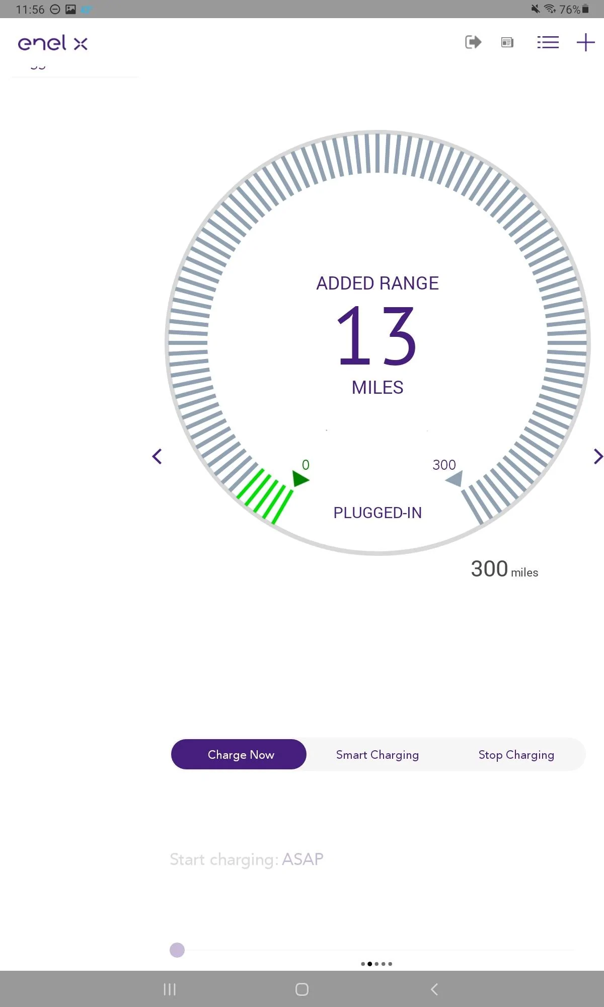

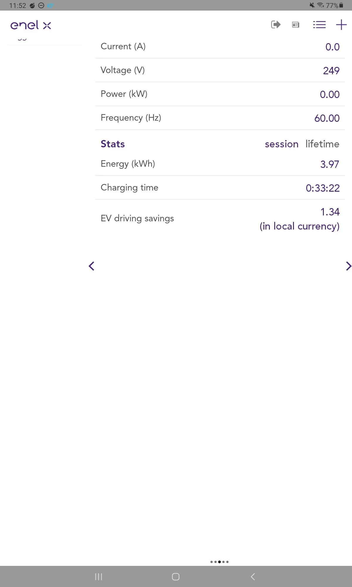

Juicenet can't show charging if it isn't charging. If it shows amps going out....
Current would be >0
Ford Mustang Mach-E Sleep Mode Screenshot_20220414-235252_EV JuiceNet
Current would be >0
Yes that’s exactly what it showed on the screen you have above Which is the third screen on their app, I believe.
The first screen showed it as charging which it wasn’t

Cannot.
Ford Mustang Mach-E Sleep Mode Screenshot_20220414-235612_EV JuiceNet
