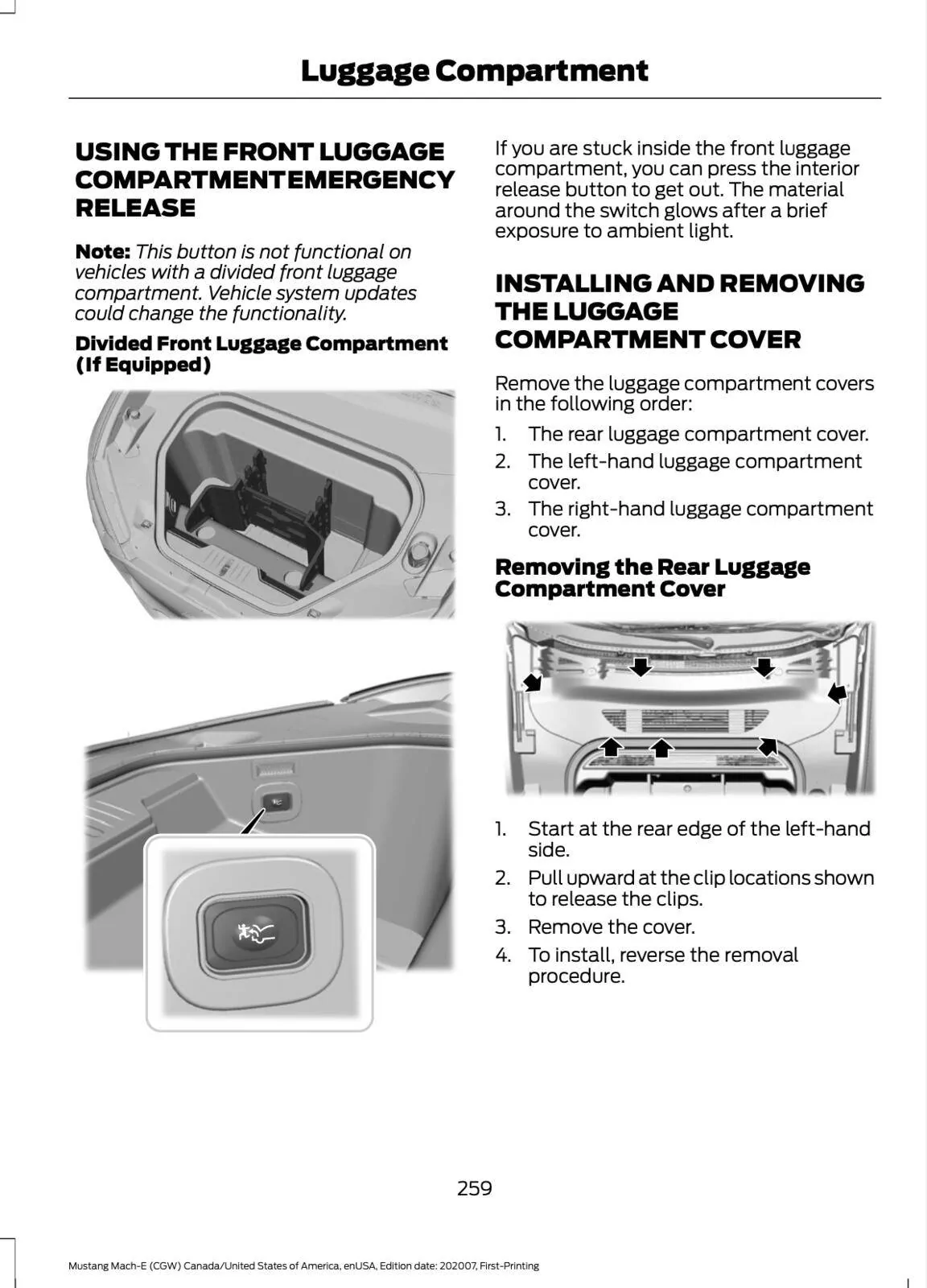

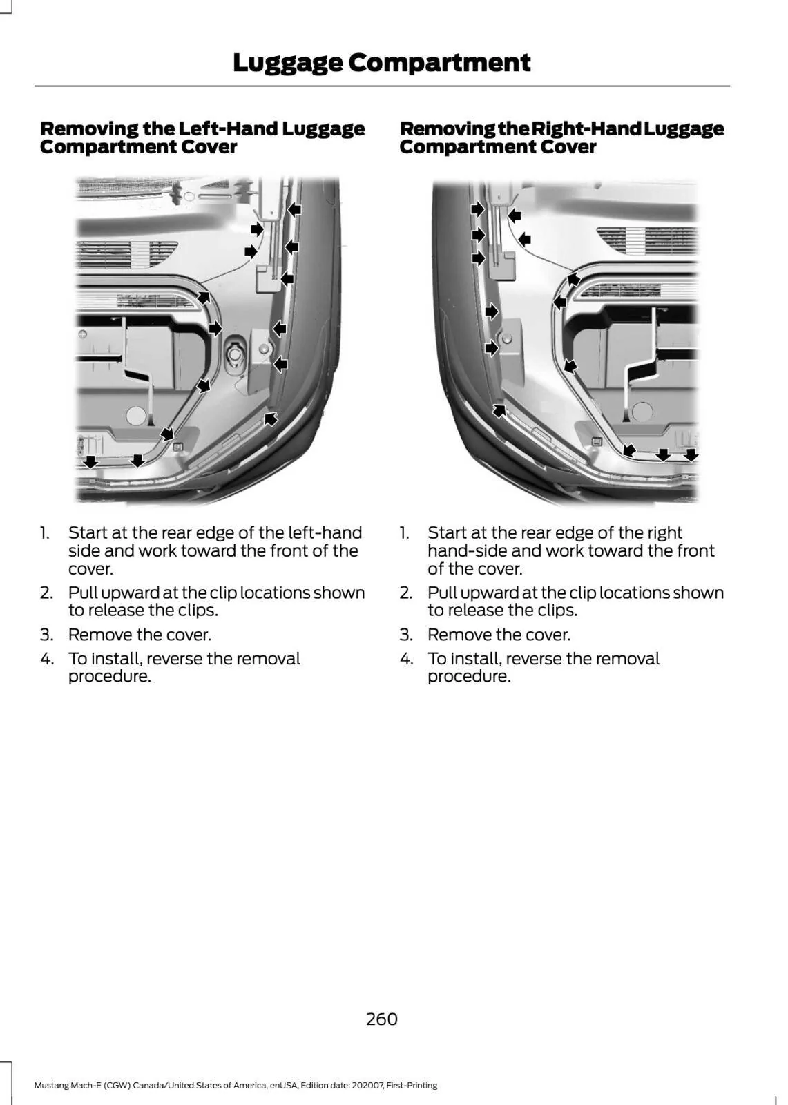

For jumping you only need to remove the rear and left luggage compartment covers. Trim tools help.
Ford Mustang Mach-E Deep Sleep Mode - 12v battery drained dead [update: Mach-E jump started] Screen Shot 2021-05-04 at 4.55.20 PM
Ford Mustang Mach-E Deep Sleep Mode - 12v battery drained dead [update: Mach-E jump started] Screen Shot 2021-05-04 at 4.55.28 PM
I purchased the plastic trim tools but have never used them. To remove the two covers I assume you pry the the cover at the point in the diagram that shows a clip. Is it just a leverage type of motion to lift the cover and dislodge the clip? The kit has a tool that looks like it could pry something.

So I looked up trim tools on Amazon and saw MANY, including sets of hundreds of trim tools. Can anyone tell me what tool is actually useful for taking out the two trim panels needed to access the MME 12v battery? TIA!
smp
Stephen
Apr 28, 2021
137
216
Bedford, NH
Mustang Mach-E First Edition
I believe it's just supposed to be your hands?
To me, that's what it seems to say in the manual.
