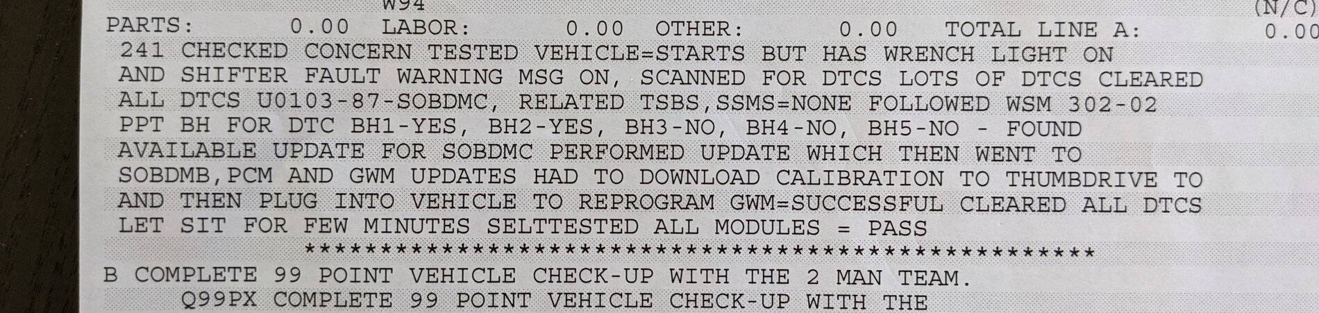

Just got it back from the dealer. Some software updates were performed. We'll see if they fix it. Posting the notes in case it helps anyone.
Since we got it back the connectivity services aren't working though. One step forward, one step back.

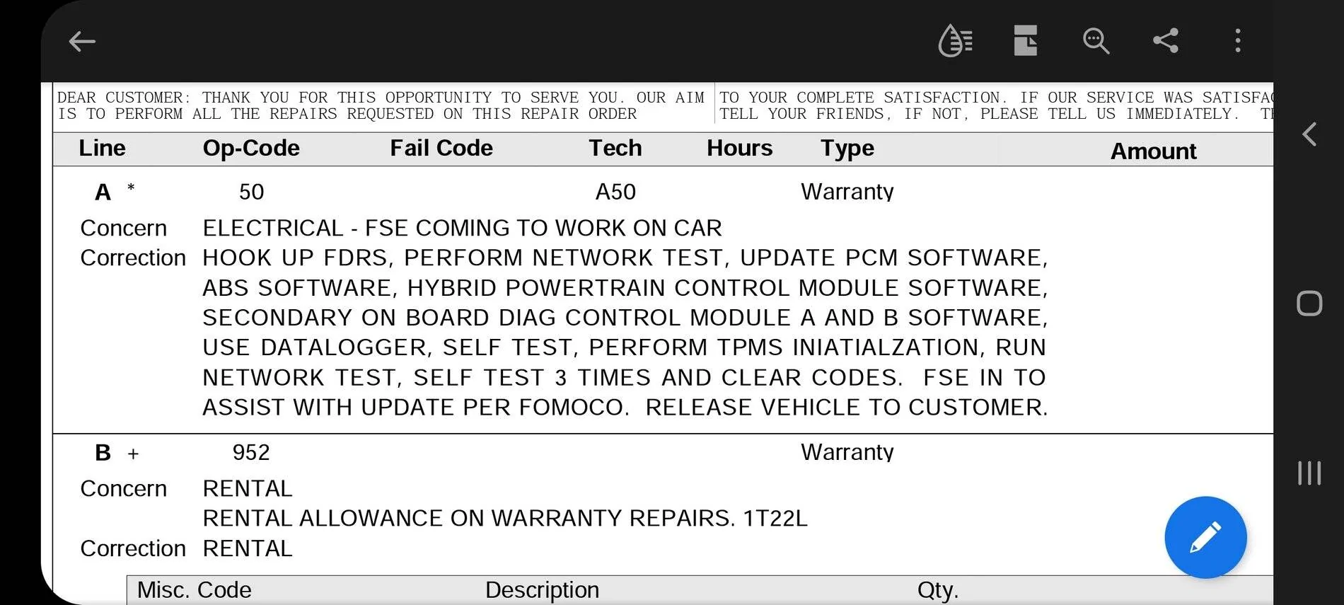

Update 5: Ford sent an engineer to my dealership and they updated the following:

The powertrain light that popped when looking in the manual on page 150 is under the the "high voltage battery" header. Wonder if it wasn't charging the 12v enough. My vehicle was built Jan 9. Did not go to speedway. It had religiously been on the charger every night since I got it Wednesday due to the extreme cold Temps. Outside it has been lows of -22 with a high of 0 for Saturday into Sunday and now Monday. I also had it precondition before I'd go anywhere while still plugged in. It's 22 above in my garage.
