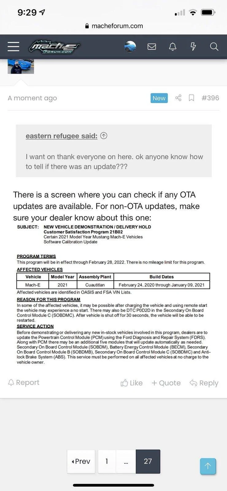

Look at the screenshot below. That technical service bulletin 21B02 is likely what is wrong with your car. It has nothing to do with leaving the fob in and everything to do with it having been left on the charger, because the car tells you to do it but there's a bug that causes the LVB to discharge when it is. However, the problem I am having is that my VIN is not associated with that TSB, which is why it didn't get that software version at the dealership before delivery. Yours probably isn't either. That makes it complicated because even if the dealer checks and finds that there is a software update for that module generally, and even if they have access to that update if it's not showing as being applicable to your VIN, without your VIN being shown as affected they don't know how to bill it for a warranty repair.
Mine is with a dealer now investigating the problem. I'll let you know how it goes but likely it's going to end up with them calling a zone rep or a field service technician for help (which will, in fact, probably solve the problem). And likely that will result in one or both of them realizing that this TSB isn't covering the full set of VINs. But Ford should already have plenty of evidence showing this from the first and second and so on time that cars with VINs on that list showed up with the problem, so my cynical mind is assuming that if they expand it too much it will force them into, or at least look like, the dreaded "r" word.
Or, worse: they could realize that in fact there is a _different_ problem that hasn't been solved yet. But those on this thread that have gotten the software update from that TSB have reported that it fixed the problem.

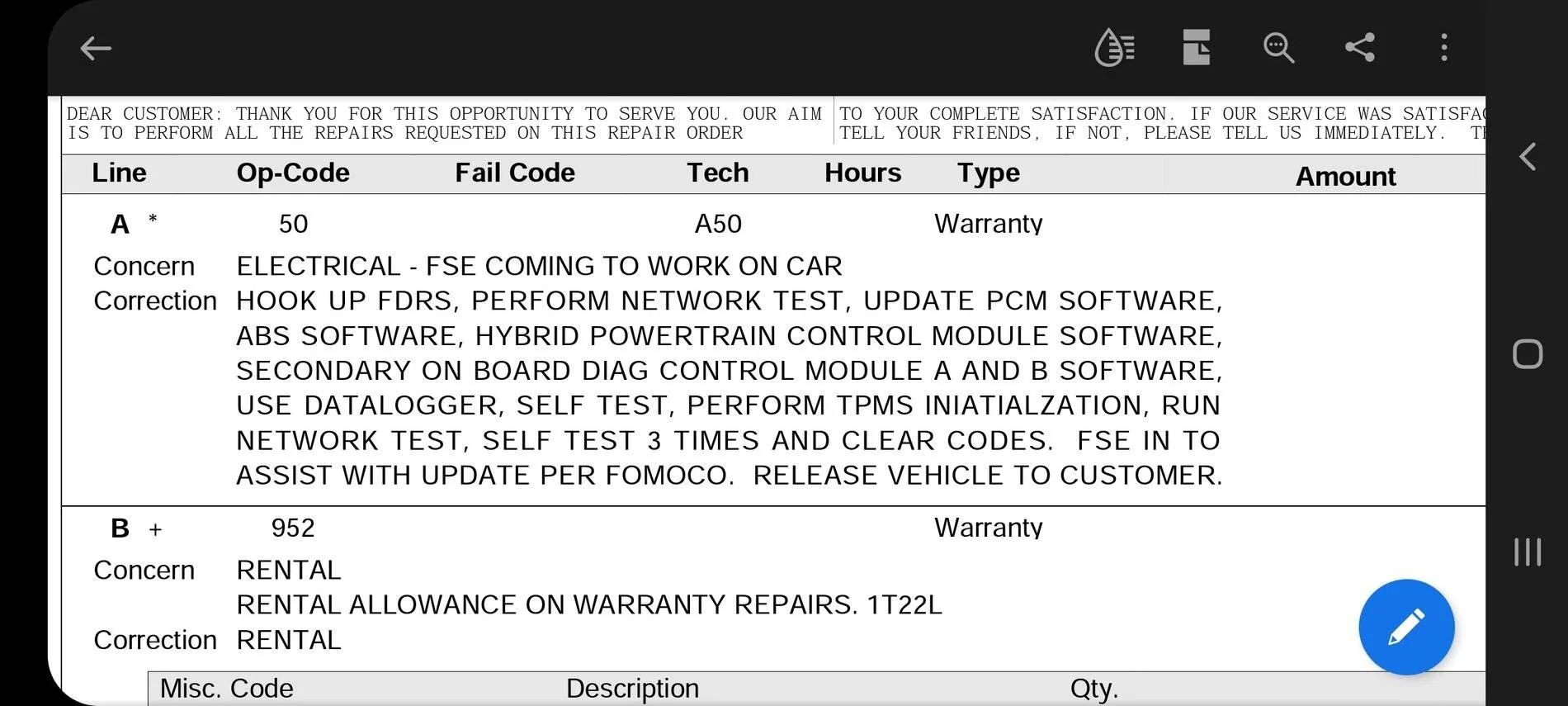

I was the thread starter...a Ford Service Engineer went to my dealership and spent three hours in the car connected with his computer attached longer updating the below modules. Hope it helps.
That's super duper helpful in the abstract. Right now my dealer has no interest in the information I'm trying to bring them from forum posts. But maybe this will convince them to just get an FSE in...
