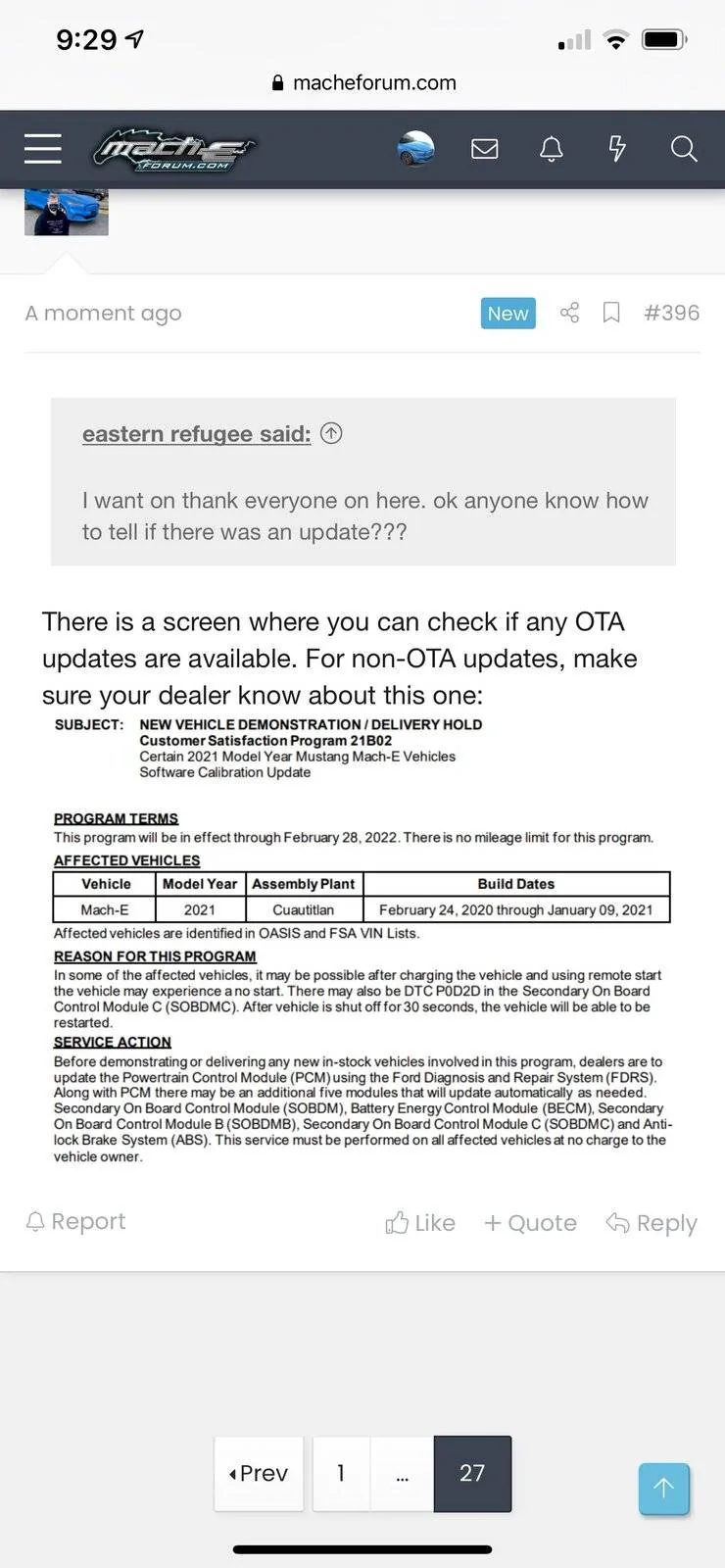

Ford Mustang Mach-E Deep Sleep Mode - 12v battery drained dead [update: Mach-E jump started] 8D74025B-A770-4B7B-AEAC-4B823CA67AEB

Did anyone ever confirm (or at least find support) that this TSB is actually for the LVB drain issue? I'm not doubting you at all, it just feels like the speculation surrounding the stop ship/QC holds earlier this month...some educated guesses, but no hard evidence either way (which I assume we'll never get ☹)
