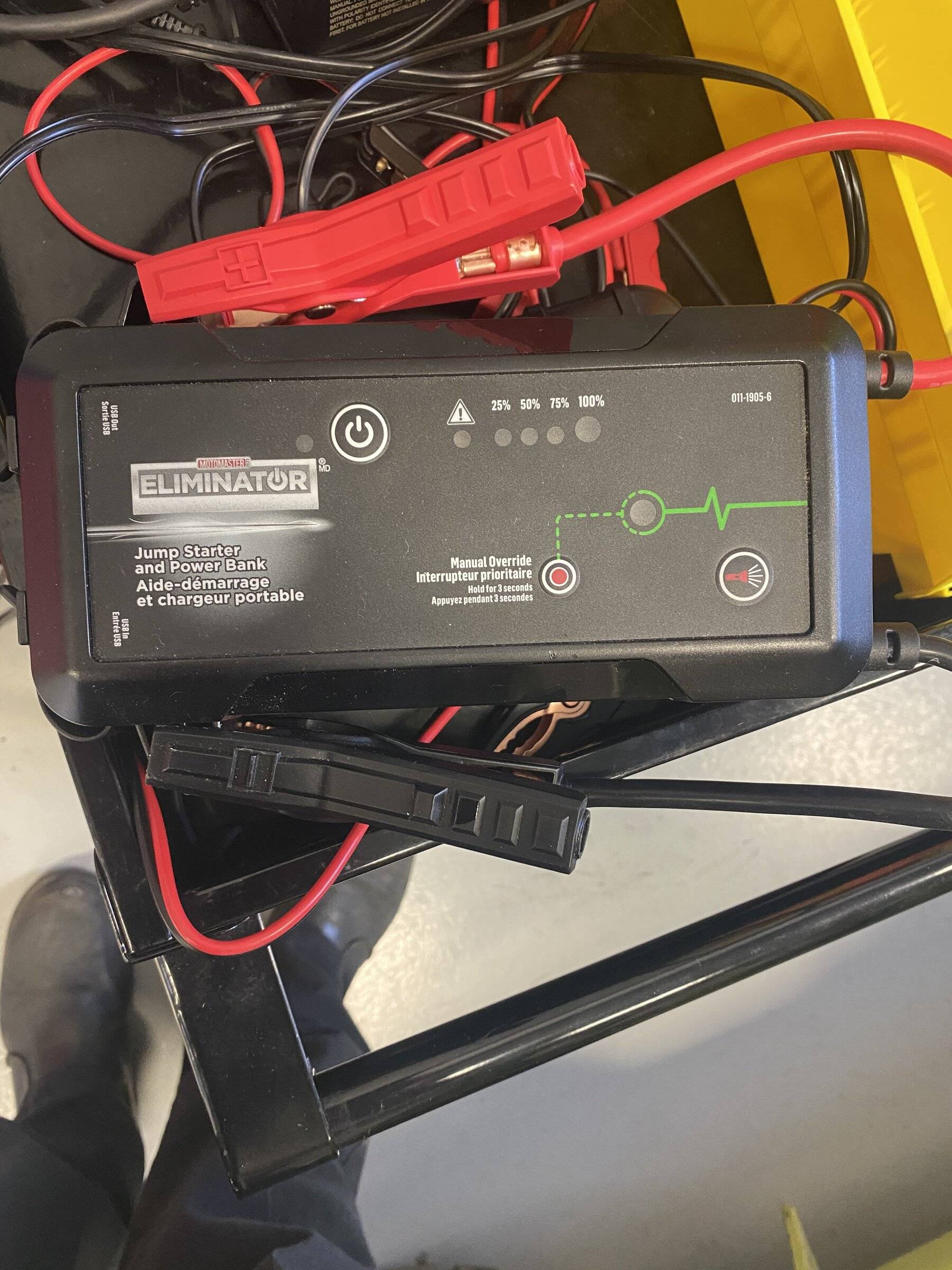

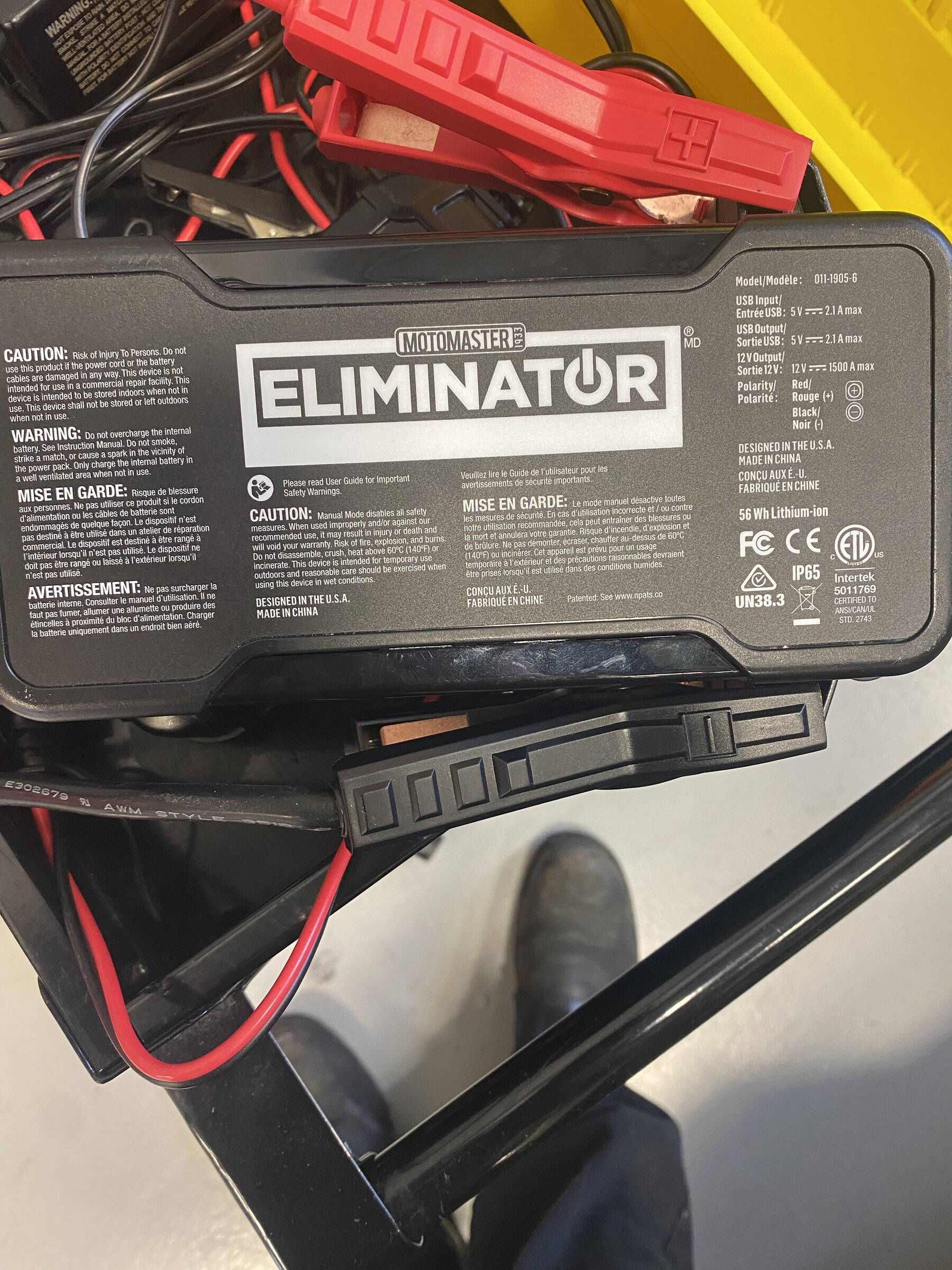

It should be more then enough to wake the vehicle up until the dc/dc charger kicks on. The jump clamps time out after 60sec, after that you need to power cycle the pack. That said it’s probably not worth it. If you leave these jump packs fully charged they only last a few years. Pretty much a waste of money.

I took a photo of a power pack we use at work, to “jump” our old forklift. I don’t see why this wouldn’t at least get you into tow mode.
